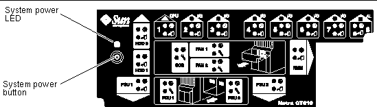

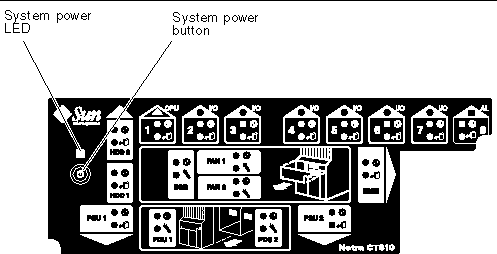

3. Locate the system power button on the system status panel, then press the system power button to power on the server.
FIGURE 2-3 shows the system power button location for the Netra CT 810 server, and FIGURE 2-4 shows the system power button location for the Netra CT 410 server.
4. Verify that the system power LEDs on the system status panel is on, indicating that the system is completely powered on.
FIGURE 2-3 shows the system power LED location for the Netra CT 810 server, and FIGURE 2-4 shows the system power LED location for the Netra CT 410 server.

3. Locate the system power button on the system status panel.
4. Press the system power button and release it to go through a graceful hardware power-down.
This action starts the orderly power-down sequence in such a manner that no persistent OS data structures are corrupted. Applications in service might be terminated and no further services are invoked by the CPU. The system power LED blinks for several seconds, then it goes off.
5. Verify that the green power (
) LEDs on the power supplies are blinking, indicating that the system is in the standby mode.
