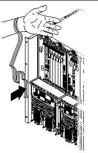

1.2 Attaching the Antistatic Wrist Strap
Most field-replaceable units have sensitive electronic components that require antistatic precautions.
1. Get the antistatic wrist strap and electrostatic discharge mat from the shipping kit.
2. Place the electrostatic discharge mat close to the system.
3. Unwrap the first two folds of the wrist strap and wrap the adhesive side firmly against your wrist.
4. Peel the liner from the copper foil at the opposite end of the wrist strap, and attach the copper end of the strap to a bare metal area on the Netra CT server or on the chassis, as shown in FIGURE 1-1.
FIGURE 1-1 Attaching the Antistatic Wrist Strap
