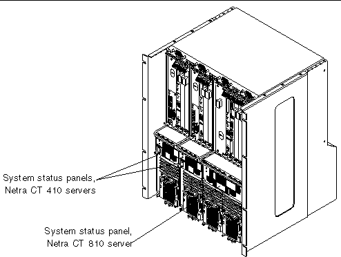

4.1.1 Locating and Understanding the System Status Panel
The system status panel on the Netra CT server give the majority of troubleshooting information that you need for your server. FIGURE 4-1 shows the locations of the system status panels on the Netra CT servers. FIGURE 4-2 shows the system status panel for the Netra CT 810 server, and FIGURE 4-3 shows the system status panel for the Netra CT 410 server.
FIGURE 4-1 System Status Panel Locations

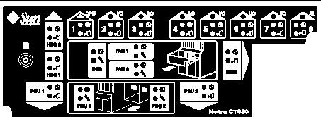

FIGURE 4-2 System Status Panel (Netra CT 810 Server)

4.1.2 Using the System Status Panel LEDs to Troubleshoot the System
When you first power-on the Netra CT server, some or all of the green Power LEDs on the system status panel flash on and off for several seconds. Do not attempt to troubleshoot the system until after the LEDs have gone through their initial power-on testing.
Each major component in the Netra CT 810 server and Netra CT 410 server has a set of LEDs on the system status panel that gives the status on that component. Each component has either green Power and amber Okay to Remove LEDs (FIGURE 4-4) or green Power and amber Fault LEDs (FIGURE 4-5).
FIGURE 4-4 Power and Okay to Remove LEDs
FIGURE 4-5 Power and Fault LEDs
TABLE 4-1 lists the LEDs for each component in the Netra CT 810 server, and TABLE 4-2 lists the LEDs for each component in the Netra CT 410 server. Note that the boards in the Netra CT servers all have the green Power LED, and they have either the amber Okay to Remove LED or the amber Fault LED, not both.
TABLE 4-1 System Status Panel LEDs for the Netra CT 810 Server
