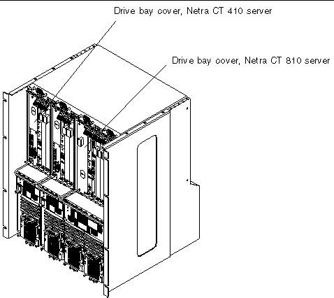

3. Locate the drive bay cover on your system.
The hard drives are behind the drive bay cover on your system. A maximum of two hard drives are behind the drive bay cover in a Netra CT 810 server, and only one is behind the drive bay cover in a Netra CT 410 server.
4. Loosen the captive screws that hold the drive bay cover in place.
5. Remove the drive bay cover.

11. Secure the drive bay cover over the drive baysFIGURE 10-1 (FIGURE 10-2).
You must install the drive bay cover over the drive bays to ensure proper airflow in the system.

2. Remove the drive bay cover (FIGURE 10-1).

7. Replace the drive bay cover.

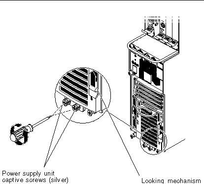

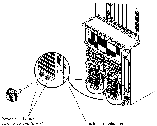

FIGURE 10-2 shows the location of the locking mechanism for the power supply unit on a Netra CT 810 server, and FIGURE 10-3 shows the location of the locking mechanism for the power supply unit on a Netra CT 410 server. The two LEDs on the power supply unit should go OFF.
4. Using a No. 2 Phillips screwdriver, loosen the two silver captive screws at the base of the system.
FIGURE 10-2 shows the location of the captive screws for the power supply unit on a Netra CT 810 server, and FIGURE 10-3 shows the location of the captive screws for the power supply unit on a Netra CT 410 server.

2. Slide the power supply unit into the slot.
3. Using a No. 2 Phillips screwdriver, tighten the two black captive screws to secure the power supply unit to the server.
4. Push the power supply unit locking mechanism(s) down into the locked (
) position.
FIGURE 10-2 shows the location of the locking mechanisms for the power supply unit on a Netra CT 810 server, and FIGURE 10-3 shows the location of the locking mechanisms for the power supply unit on a Netra CT 410 server. The green LED on the power supply unit should start flashing at this point, indicating that the power supply unit is powered on and functioning properly, but the server is still powered off.
