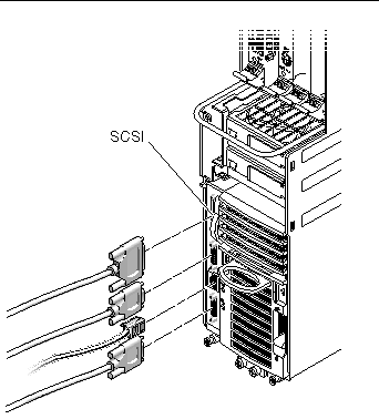

- If you have a front-access model Netra CT 410 server, the SCSI port is located on the host CPU front transition card to the left of the power supply (FIGURE A-1).
FIGURE A-1 Locating the SCSI Port on the Host CPU Front Transition Card (Netra CT 410 Server)

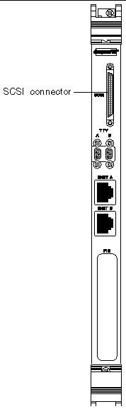

- If you have a rear-access model of either the Netra CT 810 server or the Netra CT 410 server, the SCSI port is located on the host CPU rear transition card installed at the rear of the chassis in I/O slot 1 for the Netra CT 810 server or I/O slot 3 for the Netra CT 410 server. FIGURE A-2 shows the locations of the connectors on the host CPU rear transition card. The host CPU rear transition card is the same for both the Netra CT 810 server and the Netra CT 410 server; only the location in the rear card cage differs.
FIGURE A-2 SCSI Connector on the CPU Rear Transition Card

- If you are connecting an external SCSI device to the host CPU front transition card for the Netra CT 410 server or the host CPU rear transition card for either Netra CT server, connect the VHDC side of the VHDC-to-SCSI 3 adapter cable to the SCSI port on the transition card (see FIGURE A-1 or FIGURE A-2).
