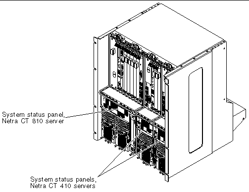

2. Locate the system status panel.
The location of the system status panel in the Netra CT 810 server and Netra CT 410 server is illustrated in FIGURE 7-2.

2. Go to the front of the Netra CT server and locate the system status panel.
The location of the system status panels in the Netra CT 810 server and Netra CT 410 server is illustrated in FIGURE 7-2.
