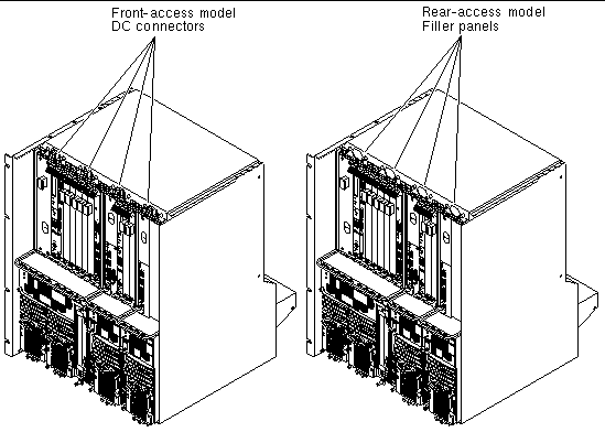

The Netra CT chassis and the servers within the chassis come in two models:
- Front-access model--designed so that all the cables to the CompactPCI cards are connected from the front of the chassis. This model is used in areas where the rack is positioned in a room in such a way that the rear of the chassis is inaccessible.
- Rear-access model--designed so that all the cables to the CompactPCI cards are connected from the rear of the chassis. This model is used in areas where the rack is positioned in a room in such a way that both the front and the rear of the chassis is accessible.
Note - The AC-powered chassis and servers are available only as rear-access models.
Determining If You Have a Front-Access or Rear-Access Model
If you are not sure whether you have a front-access or a rear-access model, go to the front of the chassis and look at the top part of the chassis.
- If you see the DC connectors at the front of the chassis, you have a front-access model (FIGURE 2-1).
- If you do not see DC connectors at the front of the chassis, and metal filler plates fill the gaps where the DC connectors would normally be, you have a rear-access model (FIGURE 2-1). The DC connectors are at the rear of the chassis for the rear-access model.
FIGURE 2-1 Front-Access and Rear-Access Models

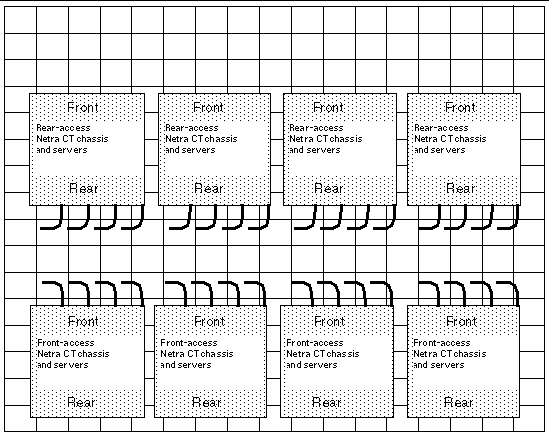

Example of Server Room Layout
FIGURE 2-2 shows an example of a server room layout and how the front-access and rear-access model chassis and servers might be positioned.
FIGURE 2-2 Example of a Server Room Layout

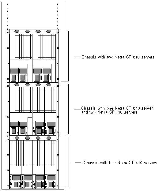

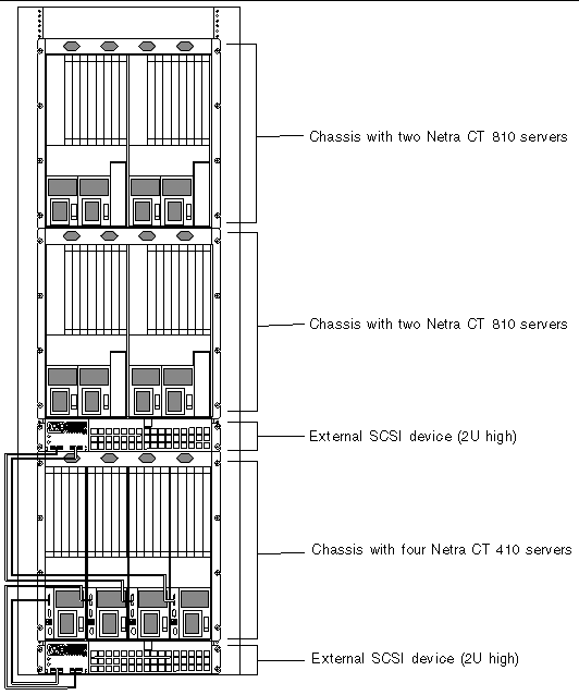

Planning the Rackmounting Configuration
You can mount several Netra CT chassis into a rack, depending on the size and model of the rack. For example, you could install up to three Netra CT chassis in a standard 19-inch rack, with room left over for one or more external SCSI devices, if necessary.
The following figures show how the Netra CT chassis can be installed in a rack, along with supported external SCSI devices. Note that the external SCSI device shown in the figures might be different from the one that you will be using in your configuration.
FIGURE 2-3 Example Configuration 1--Three Chassis, No External SCSI Devices
FIGURE 2-4 Example Configuration 2--Three Chassis, Two External SCSI Devices

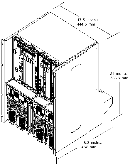

Chassis and Server Physical SpecificationsChassis Physical Specifications
TABLE 2-1 Netra CT Server Chassis Physical Specifications
U.S.
Metric
Width
17.5 inches
444.5 mm
Depth--DC model:
- Default configuration, with rackmount brackets extended as shown in FIGURE 2-5
15.8 inches
400 mm
- With rackmount brackets flush against the bottom of the chassis
13.8 inches
350 mm
Depth--AC model:
- Default configuration, with rackmount brackets extended as shown in FIGURE 2-6
18.3 inches
465 mm
16.3 inches
415 mm
Height
21 inches
533.6 mm
Weight (empty)
74 lbs
33.6 kg
Weight (fully-loaded)
150 lbs
68 kg
FIGURE 2-5 Physical Specifications for the Netra CT Chassis, DC model
FIGURE 2-6 Physical Specifications for the Netra CT Chassis, AC model

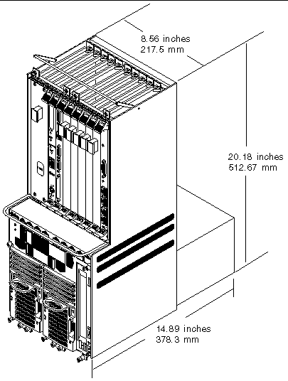

Netra CT 810 Server Physical Specifications
TABLE 2-2 Netra CT 810 Server Physical Specifications
Measure
U.S.
Metric
Width
8.6 inches
217.5 mm
Depth--DC model
15 inches
378.3 mm
Depth--AC model
15.4 inches
391.3 mm
Height
20.2 inches
512.7 mm
Weight, fully-loaded
38 lbs
17.2 kg
FIGURE 2-7 Netra CT 810 Server Physical Specifications

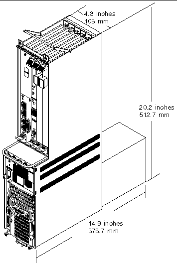

Netra CT 410 Server Physical Specifications
TABLE 2-3 Physical Specifications, Netra CT 410 Server
Measure
English
Metric
Width
4.3 inches
108 mm
Depth--DC model
14.9 inches
378.7 mm
Depth--AC model
15.4 inches
391.7 mm
Height
20.2 inches
512.7 mm
22 lbs
10 kg
FIGURE 2-8 Netra CT 410 Server Physical Specifications

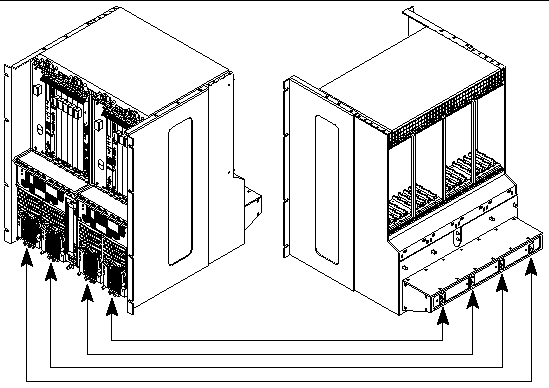

You can disconnect the power for servicing in any of the following ways:
- Unplug the appropriate AC cables from the AC connectors at the rear of the chassis:
- If you want to disconnect power to all of the Netra CT servers in a chassis, unplug the AC cables from all four of the AC connectors at the rear of the chassis.
- If you want disconnect power only to certain Netra CT servers installed in a chassis or to a specific power supply unit in a server, determine which AC connectors at the rear of the chassis supply power to the power supply unit(s) in the Netra CT servers. FIGURE 2-9 shows how to match the AC connectors at the rear of the chassis to the power supply units in the Netra CT servers. Note that if you want to disconnect all power to a Netra CT 810 server, you must determine which AC connectors supply power to the two AC power supply units in the Netra CT 810 server and unplug both of those AC cables from the AC connectors.
- Unplug the appropriate AC cables from the AC power sources.
- Turn off the circuit breakers in the rack where the enclosure is mounted.
FIGURE 2-9 Matching AC Power Supply Units to AC Connectors

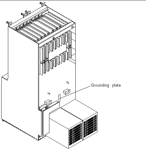

Connecting Logic Ground and Chassis Ground
The Netra CT servers are shipped out of the factory with the logic ground and chassis ground isolated by default. If you want to connect the logic ground and the chassis ground, follow these instructions:
1. Remove the Netra CT server, if you have not done so already.
Refer to To Remove the Servers From the Chassis for those instructions.
2. Go to the rear of the Netra CT server and locate the two M5 threaded studs on the midplane next to the ground symbols.
3. Remove the two screws and install a grounding plate to connect the two studs (FIGURE 2-10).
This connects the logic ground and chassis ground.
FIGURE 2-10 Installing a Grounding Plate

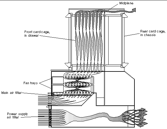

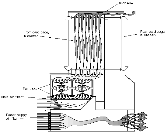

Cooling Requirements
The Netra CT server is cooled by having air drawn in from the front of the system and exhausted out the rear. You must allow 8 inches (203.2 mm) in front and at the back of the server to ensure proper cooling. FIGURE 2-11 shows the airflow for the Netra CT 810 server, and FIGURE 2-12 shows the airflow for the Netra CT 410 server.
FIGURE 2-11 Airflow, Netra CT 810 Server (Side View)
[ D ]
FIGURE 2-12 Airflow, Netra CT 410 Server (Side View)
[ D ]
