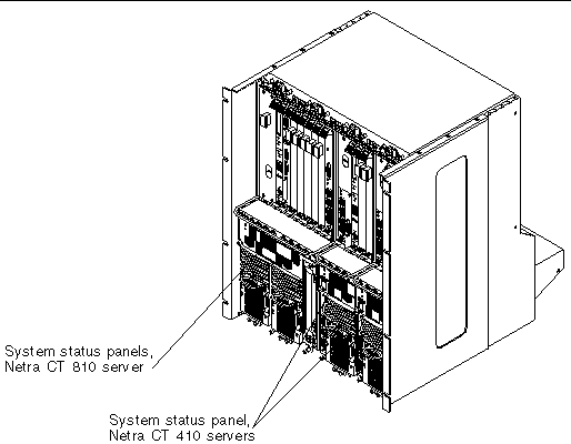

4. Go to the front of the Netra CT server and locate the system status panel.
The location of the system status panel in the Netra CT 810 server and Netra CT 410 server is illustrated in FIGURE 2-1.
FIGURE 2-1 System Status Panel Locations

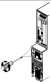

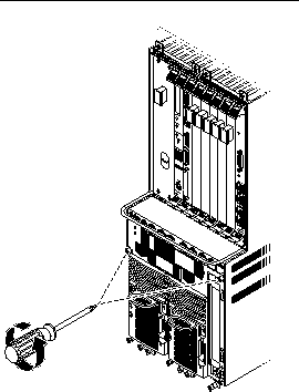

5. Using a No. 2 Phillips screwdriver, loosen the two captive screws that hold the system status panel in place.
FIGURE 2-2 shows the location of the captive screws on the Netra CT 810 server, and FIGURE 2-3 shows the location of the captive screws on the Netra CT 410 server.
FIGURE 2-2 Removing the System Status Panel (Netra CT 810 Server)
FIGURE 2-3 Removing the System Status Panel (Netra CT 410 Server)

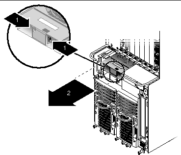

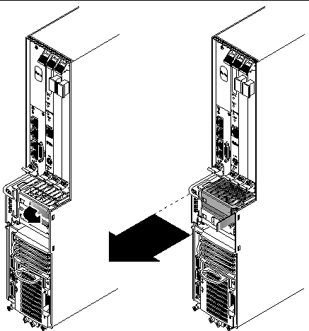

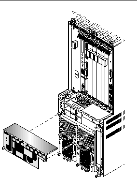

7. Remove the fan tray from the system.
FIGURE 2-4 Removing a Fan Tray from a Netra CT 810 Server
FIGURE 2-5 Removing a Fan Tray from a Netra CT 410 Server

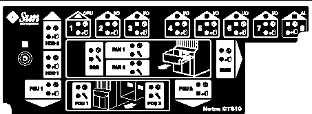

5. Verify that the fan tray LEDs are lit properly.
FIGURE 2-8 shows the locations of the fan tray LEDs on the Netra CT 810 server and FIGURE 2-9 shows the locations of the fan tray LEDs on the Netra CT 410 server.
A fan tray is functioning properly if the amber Fault LED (
FIGURE 2-8 LEDs on the System Status Panel (Netra CT 810 Server)
FIGURE 2-9 LEDs on the System Status Panel (Netra CT 410 Server)

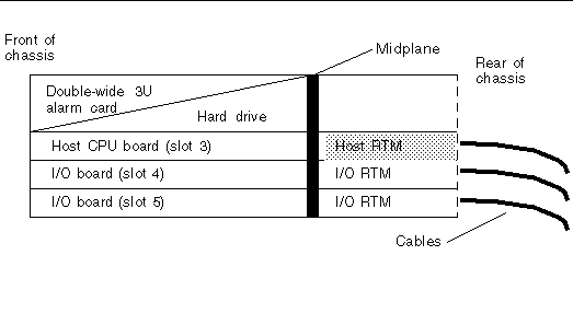

If you are upgrading a host board and one or more satellite boards on the same system, perform the procedures first on the host board, then repeat the procedures for the satellite boards.
Caution - If a Netra CP2140 board is being used as host and not functioning as an I/O board, it cannot be hot-swapped. |
Note - Only remove the existing board at this time; do not install the new board until after you install the new rear transition module. |

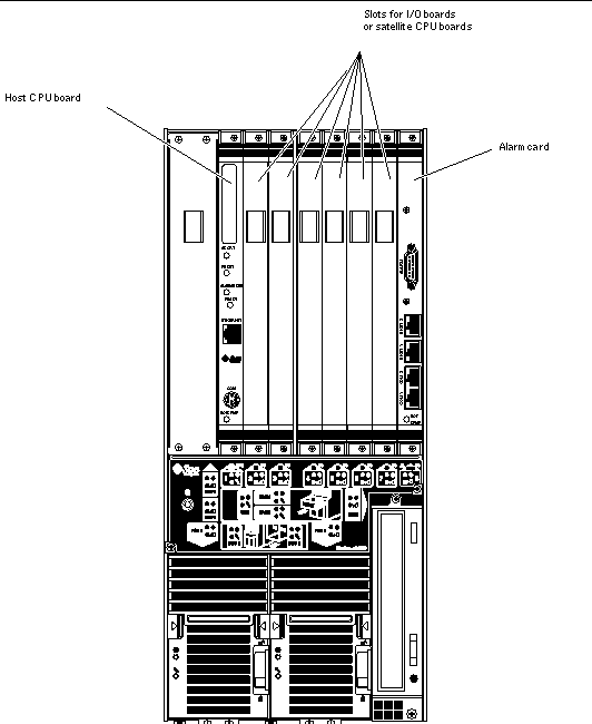

FIGURE 2-10 shows the locations of boards in the Netra CT 810 server. FIGURE 2-11 shows the locations of boards in the Netra CT 410 server.
FIGURE 2-10 Slots for Boards in a Netra CT 810 Server
FIGURE 2-11 Slots for Boards in a Netra CT 410 Server
1. Locate the board that you want to remove from the server.
2. Log in to the Netra CT server.
3. Determine the hot-swap state for the slot that holds the board you are about to remove.
To determine the current hot-swap state for the slots in your server, as superuser, enter:
4. Identify the attachment-point ID that corresponds to the slot where you will be removing the board.
The attachment-point ID is shown in the first column of the readout; for example, the attachment-point ID for slot 4 in a Netra CT 810 server would be IO-4.

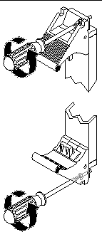

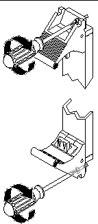

7. Using a No. 2 Phillips screwdriver, loosen the two captive screws inside the board's ejection levers, one on top and one on the bottom (FIGURE 2-12).
FIGURE 2-12 Loosening the Ejection-Lever Captive Screws
8. Unlock the ejection levers.
Caution - Only unlock the ejection levers at this point; do notunseat the board. |

9. Locate the LEDs on the system status panel for the board that you want to remove.
The system status panel on each server has LEDs that show the status of the board installed in each of the slots in the server. FIGURE 2-13 shows the LEDs on the Netra CT 810 server and FIGURE 2-14 shows the LEDs on the Netra CT 410 server.
FIGURE 2-13 LEDs on the System Status Panel (Netra CT 810 Server)
FIGURE 2-14 LEDs on the System Status Panel (Netra CT 410 Server)
10. Determine if you can remove the board safely at this time.
You can remove the board only if all of the LEDs are in the following states:

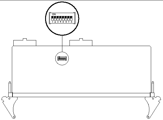

7. If installing an RTM-S, confirm that the dip switch settings are all set to On.

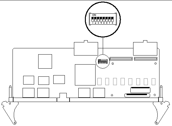

The Netra CP2500 RTM-S module has two DIP switch banks (S1301 and S1302) that control the Ethernet network traffic through the RTM-S module. By default, the switches on these banks are all set to the ON position. In the ON position, all network traffic gets routed out through the module's RJ-45 connectors. When these switches are set to the Off position, all network traffic is routed to the cPSB backplane network.
FIGURE 2-17 shows the location of the S1301 DIP switch bank, which is located on the component side of the RTM-S. FIGURE 2-18 shows the location of the S1302 DIP switch bank, which is located on the solder side of the RTM-S.
Caution - Never set the DIP switches on a Netra CP2500 RTM-H module. Sun does not support changing the RTM-H DIP switches from their default settings. |
FIGURE 2-17 S1301 DIP Switch Bank Location on the RTM-S (Component Side)
FIGURE 2-18 S1302 DIP Switch Bank Location on the RTM-S (Solder Side)

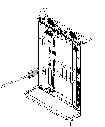

10. Make the necessary cable connections to the rear transition module.
Tighten the screws on the cable to a torque of 0.23 N.m (2 in.-lb).

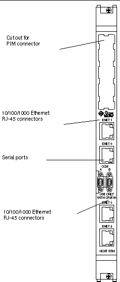

FIGURE 2-20 shows the connectors on the host rear transition module.
FIGURE 2-20 Connectors on the Netra CP2500 Host Rear Transition Module (RTM-H)

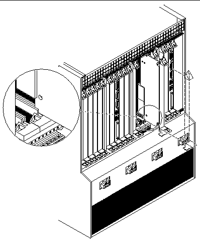

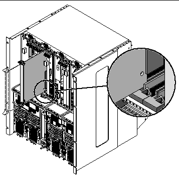

6. Keeping the new board vertical, slide it into the slot between the two guides.
The cuts in the handle of the board must align with the square cutouts in the slot. When the board is completely seated in the cage, the two ejection levers should flip inward, and the notches in the ejection levers should fit smoothly in the rectangular cutouts in the bottom and top plates.
Caution - In the Netra CT 810, do not install Netra CP2500 boards in slots 6 and 7. Increased temperatures might cause a server power down. |
FIGURE 2-21 Aligning the Board with the Board Cage Cutouts
The following figures show the connectors for host boards for Netra CT servers.
FIGURE 2-23 Connectors on the Netra CP2140 Host CPU Board
FIGURE 2-24 Connectors on the Netra CP2500 Host CPU Board

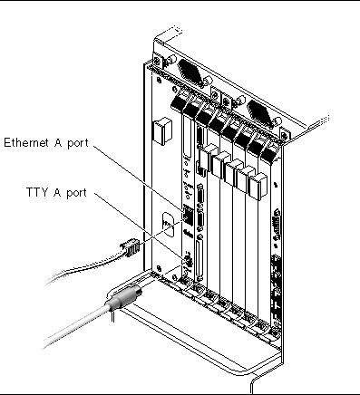

1. Use the tip utility to establish a full-duplex-terminal connection between a Sun workstation and the new board.
2. At the UNIX prompt in a command or shell tool window, enter:
3. Perform the following diagnostic steps.
a. Verify that the following information is accurate:
