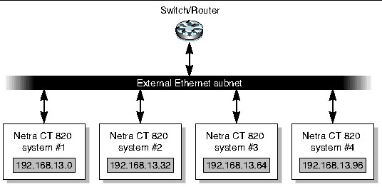

The system management network provides a communication channel over the midplane. It can be used to communicate between the distributed management card, the node boards, and the switching fabric boards. It appears as any other generic Ethernet port in the Solaris operating environment. The system management network is configured by default on Solaris and on the distributed management card. The system management network is used by the applications and features, such as MOH, PMS, and console connections from the distributed management card to node boards.
The IP address of the system management network on the node boards is formed as follows: the midplane FRU ID field SysmgtbusIPSubnet contains the value IP_subnet_address.slot_number. The default IP subnet address is c0a80d00 (192.168.13.00) and the default IP subnet mask is 0xffffffe0 (255.255. 255.224). When you power on the Netra CT server, and if you have not made any changes for the system management network in the midplane FRU ID, the IP address of a board installed in slot 3 will be configured to 192.168.13.3; if you then move that board to slot 4, the IP address for that board will be configured to 192.168.13.4.
The IP address of the system management network on the active distributed management card is always the midplane FRU ID field SysmgtbusIPSubnet value IP_subnet_address.22.
Note - If you configure multiple Netra CT 820 systems in the same subnet, make sure each system has a different system management network IP subnet. |
For example, if your network configuration includes four Netra CT 820 systems connected to one external switch or router, you must configure a different system management network IP subnet for each system; otherwise, applications, such as MOH, will not work correctly. A sample configuration using the 192.168.13 subnet is as follows:
FIGURE 2-1 illustrates this sample configuration.
1. Log in to the active distributed management card.
2. Set the FRU ID for the system management network:
Refer to TABLE 2-1 for allowable information for each variable. You must set both the system management network IP subnet address and the subnet mask in hexadecimal format. For example, to set the subnet address to 192.168.16.00 and the subnet mask to 255.255.255.224, enter the following:
hostname cli> setfru midplane 1 SysmgtbusIPSubnet c0a81000 hostname cli> setfru midplane 1 SysmgtbusSubnetMask ffffffe0 |
3. Completely power off and on the system by locating the power switch at the rear of the Netra CT 820 server; press it to the Off (O) position, then press it to the On (|) position.

You can use the PMS CLI application to enable local node boards to remotely monitor and control node boards in the same system or in other Netra CT systems. One use for this capability is in a high availability environment. For example, if a high availability application fails on a controlled node board, PMS notifies the controlling node board of the failure, and the controlling node board (through a customer application) notifies another controlled node board to start the same high availability application.
The pmsd slotrndaddressadd command is used to configure a local node board to control and monitor another node board by specifying the IP addresses and slot information for the node board to be controlled, using the parameters shown in TABLE 2-5.
Each local node board can control and monitor 16 local or remote node boards. Each local node board being managed must have already had its IP address set using the pmsd slotaddressset command.
1. Log in to the distributed management card.
2. Add the address information with the slotrndaddressadd command:
where -s slot_num is the slot number in the same system of the local node board you want to use to control other local or remote node boards, and all specifies all slots containing node boards in the local system; -n ip_addr is the IP address of the node board to be controlled; -d ip_addr is the IP address of the active distributed management card in the system of the node board to be controlled; and -r slot_num is the slot number of the node board to be controlled.
When you add address information with the slotrndaddressadd command, an index number is automatically assigned to the information. You can see index numbers by using the slotrndaddressshow command and use the index numbers to delete address information with the slotrndaddressdelete command, described below.
The pmsd slotrndaddressdelete -s slot_num|all -i index_num|all command can be used to delete address information from the controlling node board. The -s slot_num|all parameter specifies whether the address information will be deleted on a single slot number or on all slots containing node boards in the local system. The -i index_num|all parameter specifies whether the address information will be deleted for a single address entry or for all address entries; index_num can be 1 to 16. Before using this command, it is advisable to print the current address information using the pmsd slotrndaddressshow command, so you know the index number to use.
The pmsd slotrndaddressshow -s slot_num|all -i index_num|all command can be used to print address information. The -s slot_num|all parameter specifies whether the address information will be printed for a single slot number or for all slots containing node boards in the local system; index_num can be 1 to 16. The -i index_num|all parameter specifies whether the address information will be printed for a single address entry or for all address entries.
