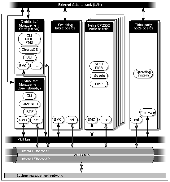

The software is described in TABLE 1-1 and represented logically, with the hardware, in FIGURE 1-1.

Operating Environments and Applications
Solaris operating environment
The Solaris operating environment runs on Sun-supported cPSB-only node boards, such as the Netra CP2300 cPSB board. It is installed by the user.
ChorusOS operating environment
The ChorusOS operating environment runs on the distributed management cards. It is factory-installed.
Command-line Interface (CLI)
The CLI is the primary user interface to the distributed management cards.
Managed Object Hierarchy (MOH)
Management application that monitors and manages the field-replaceable units (FRUs) in your system. It provides support for high-availability services and applications.
Processor Management Service (PMS)
Management application that provides support for high-availability services and applications.
Firmware
OpenBoot PROM firmware
Firmware on a Sun-supported cPSB-only node board, such as the Netra CP2300 cPSB board, that controls booting. It includes diagnostics.
Boot control firmware (BCF)
Firmware on the distributed management cards that performs power-on self-test (POST) and controls booting of the distributed management card software.
Baseboard Management Controller (BMC) firmware
Baseboard Management Controller firmware enables communication over the Intelligent Platform Management Interface (IPMI) on the distributed management cards.
System Management Controller (SMC) firmware
System Management Controller firmware enables communication over the IPMI controller on a Sun-supported cPSB-only node board, such as the Netra CP2300 cPSB board.
Network Interfaces
Internal Ethernet networks
The two internal Ethernet networks make up the compact packet-switched backplane (cPSB) bus.
System management network
The system management network is a communication channel over the cPSB bus. It is used by the Netra CT 820 management software to communicate between the distributed management cards, Sun-supported cPSB-only node boards, such as the Netra CP2300 cPSB board, and the switching fabric boards.
The Netra CT 820 system has two distributed management cards. You use the top, active, distributed management card (slot 1A) for system-level configuration, administration, and management of most of the components connected to the midplane. The bottom, standby, distributed management card (slot 1B) provides a backup for hot-swap signals so that the active distributed management card can be removed without impact to the power for the slots; it cannot be used for configuring, administering, or managing other boards.
The switching fabric boards connect the distributed management card and the node boards internally, and have Ethernet ports on the rear for external connectivity.
Sun-supported cPSB-only node boards, such as the Netra CP2300 cPSB board, accept and own peripherals, such as disks; they also run user applications. In a Netra CT 820 server, each node board runs its own copy of an operating system, and each is therefore considered a server; the distributed management cards, the node boards, the switching fabric boards, and the other system FRUs, make up a system.
Note - In this manual, the use of the term "node board" refers to a Sun-supported cPSB-only board, such as the Netra CP2300 cPSB board, unless otherwise specified.
Third-party cPSB-only node boards that are PICMG 2.16-compliant may be used in the Netra CT 820 server. These boards do not necessarily run the Solaris Operating Environment, and they do not run the Netra CT 820 server system management software, such as MOH. Because of this, they cannot be managed to the same extent as the Netra CP2300 cPSB board. Refer to Appendix A, Third-Party Node Boards for information on these boards.
TABLE 1-2 contains a summary of how you can access the various boards. The distributed management card supports 22 sessions (tip and telnet connections) at once.
TABLE 1-2 Netra CT 820 System Board Access Methods
Board
Access Methods
Distributed Management Card (active [slot 1A] and standby [slot 1B])
- 1 rear serial port (console) for tip or ASCII terminal connection
- 1 front serial port (console) for tip or ASCII terminal connection
(Note that either the rear or front serial port can be used, but not both at the same time; if you connect a cable to both ports, the front port will be active.)
- 1 rear Ethernet port for telnet connection
Switching Fabric Board (slots 2 and 21)
- Multiple rear Ethernet ports for telnet connection
Node Board (Sun-supported cPSB-only boards) (slots 3 through 20)
For the Netra CP2300 cPSB board:
- 2 rear serial ports (console) for tip or ASCII terminal connection
- Console command from the distributed management card CLI
- Telnet connection through the switching fabric board, specifying the IP address of the node board
Third-party cPSB-only node boards (slots 3 through 20)
Third-party board dependent.
The hardware interfaces include the Intelligent Platform Management Interface (IPMI), the compact packet-switched backplane (cPSB) bus, and the network interface on the distributed management cards, the node boards, and the switching fabric boards.
FIGURE 1-1 Logical Representation of Software and the Hardware Interfaces in a Netra CT Server
