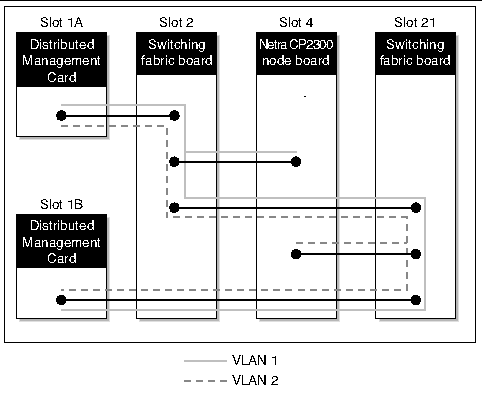

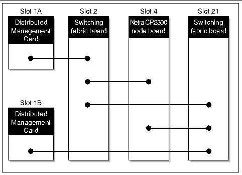

The system management network provides a communication channel over the midplane. It is used to communicate between the distributed management cards, the node boards, and the switching fabric boards. FIGURE 2-1 shows the physical connections between boards over the midplane in the Netra CT 820 system.
The network appears as any other generic Ethernet port in the Solaris Operating System, and is configured by default on Solaris OS and on the distributed management cards. The system management network is used by the applications and features, such as MOH, PMS, and console connections from the distributed management cards to node boards.
The system management network consists of two virtual local area networks (VLANs) running over the two internal Ethernet interfaces, and a logical Carrier Grade Transport Protocol (CGTP) interface. The two VLANs and the logical CGTP interface allow distributed management card and switching fabric board redundancy. FIGURE 2-2 shows the VLAN traffic over the physical connectivity shown in FIGURE 2-1.
On each node board, internal Ethernet ports dmfe33000 (VLAN tag 33) and dmfe44001 (VLAN tag 44) use CGTP to provide redundancy in case of failure of one of the ports or a failure of the switching fabric board connected to one of the ports. The interfaces are configured on each node board using a Solaris startup script. To verify that CGTP is installed on each node board, use the pkginfo command:
System management network traffic on the VLANs must always be contained within the chassis. Do not use VLAN tag 33 or 44.
The IP address of the system management network on the top (slot 1A) distributed management card is always the midplane FRU ID field SysmgtbusIPSubnet value IP_subnet_address.22; for the bottom (slot 1B) distributed management card it is always the midplane FRU ID field SysmgtbusIPSubnet value IP_subnet_address.23. The IP alias address for the system management network on the active distributed management card is the midplane FRU ID field SysmgtbusIPSubnet value IP_subnet_address.25. The IP alias address (the CGTP interface) provides packet redundancy.
The IP address of the system management network on the node boards is formed as follows. The midplane FRU ID field SysmgtbusIPSubnet contains the value IP_subnet_address.slot_number. The default IP subnet address is c0a80d00 (192.168.13.00) and the default IP subnet mask is 0xffffffe0 (255.255. 255.224). When you power on the Netra CT server, and if you have not made any changes for the system management network in the midplane FRU ID, the IP address of a board installed in slot 3 is configured to 192.168.13.3; if you then move that board to slot 4, the IP address for that board is configured to 192.168.13.4.

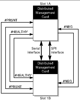

Each distributed management card monitors itself (local monitoring) and the other distributed management card (remote monitoring). During this monitoring, a problem in any of the areas being monitored on the active distributed management card could cause a failover.
A failover always occurs with:
A failover occurs with any of the following events if the setfailover mode is set to on:
FIGURE 2-3 shows the internal hardware signals and interfaces that support distributed management card failover, and TABLE 2-4 describes the signals and interfaces.
