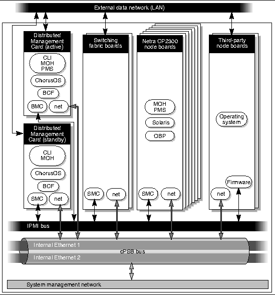

The software is described in TABLE 1-1 and represented logically, with the hardware, in FIGURE 1-1.

The hardware interfaces include the Intelligent Platform Management Interface (IPMI), the compact packet-switched backplane (cPSB) bus, and the network interface on the distributed management cards, the node boards, and the switching fabric boards.
FIGURE 1-1 Logical Representation of Software and Hardware Interfaces in a Netra CT Server
