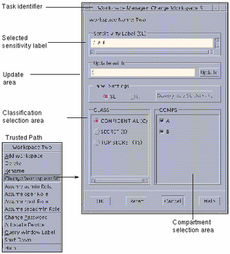

    The dialog box shown below is displayed.
    Figure 4-8 Change Workspace SL Dialog Box
    Graphic
  2. Click the desired classification in the classification selection area.
  3. Click the desired compartments (if any) in the compartments selection area.
  4. Check the sensitivity label you have built in the update area. Click the OK button if it is correct or go back to step 2 to build a different sensitivity label.
