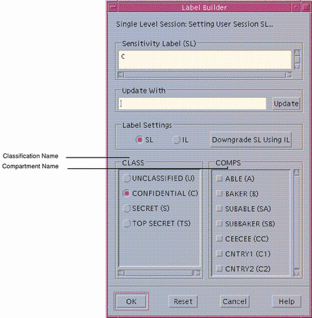

The default names used in label builder dialog boxes in the window system for classifications and compartments are shown in Example 4-2.
Classification Name= Class; Compartments Name= Comps;
The following figure shows the names CLASS and COMPS used on the Session SL dialog box.
See "To Change Label Component Names Used in Label Builders (Optional)".
