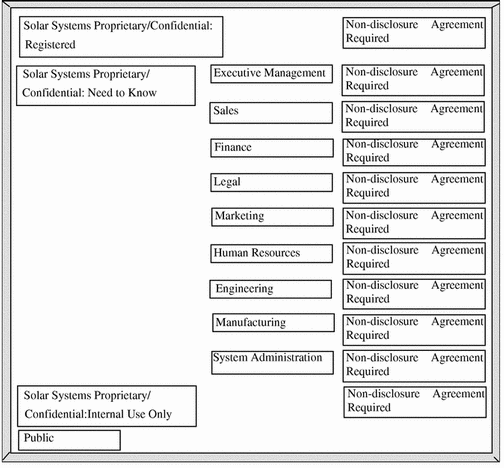

Solar Systems, Inc. is a fictional name for the company whose label requirements are modeled in this example. To protect the corporation's intellectual property, the company's legal department mandates that employees use three labels on all sensitive email and printed materials. The three labels, from most-sensitive to least-sensitive are:
Solar Proprietary/Confidential: Registered
Solar Proprietary/Confidential: Need To Know
Solar Proprietary/Confidential: Internal Use Only
The legal department also approves the use of an optional fourth label for information that can be distributed to anyone without restrictions:
Public
At Solar Systems, Inc., the manager in charge of Information Protection makes use of all possible channels to get the word out about labeling requirements. Some employees either do not understand, forget about or ignore the requirements. Even when labels are properly applied, the information is not always properly handled, stored, and distributed. For example, reports trickle back that even Registered information (which only a limited list of people should see and nobody but the originator should copy) is sometimes found unattended next to copy machines and printers, in break rooms, and lobbies.

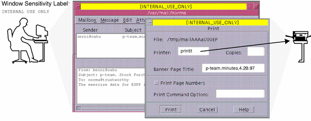

Each print job is automatically assigned a sensitivity label, which is the label that corresponds either to the sensitivity level at which the user is working or to the user's level of responsibility.
Figure 5-1 shows an employee working at a sensitivity level of INTERNAL_USE_ONLY, which means that the work he is doing should only be accessible by Solar Systems employees and others who have signed nondisclosure agreements. When he sends email to the printer, the print job is automatically assigned the sensitivity label INTERNAL_USE_ONLY.

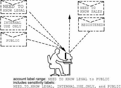

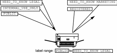

Printers can be configured to print only jobs with labels within a restricted label range.
For example, the legal department's printer can be set up (as illustrated in Figure 5-4) to print only jobs sent at the following three labels:
NEED_TO_KNOW LEGAL (to be viewed only by those with a need to know within the legal department)
INTERNAL_USE_ONLY (to be viewed only by permanent employees of the Solar Systems company and other who have signed nondisclosure agreements), and
PUBLIC (to be viewed by anybody)
A printer set up as specified above would exclude jobs sent at any other label. For example, the legal department printer set up as described above would reject jobs at:
NEED_TO_KNOW MARKETING, and
REGISTERED
Printers in other locations that are accessible to all employees can be configured to print jobs only at the two labels that allow the output to be viewed by all employees:
INTERNAL_USE_ONLY
PUBLIC

Because the four labels are hierarchical, they will be encoded as hierarchical classifications.
With the legal department's approval, the security administrator shortened the labels by omitting Solar Systems Proprietary/Confidential: from the label names. Classifications do not allow the use of a slash in the label, and long classifications make it difficult for employees to read the labels in the window system. The name of a label is truncated from right to left in the window frames. Because the truncated names of all the label names above PUBLIC would begin with the words SOLAR SYSTEMS PROPRIETARY CONFIDENTIAL, the truncated names would be indistinguishable without manually extending the frame for each window.
The security administrator defined the following labels:
REGISTERED
NEED_TO_KNOW
INTERNAL_USE_ONLY
PUBLIC
The group names will be encoded as non-hierarchical compartments. Compartments will be restricted to appear only in labels that have the NEED_TO_KNOW classification. Compartments are restricted to appear with certain classifications by settings in the ACCREDITATION RANGE section under COMBINATION CONSTRAINTS.
