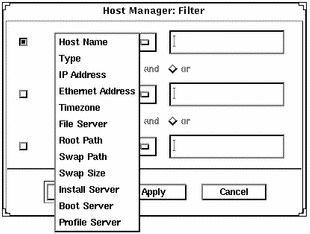

To view specific system entries in Host Manager's main window, choose Set Filter from the View menu. The Filter window is displayed and you have the option of setting from one to three filtering characteristics, as shown in Figure 5-3.
After you have chosen a method for filtering the entries that are displayed in the main window, click on OK.
