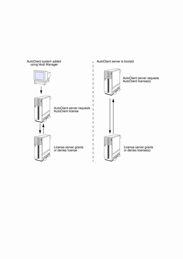

A license request is generated by the AutoClient server in the following cases:
When an AutoClient is added to the AutoClient server
When the AutoClient server is booted
The AutoClient server requests a license for each AutoClient it is configured to support. It obtains this information from the bootparams database.
License server
The license server receives the request to provide a license for an AutoClient from the AutoClient server, and it grants or denies this request.
Figure 4-1 describes the events that cause the AutoClient server to request a license.
