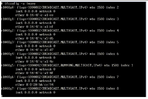

2. To output a list of all Solaris named interfaces along with their physical MAC addresses, type this command at the prompt (#):
A sample ifconfig-a output is as follows:
lo0: flags=2001000849<UP,LOOPBACK,RUNNING,MULTICAST,IPv4,VIRTUAL> mtu 8232 index 1 inet 127.0.0.1 netmask ff000000 e1000g0: flags=1000802<BROADCAST,MULTICAST,IPv4> mtu 1500 index 2 inet 0.0.0.0 netmask 0 ether 0:14:4f:c:a1:ee e1000g1: flags=1000802<BROADCAST,MULTICAST,IPv4> mtu 1500 index 3 inet 0.0.0.0 netmask 0 ether 0:14:4f:c:a1:ef e1000g2: flags=1000802<BROADCAST,MULTICAST,IPv4> mtu 1500 index 4 inet 0.0.0.0 netmask 0 ether 0:14:4f:c:a5:d6 e1000g3: flags=1000802<BROADCAST,MULTICAST,IPv4> mtu 1500 index 5 inet 0.0.0.0 netmask 0 ether 0:14:4f:c:a5:d7 e1000g4: flags=1000802<BROADCAST,MULTICAST,IPv4> mtu 1500 index 6 inet 0.0.0.0 netmask 0 ether 0:14:4f:c:a1:4e
In the sample above, the Solaris named network interfaces appear as e1000g0, e1000g1, and so on. The MAC address for each network interface appears after the word ether. For example, the MAC address associated to the Solaris named network interface e1000g0 is 0:14:4f:c:a1:ee.
3. Record the Solaris network interface name for each MAC address previously recorded in the Configuration Worksheet list.

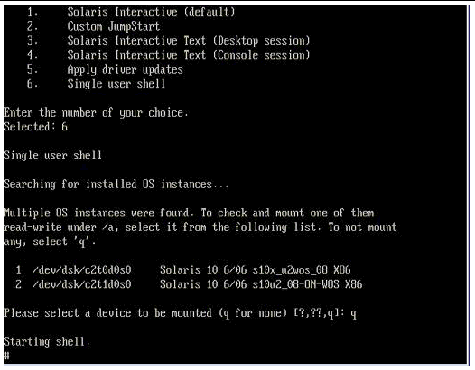

1. In the Install Type menu, select Option (6) Single User Shell and press Enter.
If a message appears about mounting an OS instance, select q. You should not mount any OS instance.
The message “Starting Shell” appears, see the following figure.
