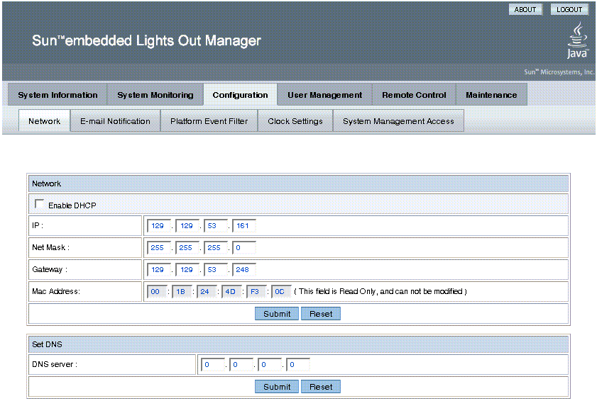

From the Configure submenu, click the Network tab.
The Network configuration screen appears (see FIGURE 4-1). Use this screen to enable or disable DHCP and set DNS. If you disable DHCP, you must manually supply the IP address, the netmask, and the gateway.

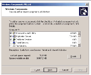

4. Use Control Panel to access Add or Remove Programs, and click Add/Remove Windows Components.
The Windows Components Wizard appears.
5. In the list of components, in the Windows Components screen, click the check box to enable Certificate Services (see FIGURE 4-3).
FIGURE 4-3 Windows Components Screen

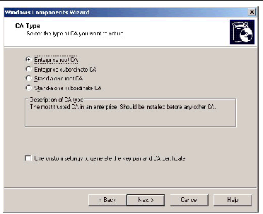

7. In the CA Type screen of the Windows Components Wizard, select the type of CA you want to set up (see FIGURE 4-4).
FIGURE 4-4 CA Type Windows Components Wizard Screen

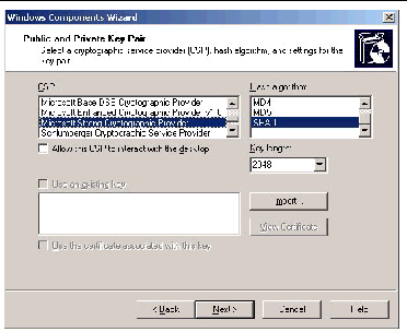

8. In the Public and Private Key Pair screen, select a cryptographic service provider (CSP), a hash algorithm, and settings for the key pair (see FIGURE 4-5).
FIGURE 4-5 Public and Private Key Pair Windows Components Wizard Screen

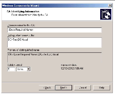

10. In the CA Identifying Information screen, enter the necessary information to indentify this CA (FIGURE 4-6), and click Next.
FIGURE 4-6 CA Identifying Information Windows Components Wizard Screen

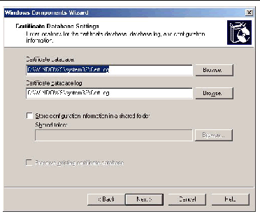

11. In the Certificate Database Settings screen, enter the locations for the certificate database, database log, and configuration information (see FIGURE 4-7).
FIGURE 4-7 Certificate Database Settings Windows Components Wizard Screen

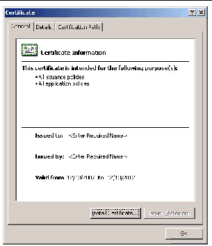

14. Double-click the Certificate.
The certificate screen appears.

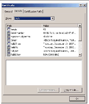

FIGURE 4-8 The Certificate Information Screen
The Certificate Details screen appears (see FIGURE 4-9).
FIGURE 4-9 The Certificate Details Screen

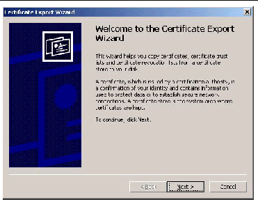

16. Click the Copy to File... button.
The Certificate Export Wizard screen appears (see FIGURE 4-10).
FIGURE 4-10 The Certificate Export Wizard Screen

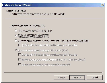

The Export File Format screen appears.
FIGURE 4-11 The Export File Format
18. Under the heading Select the format that you want to use:, click the radio button for the second option, Base-64 Encoded X.509 (.CER).

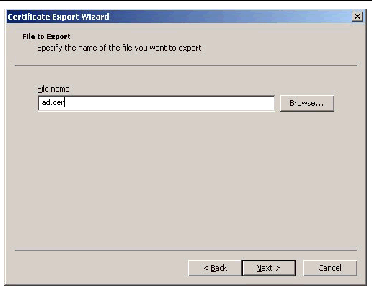

The File to Export screen appears (see FIGURE 4-12)
FIGURE 4-12 The File to Export Screen
| Note - DNS resolution issues might occur if the filename is incorrect. |
Store this exported certificate in a shared folder of your choice.
The ad.cer file is exported to the shared folder.

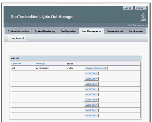

The User Management tab provides access to the User Account screen, which lists current users by privilege and status, and enables the administrator to add, delete, modify and enable/disable user accounts.
The ELOM supports up-to 10 user accounts. One of the user accounts is root, which is set by default and cannot be removed. Therefore, you can configure 9 additional accounts. Each user account consists of a user name, a password, and a permission.
| Note - User permissions extend to both the web GUI and the serial connection methods. |
The permissions that a user can be assigned include:
TABLE 4-2 shows the user permission levels and the access each level has to the ELOM menus and screens.
| Note - If the SP password has been changed and then lost, a BIOS option exists to reset the password back to the default changeme. See Resetting the Service Processor. |
1. From the User Management submenu, click the User Account tab.
2. Click any button labeled Add User.
The Manage User Account screen appears (see FIGURE 4-13).
If all 10 user account slots are configured, you must delete an existing user account before you can add a new user account. See To Delete a User Account.
FIGURE 4-13 The User Management Screen
2. Click either the Change Password or Change Permission button for the user.
3. Change the password or privilege as needed.
4. After you have modified the user information, click Submit for your changes to take effect, or click Reset to return to the previous settings.
A confirmation screen verifies that the user account was modified successfully. To change the administrator password using the BIOS Setup Utility, see Changing the Administrator Password Using the BIOS Setup Utility.
