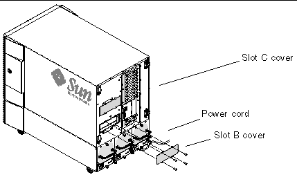

3. Remove the system back panel covers for the slots to be used for the Sun
XVR-4000 graphics accelerator (FIGURE 4-1).
The back panel filler slot covers are secured by four Phillips screws. Remove them and retain them for later use.

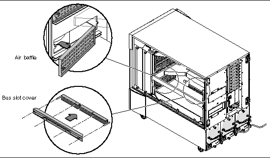

6. Remove the air baffle from the CPU bracket and remove the dust cover from the motherboard VHDM connector (slot B for one Sun XVR-4000 graphics accelerator, slots B and C for two graphics accelerators). (FIGURE 4-4).
7. Store the air baffle by sliding it under the metal storage slot located on the enclosure interior ceiling.
When the air baffle is properly aligned in the storage slot, the air baffle black pin will easily insert into the metal slot hole to lock it in place. (If you are replacing the air baffle for the chassis board slot, properly align the air baffle in the slot and the black pin will easily insert into the hole to lock the air baffle in place.)

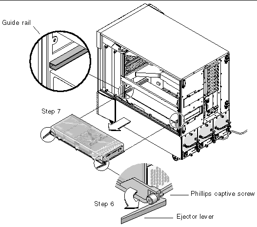

9. Position the Sun XVR-4000 graphics accelerator into the chassis guide rails for the selected slot (B or C).
10. Make sure that the Sun XVR-4000 graphics accelerator ejector levers are rotated out to 90 degrees (FIGURE 4-5)
11. Holding the two ends of the graphics board, slide the Sun XVR-4000 graphics accelerator into the card guide frame.
Use slot B for one Sun XVR-4000 graphics accelerator, slots B and C for two graphics accelerators.
Stop once the Sun XVR-4000 graphics accelerator ejector levers begin to contact the frame.
Note - If the ejectors are unable to contact the metal card guide frame, do not try and force the board into place. Damage to the Sun XVR-4000 graphics accelerator or motherboard may occur. |
12. Grasp both ejector levers and rotate them inward simultaneously.
Avoid rocking the board in the card guides. The board has a tendency to pull to the left (front) side of the chassis (as viewed from the CPU module/Sun XVR-4000 graphics accelerator side). Installation should be smooth and uniform.
13. Once the ejector levers are fully rotated in, hand tighten both captive screws.
