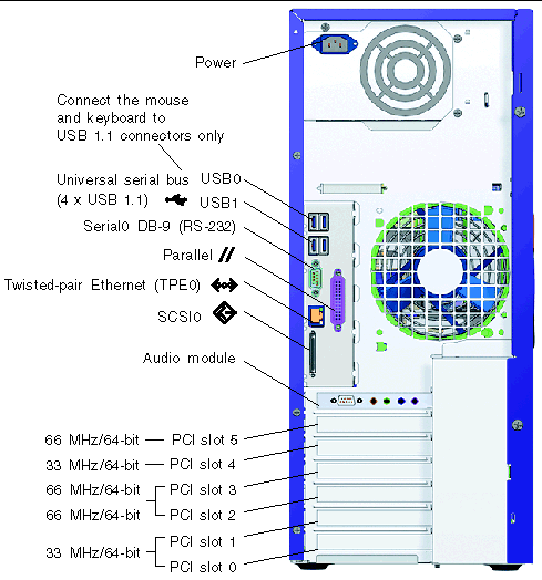

2. Connect the keyboard and mouse to the on-board USB 1.1 connectors (the connectors near the fan FIGURE 1-4).

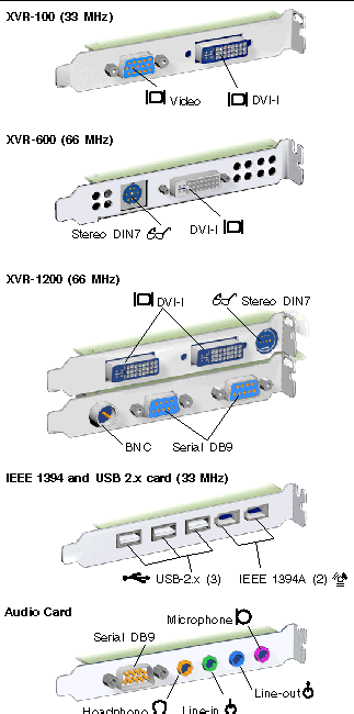

4. Connect the monitor cable to the video connector on the filler panel of the graphics accelerator.
Note - Your Sun Blade 2500 workstation might contain a different graphics accelerator than the one shown in FIGURE 1-6. Read the Sun Blade 2500 Product Notes (817-5121) to determine if your graphics accelerator must be installed in a specific PCI slot. |

5. Connect the Ethernet cable to the TPE connector.
6. Connect any additional external devices to the workstation's other connectors.
