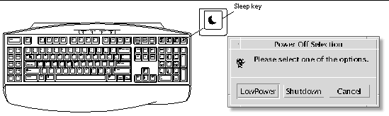

Putting the Workstation Into Low-Power Mode
After a predetermined period of inactivity, the workstation might automatically enter the low-power mode. You can manually put the workstation into low-power mode.
1. Press the Sun Type 6 USB keyboard Sleep key (FIGURE 2-2).
The Power Off Selection dialog box is displayed.
2. Select LowPower from the Power Off Selection dialog box.
The workstation completes any in-process activities, then enters low-power mode after a short time-out period.
Note - Use the keyboard Sleep key to place the workstation in low-power mode or to power off the workstation. See FIGURE 2-2.
Note - The Sleep key cannot be used to power on the workstation. Press the Power button on the front panel to power on the workstation.
FIGURE 2-2 Sun USB Type-6 Keyboard Sleep Key and Power Off Selection Menu
Figure shows the Sun USB Type-6 keyboard and the Power Off Selection dialog box.[ D ]
