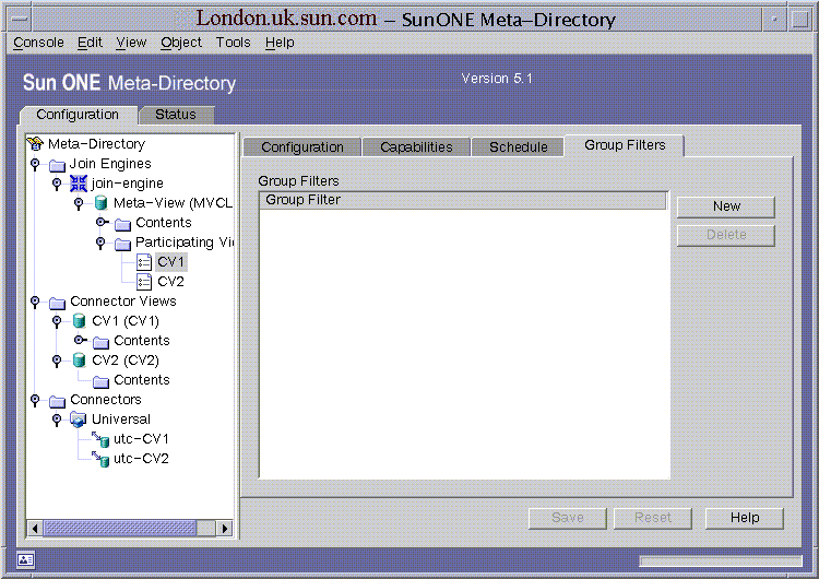

- Select the Group Filters tab.
The Group Filters tab enables you to create one or more filters for LDAP data sources. You can use the group filters to refresh entries of a connector view only. The format of the filter is (attribute=value). Note that the parentheses are part of the syntax.
When you refresh groups, the join engine refreshes only the entries that match the group filter or filters you have specified. For information about refreshing groups, see "Join Engine Operations".
- Click Save when you finished configuring the participating connector view.
