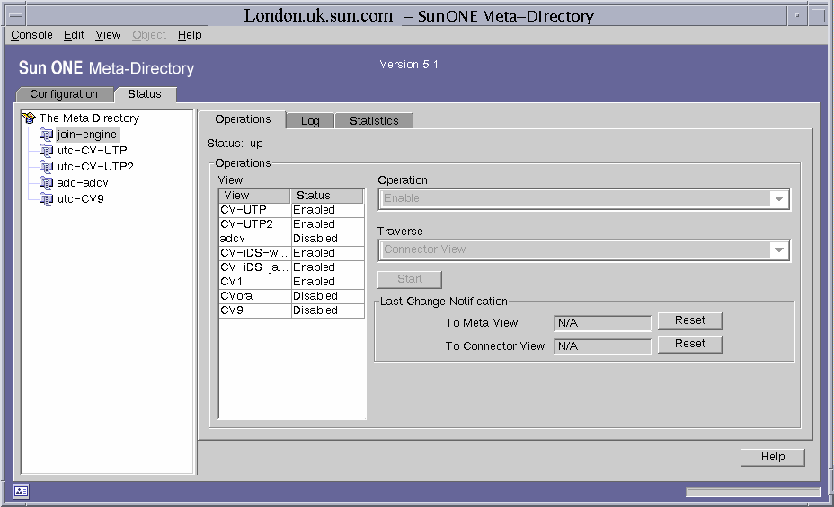

Join Engine Operations
You can view and change the operations of the join engine and its data by selecting the join engine and clicking Operations from the Status tab.
Figure 17-1
The Operations Window for the Join Engine
The following sections explain the fields within the join engine's Operations tab.
Status
The Status field tells you whether the join engine is currently running (up) or not running (down).
View
The View field lists all participating views and whether they are enabled. An enabled view is currently flowing data while a disabled view is not. The participating view can be enabled even though the join engine status is down.
Operation
From the Operation drop-down list, you can choose options to apply to the participating view that is selected in the View field.
Enable Choose this option to allow the selected participating view to flow data. (This option disables the Traverse option.)
Disable Choose this option to stop the selected participating view from flowing data. (This option disables the Traverse option.)
Refresh Choose this option to scan the entries in the connector view or the meta view (depending on your selection in the Traverse drop-down menu) for changes. The changes will be integrated and the link information recreated based on the join rules defined in the participating view.
Refresh Unlinked Choose this option to refresh only unlinked entries in the connector view or the meta view depending on the option selected in the Traverse drop-down menu.
Refresh Groups Choose this option to refresh entries in the connector view or the meta view depending on the option selected in the Traverse drop-down menu. The group filter, which allows you to refresh certain entries of the view, is applied prior to the refresh. More information on the group filter can be found in "Select the Group Filters tab.".
Break Links Choose this option to break all links between the connector view and the meta view. After the links are broken, the join rules need to be re-applied to recreate the link information.
Validate Links Choose this option to check for invalid links. It also attempts to re-join the data based on the join rules defined in the participating view.
Traverse
When chosen with one of the refresh or link operations above, the Traverse option allows you to choose whether to scan the entries in the meta view or the connector view. Once the Operation and Traverse options are chosen, click Submit Request to begin the operation.
Last Change Notification
The change log assigns a sequential number to changes. The last change notification refers to the last change number the join engine processed. The join engine will only process the change log numbers greater than the number in the last change notification field. The Reset button resets the value.

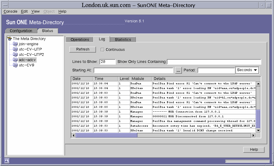

Log Window Options
The following sections explain the fields within the Logs tab.
Figure 17-4
The Log Window for Connectors
Refresh
To activate log settings and update the log table to include any new logs, click Refresh. Refresh must be activated after any of the Log window options are modified.
Continuous
To update the log table continuously, choose Continuous.
Lines to Show
To limit the maximum number of lines you would like to have in the log table, enter a number here.
Show Only Lines Containing
To limit the set of lines with a filter, enter a text search string here.
Starting at
Use this field to time-delay the start of a search. Click the "..." button to use a time-date calendar for easy input.
Period
This field is used to specify the time duration for the log search. For instance, if you want to display all logs that occurred up to 90 minutes after the starting time specified above, select Minutes from the drop-down menu and enter 90.

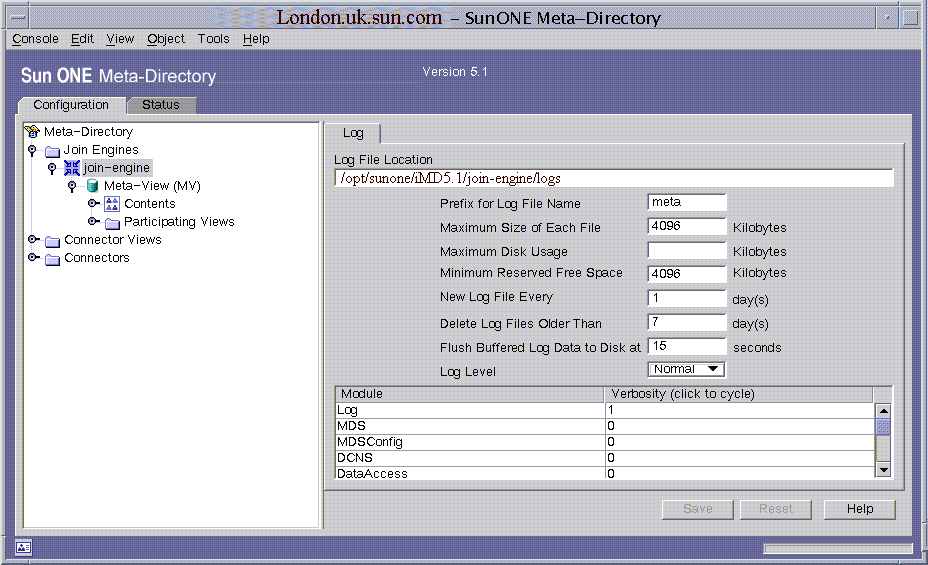

Specifying Log File Preferences
Log file preferences such as name, location, log level and verbosity are set specifically for each component. By selecting the component, you will be able to configure its log file preferences.
Working within the Log Window
  1. From the navigation tree in the Meta-Directory console, select a component (join engine or connector instance).
  2. The Log Window appears.
  3. Provide values by entering specifications for the following fields:
  4. Log File Location
    Specifies the directory into which the log files are saved. To specify a directory other than the default, enter the full path name in this field.
    Prefix for Log File Name
    Specifies the word to precede the log file name as:
    prefix-yyyymmdd-nn.log
    For example, if you enter delta as the prefix, it would appear as in the following example:
    delta-20010521-01.log
    Maximum Size of Each File
    Specifies the maximum size of the log file. After reaching this size, a new log file is created. The default is 4096 KB.
    Meta-Directory checks the log file size in five minute intervals. If, between the intervals, the log file reaches and surpasses the maximum size, Meta-Directory will allow this until the maximum file size is checked again on the five minute mark. At that point, a new log file is created.
    Maximum Disk usage
    Specifies the maximum disk space set aside for logging. When the maximum disk space is reached, logging is temporarily halted. The default is no maximum. (The field is blank.)
    If you specify a maximum available disk space, it must be at least twice the size of the maximum log file size, because the service always stores one backup log file. If the maximum available disk space is less than twice the maximum log file size, the new file cannot reach its maximum size.
    Minimum Reserved Free Space
    Disk space is reserved for log file storage. By default, the service reserves a minimum of 4096 KB of space.
    New Log File Every
    Determines the length of time that a log file should record activities before creating a new log file. If the maximum size of the log file is reached first, a new log file is created. The default is 1 day. This value must be less than the value in the Delete Log Files Older Than field.
    Determines when log files will be automatically deleted. The default is 7 days. This value must be greater than the value in the New Log File Every field. (Active Directory connector lacks this functionality.)
    Flush Buffered Log Data to Disk at
    Determines when the log data buffered in memory is to be flushed to the disk.
    Log Level
    Each component's logging function can be turned on or off via the Log Level. The three levels of logging are as follow:
    • Off - Nothing is logged.
    • Normal - Necessary information for daily administration is logged. (Disk space requirements are likely to be small and new files are created infrequently.)
    • Debug - Maximum amount of information needed for debugging is logged. (Disk space requirements are likely to be large and new files are created frequently.)
    You can switch levels without restarting the join engine.
    Verbosity
    The verbosity of a log refers to the description of an activity within a log line. Unlike the log level which controls the logging capability at the component level, verbosity controls the activity description at a module level within each component. (For example, the log level for join engine might be set to Normal while two specific join engine modules, Log and DataAccess, are set to verbosity levels 1 and 3, respectively.) The verbosity levels are as follow:
    0 - No logging for specified module
    1 - Default (minimum) verbosity level for specified module
    2 - Moderate amount of logging for specified module
    3 - Maximum amount of logging for specified module

The Statistics window is the error reporting utility of Meta-Directory. After processing an administrative task, you can check the Statistics window for any success or error messages returned by the component processing the task.
From the Status tab navigation tree in the Meta-Directory console, select a component (join engine or connector instance) and click Statistics. For an explanation of the messages that can be returned, see "Error Responses".
