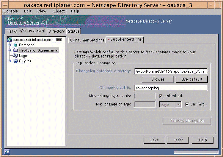

Enabling the Netscape Directory Server Change Log
To enable the change log for Netscape Directory Server version 4.1x:
- Open the Directory Server console.
- Select the Configuration tab; the Configuration window appears.
- Select the Replication Agreements node in the navigation tree, then select the Supplier Settings tab in the right pane (shown in Figure 3-2).
- Click the Use Default button to specify the default file path for the change log files.
- Check the Max Changelog Records and Max Changelog Age settings so these parameters are set to "unlimited."
- Once you enable the change log, you must restart the Directory Server for the settings to take effect.
Figure 3-2    Enabling the Change Log in Netscape Directory Server
