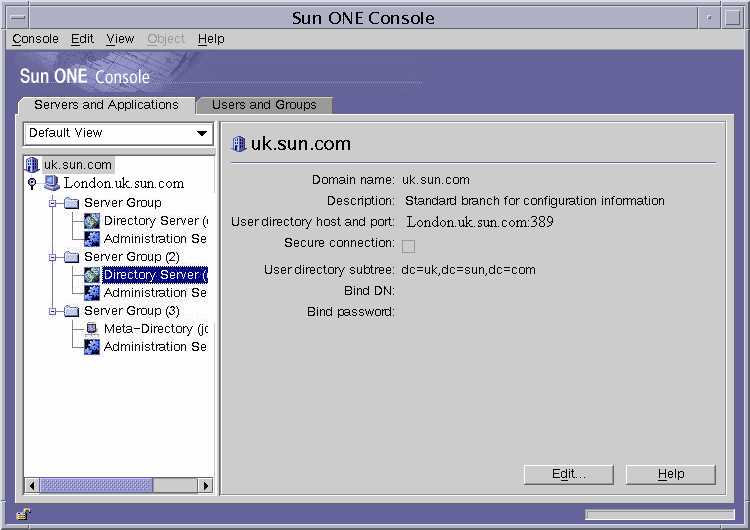

Server Groups
Sun ONE Console uses "server groups" to represents the different sets of Sun ONE servers and services installed in your Meta-Directory system.
When you install different instances of Administration Server, each one is represented as a server group within Sun ONE Console. In your Meta-Directory system, you will have at least one server group displayed in your Sun ONE Console. However, it is possible to have several, depending on your Meta-Directory system setup.
For example, suppose you are using iPlanet Directory Server 5.x to host your Meta-Directory views. In this case, you will first install iPlanet Directory Server then Sun ONE Meta-Directory. Sun One Meta-Directory is supported by Sun ONE Administration Server 5.2. iPlanet Directory Server is managed by Sun ONE AdministrationServer 5.0
Suppose you then use Netscape Directory Server 4.15 to host a direct connector view. Netscape Directory Server 4.15 is supported by Netscape Administration Server 4.2.
In this scenario, there are three versions of Administration Server. When you open Sun ONE Console to administer your Meta-Directory system, you will see three server groups, one for each Administration Server.
The figure below shows three server groups. In this setup, the configuration database and the meta view are hosted by different Directory Server instances, with each instance supported by its own Administration Server. A third server group was created for the Meta-Directory components because a third Administration Server was installed when Meta-Directory was installed. Here, the join engine uses the Directory Server instance in Server Group (2) to host the meta view.
Figure 2-1    Multiple Server Groups in Sun ONE Console

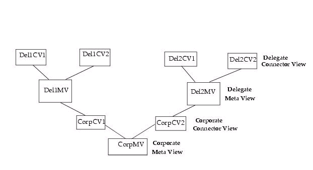

Cascading Meta Views
The idea of cascading metaview comes into use, when there is a need to synchronize data from various Sun ONE Meta-Directory installations into one single repository. The diagram below illustrates a typical setup with three Meta Directory Installations.Two subordinate or delegate Meta installations connected to one main Corporate Meta installation.
Each entry in a Meta-Directory installation is owned by a particular view. This ownership information is stored in the attribute mdsEntityOwner. Any modifications made to an entry in any of the views flows to all the views. However, only the owner view has the right to delete an entry. If an entry is deleted from any other view, it should get added back. A non-owner, however, can modify an entry. In a cascading Meta-View setup, such as the one shown above in the figure, deletion of entries even by owner views was not happening in the previous release.
This was reported in the problem (#4636032) "Entries failed to delete from cascade meta view setting". This problem has now been fixed. Now entries can be deleted from the owner views, across all the Meta-Directory installations. If an entry is deleted by a non-owner, it gets added back.
Steps for setting up Cascading Meta views

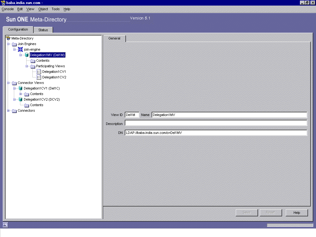

This set up consists of 2 Delegation Installations and 1 Corporate Installation. The idea is to synchronize the data from various views to Corporate Meta View. All these 3 installations have separate iPlanet Directory Server installations.

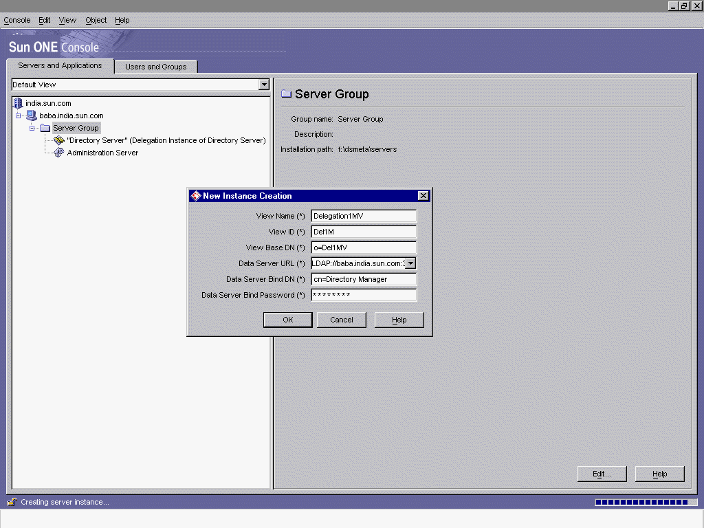

  1. Install Sun ONE Meta-Directory on the first machine (refer this installation as delegation 1 installation) and create the Join Engine instance and give the view name as Del1MV.
Table 3    Del1MV

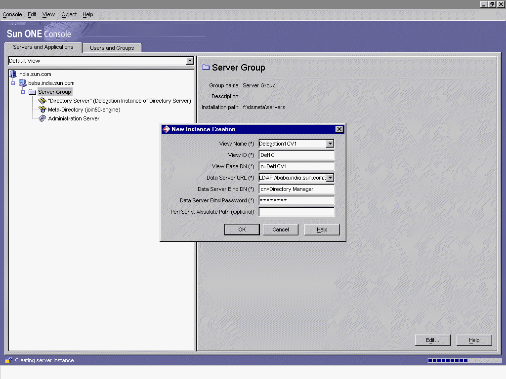

  1. Create a Connector view 1 (refer this as Del1CV1 or UTC CV1, use any UTC connector or Oracle connector) and populate data into connector view.
Table 4    Del1CV1

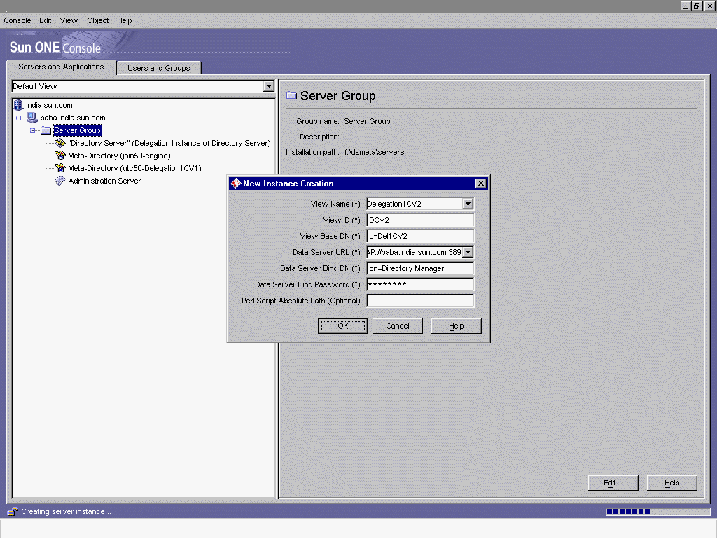

  1. Create a Connector view 2 (refer this as Del1CV2 or UTC CV2, use any UTC connector or Oracle connector) and populate data into connector view.
Table 5    Del1CV2
  1. Add Del1CV1 & Del1CV2 as JoinEngine's participating views and enable the participating views. Assume contents of Del1MV is present under suffix o=Del1MV.
Table 6    Del1 Predicating View

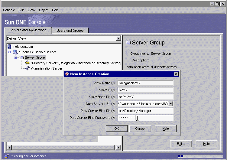

  1. Do another Delegation installation of Meta-Directory on the second machine (refer this as Delegation 2 installation) and create the Join Engine instance and give the view name as Del2MV.
Table 7    Del2MV

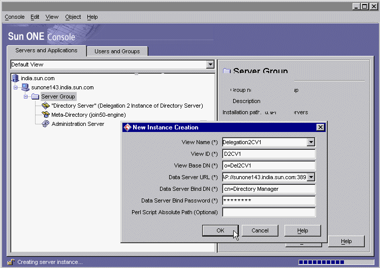

  1. Create a Connector view 3 (refer this as Del2CV1 or UTC CV3, use any connector and populate data into connector view.
Table 8    Del2CV1

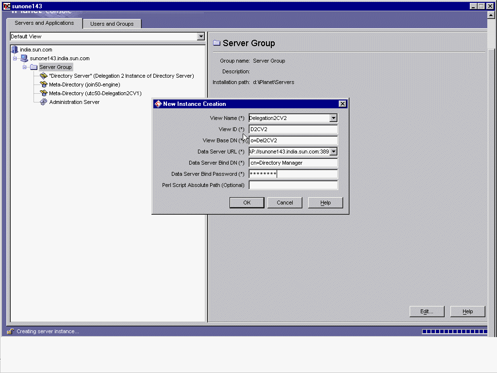

  1. Create a Connector view 3 (refer this as Del2CV2 or UTC CV4, use any connector and populate data into connector view.
Table 9    Del2CV2

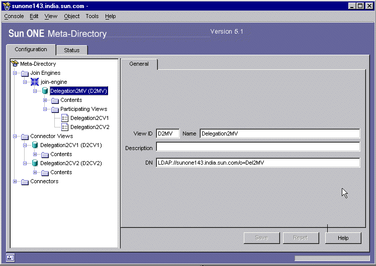

  1. Add Del2CV1 & Del2CV2 as Join Engine's participating views and enable the participating views. Assume contents of Del2MV is present under suffix o=Del2MV.
Table 10    Del2 Participating View

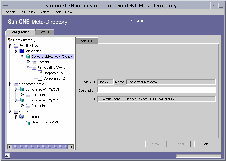

  1. Now, do Corporate Installation of Sun ONE Meta-Directory on the third machine (refer this as Corporate installation) and create the Join Engine instance and give the view name as CorpMV.
Table 11    CorpMV
  1. Create a Corporate Connector view1 (refer this as CorpCV1) and populate data into connector view. To create the Connector View, you have two options
Either (a) Create a LDAP data server from Sun ONE Meta-Directory - Data Servers, and use this URL while creating the CorpCV1
host name -- host name of the system where delegation mds installation(Del1MV) is running.
port -- port number that stores contents of o=Del1MV.
Bind dn and password for that ids instance. (Assume that data server created as a result of this operation as baba.india.sun.com:389)
or (b) Create a new connector (refer this cv as CorpCV1 ) on corporate mds installation which actually points to delegation 1 installation's MV (For example, give baba.india.sun.com:389 as data server url. enter o=Del1MV as base view dn).
Table 12    CorpCV1

With this configuration, data flows properly between Del1MV, Del1CV1, Del1CV2, Del2MV, Del2CV1, Del2CV2, CorpMV, CorpCV1 and CorpCV2.
