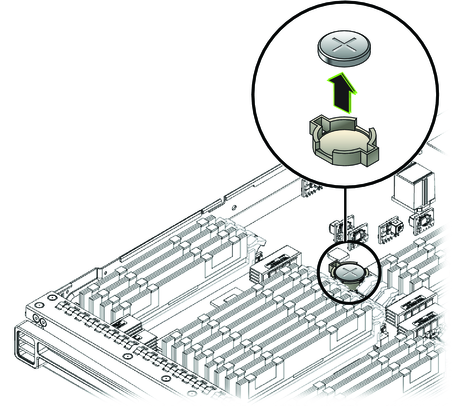

  6. Pry the battery out of the battery socket and remove from the server.
    Note - Dispose of or recycle the battery in accordance with your local regulations and facility procedures.

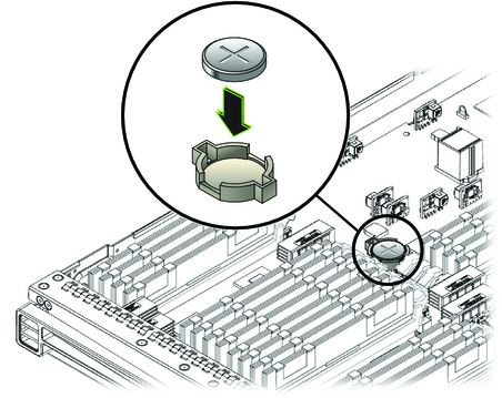

  7. To install the new battery, place the battery on top of the battery socket with the positive terminal (+) side facing upward and carefully push the battery into the socket until it sits flat.
