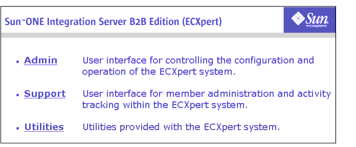

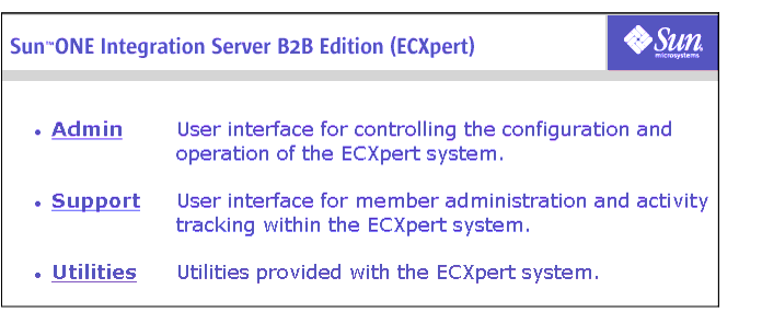

    The ECXpert main menu screen is displayed as shown in Figure 4-1.
    Figure 4-1  ECXpert Main Menu
  7. Click the Support link to open the Product Administrative Interface Login window and proceed to the section Testing ECXpert.

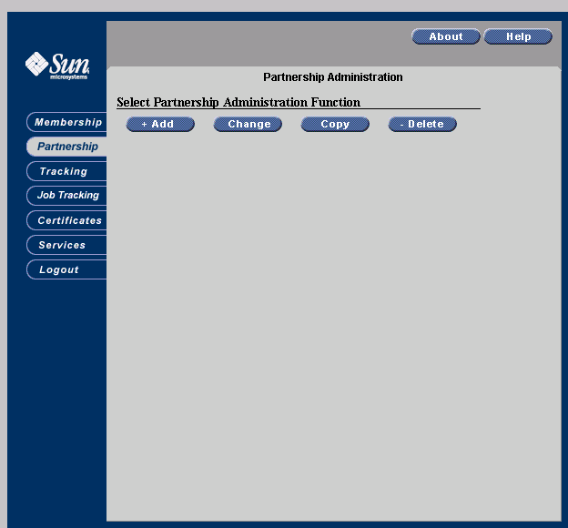

  3. Click the Partnership tab. The Partnership Administration screen appears, as shown in Figure 4-5.
  4. Figure 4-5  ECXpert Partnership Administration Screen

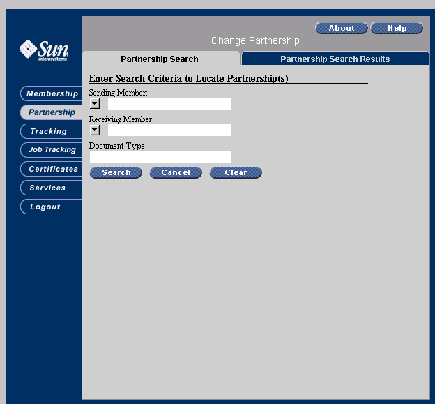

  5. Click Change. The Partnership Search screen appears, as shown in Figure 4-6.
  6. Figure 4-6  ECXpert Partnership Search Screen

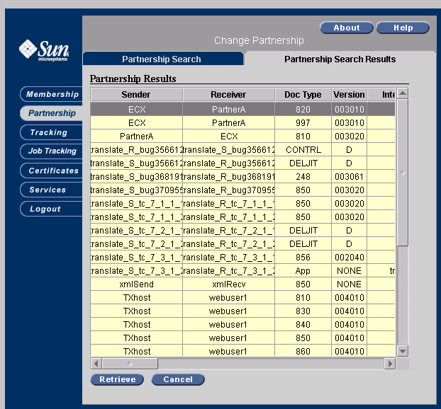

  7. Click Search. The Partnership Results screen appears as shown in Figure 4-7.
  8. Figure 4-7  Partnership Search Results Screen
    All of the available partnerships appear in the Partnership Results screen. Select the following partnership:
    • Sender - PartnerA
    • Receiver - ECX
    • Doc Type - 810
    • Version - 003020
    • Then click Retrieve (or double-click the highlighted partnership).

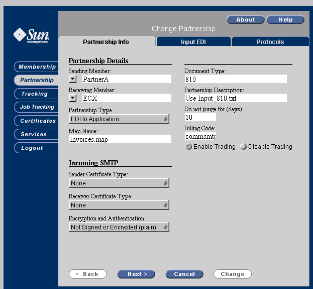

      After briefly displaying the message ‘Please Wait……’, the Partnership Info tab is displayed with the partnership details, as shown in Figure 4-8.
      Figure 4-8  ECXpert Demo Partnership Info Tab

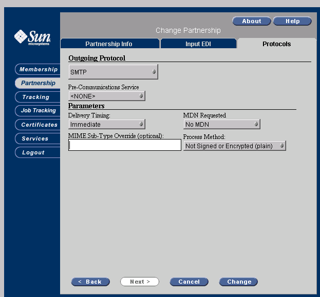

  9. Click the Protocols Tab to display the Outgoing Protocol page, as shown in Figure 4-9. The default protocol you will see is SMTP.
  10. Figure 4-9  ECXpert Demo Partnership Outgoing Protocols Page

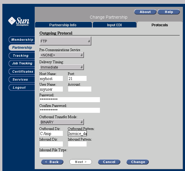

  11. Set up the demo trading partnership to use the FTP Protocol. From the Outgoing Protocol drop-down list, change the default value of SMTP and select FTP.
  12. Enter the following values, shown in Table 4-1, for the other fields on this page:
  13. Table 4-1  Demo Partnership Protocol Values

    When you have finished filling in the Protocols tab, it should look similar to Figure 4-10 (with your values for host, port, user name, and account).
    Figure 4-10  Completed Partnership Protocols Tab

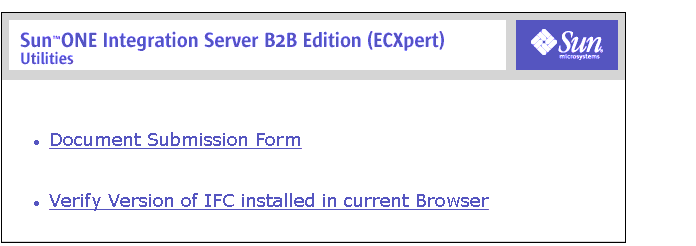

  16. The Utilities screen appears, as shown in Figure 4-11.
    Figure 4-11  ECXpert Utilities Window

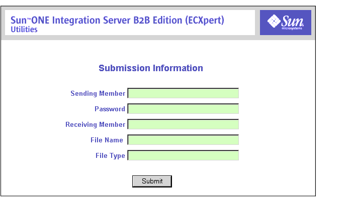

  17. Click the Document Submission Form link. The Submission Information form is displayed, as shown in Figure 4-12.
    • On Solaris™
    • Copy the test file
      /Root_ECX_Install/NS-apps/ECXpert/maps/Input_810.txt
      to /temp.
      In place of Root_ECX_Install in the first path, specify the ECX install directory.
    • In Windows
      drive:\ecx36\NS-apps\ECXpert\maps\Input_810.txt
      to C:\temp.
      In place of drive in the first path, specify the drive specifier for the location where you have ECXpert installed.

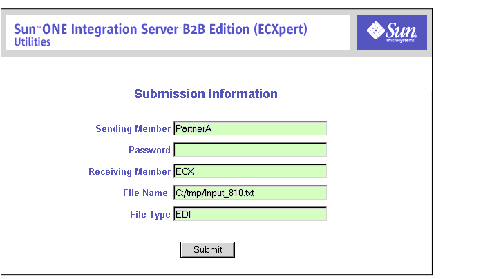

      Figure 4-12  ECXpert Utilities Document Submission Screen
      Enter the following information in the Submission Information form:
      Table 4-2  Submission Information for Solaris and Windows
      Field Name
      Field Description
      Enter this Value
      Sending Member
      The name of the member sending the file.
      PartnerA
      Password
      The sending member’s password. No value is needed if the sending member is trusted.
      No value
      Receiving Member
      The name of the member receiving the file.
      ECX
      File Name
      The fully qualified pathname for the file you want to send.
      Windows: C:\TEMP\INPUT_810.txt
      Solaris: /tmp/Input_810.txt
      File Type
      The file type of the file you want to send.
      EDI
      When you have finished filling in the Submission Information form, it should look similar to that shown in Figure 4-13.
      Figure 4-13  Completed Submission Information Screen

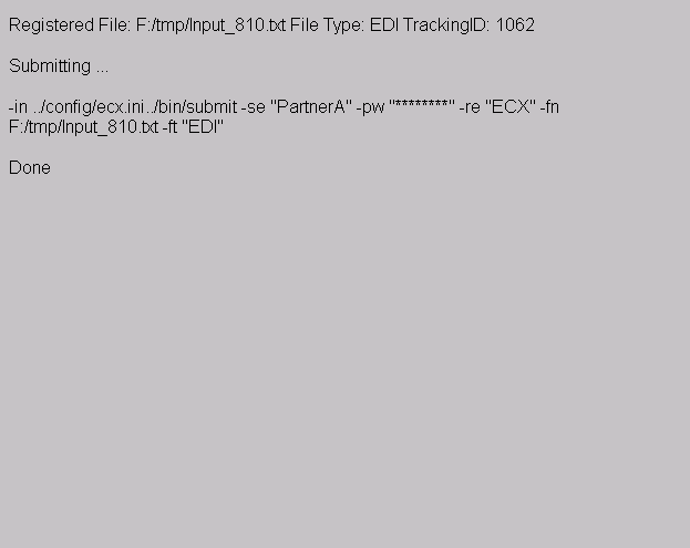

  18. Click Submit. When the file has been submitted, a screen appears, shown in Figure 4-14, indicating registration of the file for submission and confirmation that the submission is done. If an error appears, proceed to step 16.
  19. Note
    The screen showing completed submission used an internal working data path to the demo data versus the production data path specified in Table 4-2.
    Figure 4-14  Submitted File Screen

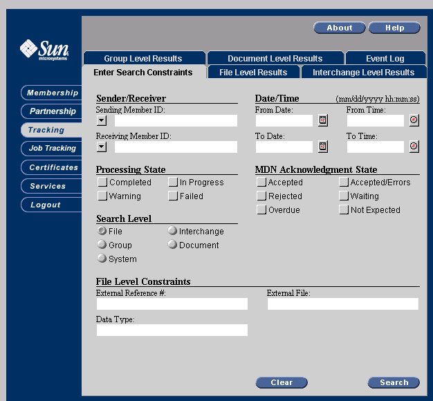

  25. Click the Tracking tab. The Enter Search Constraints tab appears, as shown in Figure 4-15.
  26. Figure 4-15  ECXpert Support UI Tracking Tab File Constraints
  27. In the Date/Time portion of the screen, click the Calendar icon immediately to the right of the From Date: field. Today’s date appears in the From Date: field. Click Search.
  28. The File Level Results tab appears, displaying all of today’s submissions. You can identify your submission by looking for the appropriate sender, receiver, and doc type.
    If there is a green dot in the far left column of your submission, the test document was submitted correctly. Oracle and ECXpert have been installed and configured correctly.
