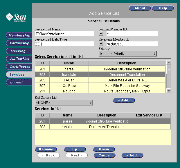

Service List Setup A
This service list does not include the Gateway service: after a purchase order (ANSI X.12 850) is parsed and translated to TradingXpert format, it is stored by ECXpert until being retrieved by TradingXpert. If Gateway is in this service list, ECXpert attempts to send purchase orders directly to the trading partner.
Figure 5-1 and the accompanying Table 5-2 show how to set up a service list for this exchange.
Figure 5-1  Service List Screen for TXhost Sending Purchase Order to webuser1
Table 5-2  Service List details for TXhost Sending Purchase Order to webuser1
Field
Value
Explanation
Service List Details
Service List Data Type
EDI
Indicates the type of document being serviced
Sending Member ID
Applies to any sending member
Receiving Member ID
webuser1
Applies to browser-based ECXpert partner
Select Service to add to List
Parse
Breaks incoming EDI into its constituent parts.
Translate
Converts documents from one format to another.

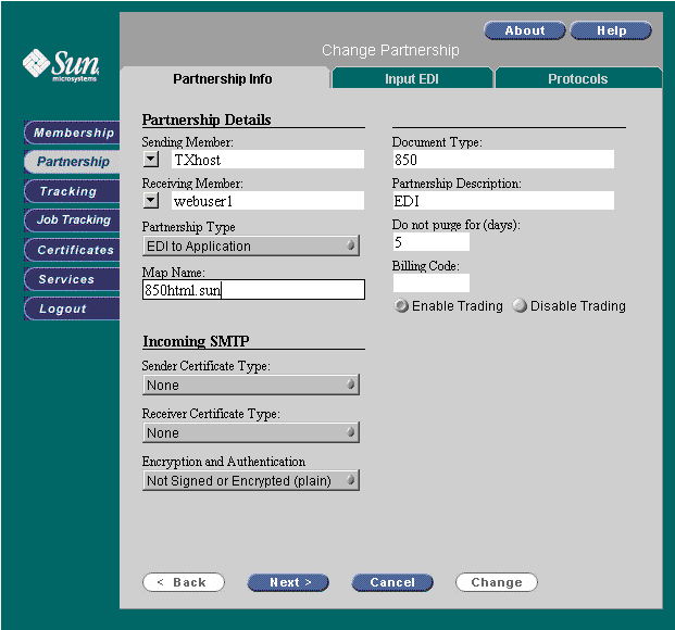

Partnership Setup A
The partnership setup includes a number of screens corresponding to the different tabs required to configure the partnership.
Partnership Info     Figure 5-2 and the accompanying Table 5-3 show how to set up the Partnership Info tab for this exchange.
Figure 5-2  Partnership Info for TXhost Sending Purchase Order to webuser1
Table 5-3  Partnership Information for TXhost Sending Purchase Order to webuser1
Field
Value
Explanation
Partnership Details
Sending Member
TXhost
EDI-enabled ECXpert partner sending the purchase order
Receiving Member
webuser1
Browser-based ECXpert partner receiving the purchase order by way of TradingXpert
Document Type
850
ANSI X.12 doc type for purchase order
Partnership Type
EDI to Application
The document will be picked up by the TradingXpert application
Map Name
850html.sun (Solaris)
or
850html.mmc (Windows)
The map file used to convert inbound 850 documents to TradingXpert format (EDI to Application)
Incoming SMTP
[Parameters]
Default
Not needed for this document exchange.

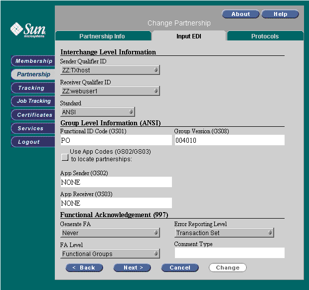

Input EDI     Figure 5-3 and the accompanying Table 5-4 show how to set up the Input EDI tab for this exchange.
Figure 5-3  Input EDI for TXhost Sending Purchase Order to webuser1
Table 5-4  Input EDI Information for TXhost Sending Purchase Order to webuser1
Field
Value
Explanation
Interchange Level Information
Sender Qualifier ID
ZZ:TXhost
EDI trading address
Receiver Qualifier ID
ZZ:webuser1
EDI trading address
Standard
ANSI
Using ANSI X.12 doc type
Group Level Information
Functional ID Code
PO
Corresponds to purchase order
Group Version
004010
Functional Acknowledgments
[Parameters]
Default
Not needed.

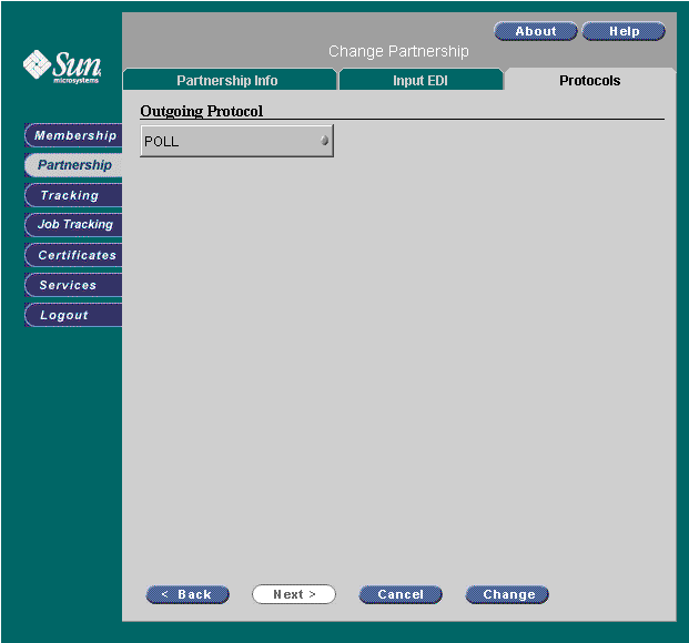

Protocols     Figure 5-4 and the accompanying Table 5-5 show how to set up the Protocols tab for this exchange.
Figure 5-4  Protocols for TXhost Sending Purchase Order to webuser1
Table 5-5  Protocols for TXhost Sending Purchase Order to webuser1
Field
Value
Explanation
Outgoing Protocol
Drop-down protocol list
POLL
TradingXpert will retrieve the document, as opposed to its being sent to the Gateway

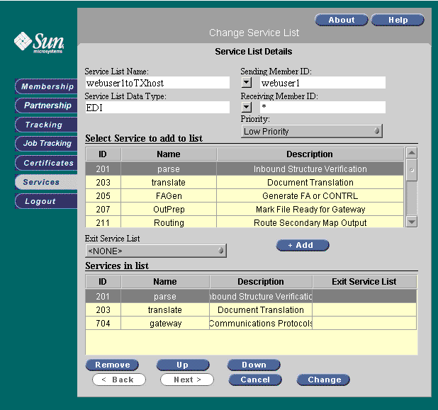

Figure 5-5 and the accompanying Table 5-6 show how to set up a service list for this exchange.
Figure 5-5  Service List for webuser1 Sending Invoices to TXhost
Table 5-6  Service List details for webuser1 Sending Invoices to TXhost
Field
Value
Explanation
EDI
Sending Member ID
webuser1
Receiving Member ID
Applies to any receiving member
Parse
Breaks incoming document into its constituent parts.
Translate
Gateway
Uses Gateway to send document to receiving member (TXhost)

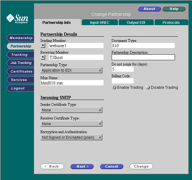

Partnership Info     Figure 5-6 and the accompanying Table 5-7 show how to set up the Partnership Info tab for this exchange.
Figure 5-6  Partnership Info for webuser1 Sending Invoices to TXhost
Table 5-7  Partnership Information for webuser1 Sending Invoices to TXhost
Field
Value
Explanation
Partnership Details
Sending Member
webuser1
Browser-based ECXpert partner sending the invoice by way of TradingXpert
Receiving Member
TXhost
EDI-enabled ECXpert partner receiving the invoice
Document Type
810
ANSI X.12 doc type for invoice
Partnership Type
Application to
EDI
The document will be sent by the TradingXpert application to ECXpert
Map Name
html810.sun (Solaris)
or
html810.mmc (Windows)
The map file used to convert TradingXpert format to outbound 810 documents (Application to EDI)
Incoming SMTP
[Parameters]
Default

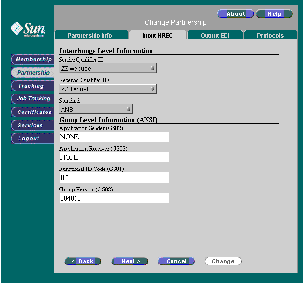

Input HREC     Figure 5-7 and the accompanying Table 5-8 show how to set up the Input HEC tab for this exchange.
Figure 5-7  Input HREC for webuser1 Sending Invoices to TXhost
Table 5-8  Input HREC for webuser1 Sending Invoices to TXhost
Field
Value
Explanation
Sender Qualifier ID
ZZ:webuser1
EDI trading address
ZZ:TXhost
EDI trading address
Standard
ANSI
Application Sender
NONE
Application Receiver
NONE
Functional ID Code
IN
Corresponds to invoice
Group Version
004010

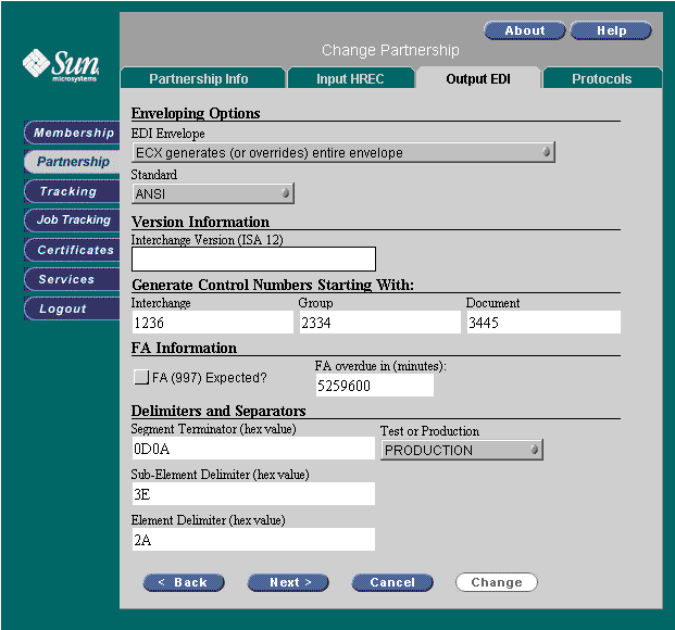

Output EDI     Figure 5-8 and the accompanying Table 5-9 show how to set up the Output EDI tab for this exchange.
Figure 5-8  Output EDI for webuser1 Sending Invoices to TXhost
Table 5-9  Output EDI for webuser1 Sending Invoices to TXhost
Field
Value
Explanation
Enveloping Options
EDI Envelope
ECXpert generates (or overrides) entire envelope
Standard
ANSI
[Remaining parameters]
Default

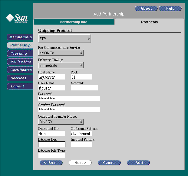

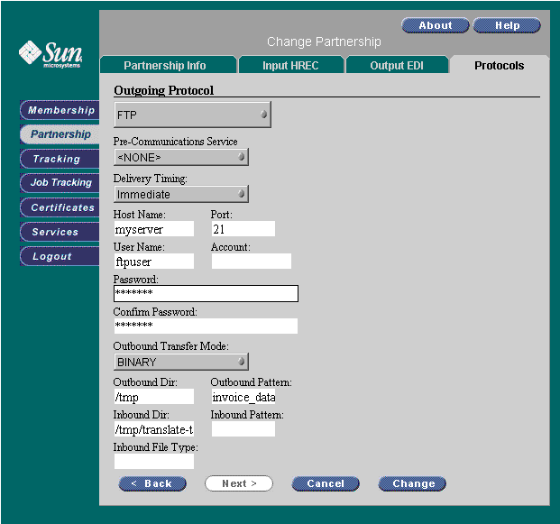

Protocols     Figure 5-9 and the accompanying Table 5-10 show how to set up the Protocols tab for this exchange.
Figure 5-9  Protocols for webuser1 Sending Invoices to TXhost
Table 5-10  Protocols for webuser1 Sending Invoices to TXhost
Field
Value
Explanation
Outgoing Protocol
Pull-down protocol list
FTP
Precommunications Service
<NONE>
Delivery Timing
Immediate
Host Name
myserver
The name of the machine on which the invoice will be deposited
Port
21
The ftp port of the machine on which the invoice will be deposited, typically 21
Username
ftpuser
The username you will use to log on to the machine on which the invoice will be deposited
Password
The password for the user you entered in the Username field
Confirm Password
The password for the user you entered in the Username field, entered a second time for confirmation
Outbound Transfer Mode
Binary
Outbound Dir
/tmp (Solaris)
D:\temp (Windows)
The directory where the file will be deposited
Outbound Pattern
invoice_data
Default

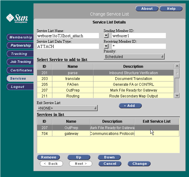

Exchange C: webuser1 Sends File Attachment to TXhost
This section explains how to set up the service list and partnership needed for webuser1 to send file attachments to TXhost.
Service List Setup C
Figure 5-10 and the accompanying Table 5-11 show how to set up a service list for this exchange.
Figure 5-10  Service List for webuser1 Sending Attachments to TXhost
Table 5-11  Service List details for webuser1 Sending Attachments to TXhost
Field
Value
Explanation
ATTACH
Sending Member ID
webuser1
Receiving Member ID
Applies to any receiving partner
OutPrep
Marks files that do not need processing as ready for the Gateway service.
Gateway

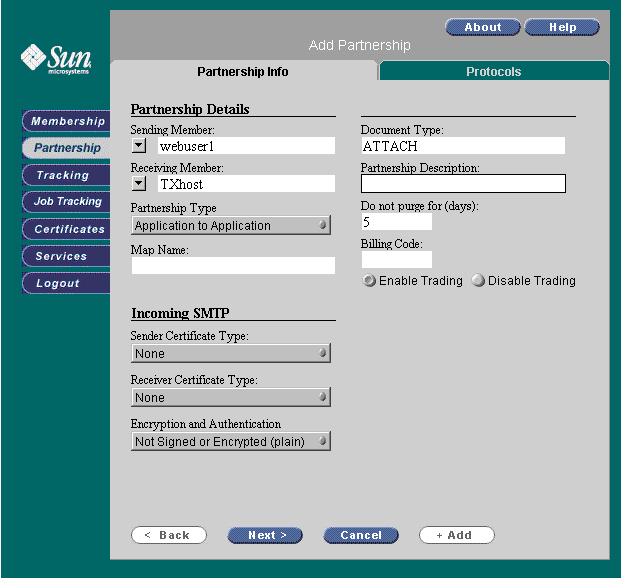

Partnership Info     Figure 5-11 and the accompanying Table 5-12 show how to set up the Partnership Info tab for this exchange.
Figure 5-11  Partnership Info for webuser1 Sending Attachments to TXhost
Table 5-12  Partnership Information for webuser1 Sending Attachments to TXhost
Field
Value
Explanation
Partnership Details
Sending Member
webuser1
Browser-based ECXpert partner sending the attachment by way of TradingXpert
Receiving Member
TXhost
EDI-enabled ECXpert partner receiving the attachment
Document Type
ATTACH
Partnership Type
Application to
Application
Neither partner is EDI-enabled.
Map Name
No map file is needed.
Incoming SMTP
[Parameters]
Default
Protocols     Figure 5-12 and the accompanying Table 5-13 show how to set up the Protocols tab for this exchange.
Figure 5-12  Protocols for webuser1 Sending Attachments to TXhost
Table 5-13  Protocols for webuser1 Sending Attachments to TXhost
Field
Value
Explanation
Outgoing Protocol
FTP
<NONE>
Delivery Timing
Immediate
Host Name
myserver
Port
21
Username
ftpuser
Password
Confirm Password
Binary
Outbound Dir
/tmp
Outbound Pattern
Default
Note
You should also go to the ECXpert Server Administration interface to check that the ECXpert FTP server is on. For instructions, see your ECXpert Administrator’s Guide, Chapter 3.

      1. Select the partnership of Doc Type INVOIC.
      2. Select the Output EDI tab.
      3. Change the Standard from ANSI to EDIFACT.
      4. In the Version Number field, type “D
      5. In the Release Number field, type “97A
      6. Save the partnership.

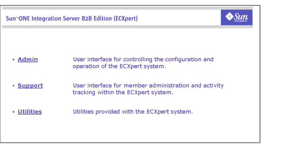

    The ECXpert Home Page (Figure 5-13) appears.

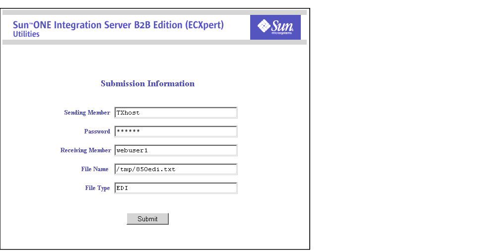

  5. Click the Document Submission Form link.
  6. The Document Submission Form (Figure 5-15) appears.
    Figure 5-15  Document Submission Form
  7. Enter parameters for the submit command.
  8. Refer to Table 5-14 for detailed information about the parameters.
    Table 5-14  Parameters for TXhost Sending Purchase Order to webuser1
    Parameter
    Value
    Explanation
    Sending Member
    TXhost
    The sending member’s ID
    Password
    Password for the sending member
    Receiving Member
    webuser1
    The receiving member’s ID
    File Name
    850edi.txt
    The name of the EDI purchase order file to be submitted to TradingXpert. The demo file, which is included in the /maps_etc/sampledata directory, is named 850edi.txt.
    File Type
    EDI
    The type of data file being submitted to ECXpert
  9. Click the Submit button.
  10. A message appears providing feedback on the command. If any errors are encountered they are displayed first.

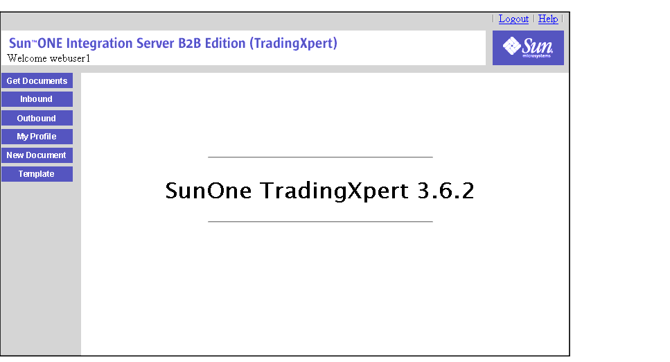

  12. Open the TradingXpert user interface by entering the following URL in your browser:
  13. http://TradingXpert_hostname:port/TX
    where hostname is the name of the host machine where TradingXpert is installed, and port is the port number TradingXpert is using.

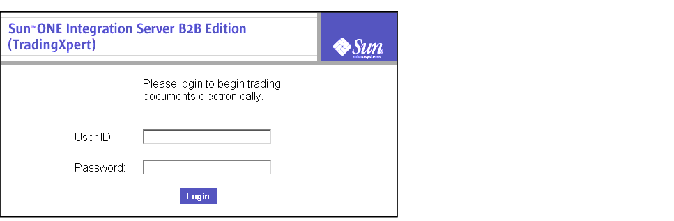

    The TradingXpert Login Screen (Figure 5-16) appears.
    Figure 5-16  TradingXpert Login Screen
  14. Log in to TradingXpert as webuser1.
  15. Use the User ID webuser1 and the Password webuser1 and click Login.
    The Trade Center Screen (Figure 5-17) appears.
    Figure 5-17  Trade Center Screen

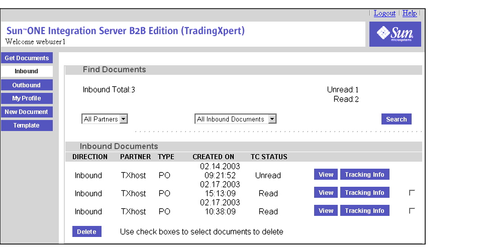

    1. Click the Inbound icon to view incoming documents.
    2. The Inbound Documents Screen (Figure 5-18) appears.
      Figure 5-18  Inbound Documents Screen
    3. Search for all incoming documents from TXhost.
    4. Find the purchase order just sent from TXhost and click View.
    5. The Purchase Order Document (Figure 5-19) is displayed.

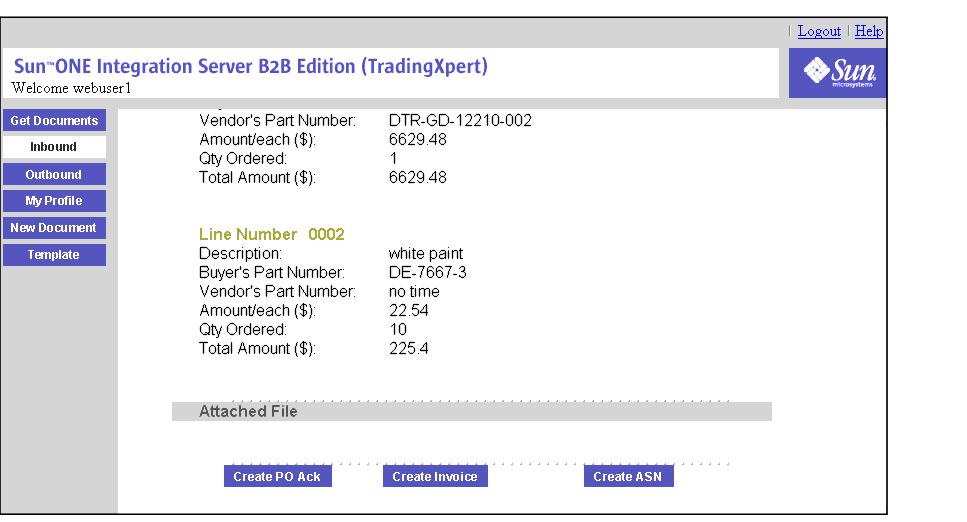

      Figure 5-19  Purchase Order Document

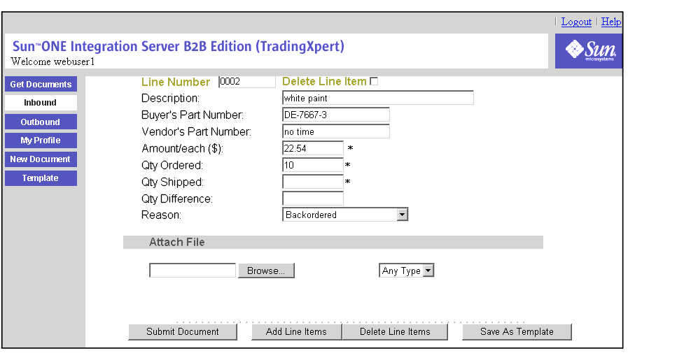

  17. Create an invoice from the purchase order.
  18. At the bottom of the purchase order, click the Create Invoice button.
    An invoice form (Figure 5-20) will appear; the data fields will be pre-filled with data from the purchase order.
    Figure 5-20  Attachment Options at Bottom of an Invoice
  19. Attach a file to the invoice.
  20. At the bottom of the invoice screen is an Attach File section. Attach any file on your hard drive by first either entering the full path of the file or clicking Browse to select a file, and then selecting Any Type from the drop-down menu.
  21. Submit the invoice with attachment to TXhost by clicking the Submit Document button.
  22. A screen will appear confirming that the document was submitted successfully.
