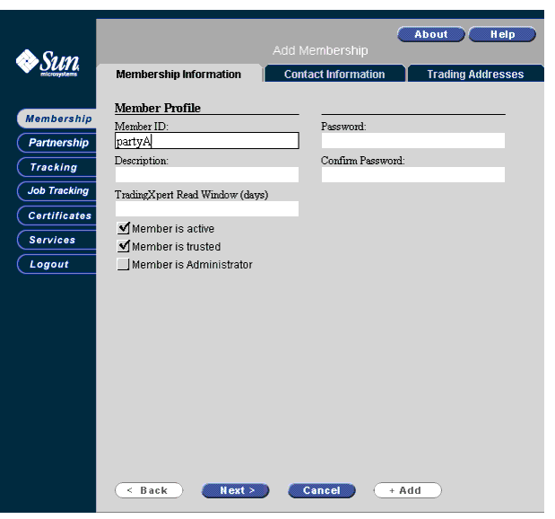

- Open the Support interface to ECXpert, and select Membership.
- Select Add and specify the fields in Table 2-1, as shown in Figure 2-1:
Figure 2-1 Add a Member Screen
- Select Next twice, bypassing the Contact Information page. These fields are not important for this test.

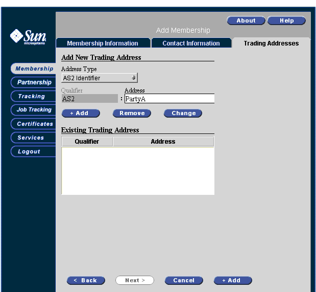

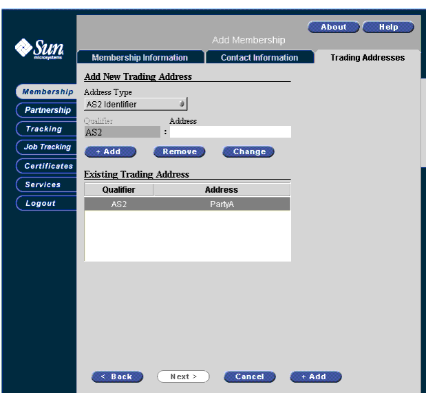

- Specify information for the Trading Address as shown in the following table and Figure 2-2.
Figure 2-2 Trading Address Screen
- Click Change to modify the member with the new trading address. This results in the address being added to the Existing Trading Address list, as shown in Figure 2-3.
Figure 2-3 Trading Address Added Screen

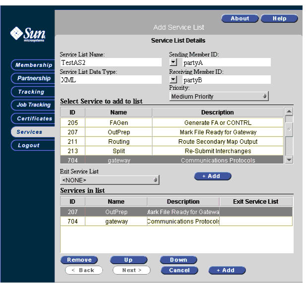

To Create a Service List
- From the Support interface, select Services.
- Select Add and specify the following field values, as shown in Figure 2-4:
Figure 2-4 Service List Screen
- Click Add to add the Service List.

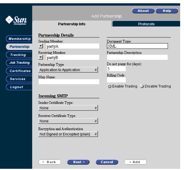

To Create a Partnership
- From the Support interface, select Partnership.
- Select Add and specify the following field values:
Figure 2-5 Add Partnership Screen

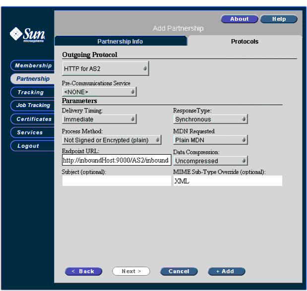

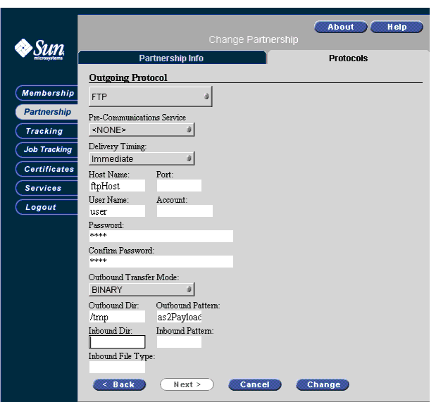

- Select Next and specify field values for Protocols. In Table 2-6, the first line in each Value cell gives a specific field value for the example. A general definition of the field is also given.
Figure 2-6 shows the outgoing protocol specifications for this example.
If you need to use security or reliability, you must create certificates as described in Chapter 3, "Creating Certificates for AS2 Messaging".
Figure 2-6 Outgoing Protocol Screen
