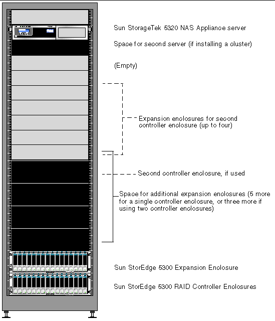

You must plan your installation carefully.

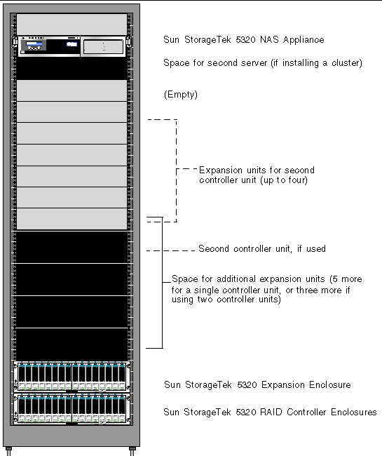

The controller and expansion must be installed in the cabinet as follows, always starting from the bottom up. Starting at the bottom distributes the weight correctly in the cabinet.
FIGURE 2-1 shows the cabinet with a single controller unit, single expansion unit, room for additional storage, and single server installed at the top.
To Install the System With a Single Controller Unit |
1. Mount the controller unit in the bottom of the cabinet.
2. Mount any expansion unit (maximum six) from the bottom up.
The first expansion unit above the controller unit is EU 1, then EU 2, and so on.
3. Mount the Sun StorageTek 5320 NAS Appliance 2 U from the top of the cabinet.
If you are installing a cluster, install the servers as follows:
a. Sun StorageTek 5320 NAS Appliance H1 (software serial number ending "-H1") at the top.
The software serial number is located at the front of the server, below the LCD display. It is also printed on the Customer Information Sheet (CIS).
b. Sun StorageTek 5320 NAS Appliance H2 (software serial number ending "-H2") below server H1.
To Install the System With Two Controller Units |
2. Mount any expansion units (maximum four) from the bottom up, and be sure to leave space for the maximum four EUs if you do not install them at this time.
3. Mount the second controller unit.
4. Mount any expansion units (maximum four) for the second controller unit, and be sure to leave space for the maximum four expansion units if you do not install them at this time.
5. Mount the Sun StorageTek 5320 NAS Appliance 2 U from the top of the cabinet.

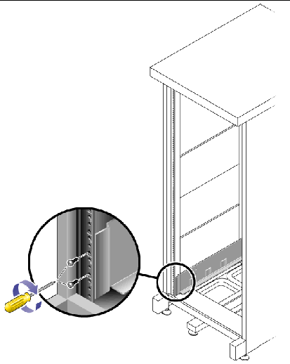

1. Position the front of the left rail behind the left front cabinet rail (FIGURE 2-2).
2. Use the No. 2 Phillips screwdriver to insert and tighten two 8-32 screws to secure the left rail to the front of the cabinet (FIGURE 2-3).
Each array requires three standard mounting units (3RU) of vertical space in the cabinet. Each standard mounting unit (U) has three mounting holes in the left and right cabinet rails. Insert the screws into the lowest holes in the top two mounting units of the 3RU slot in which the tray is to be mounted.
These screws pass through the cabinet rail holes and screw into threaded holes in the left rail.

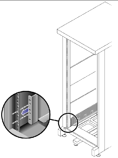

4. At the back of the cabinet, adjust the length of the left rail as needed to fit the cabinet, and position the rail flange over the face of the cabinet rail (FIGURE 2-4).
5. Align the rail flange so that the mounting holes correspond to those at the front of the cabinet.
6. Use the No. 3 Phillips screwdriver to insert and tighten four metric M6 screws (two per side) at the back of the rail (FIGURE 2-5).
7. Repeat Step 4, Step 5, and Step 6 for the right rail.

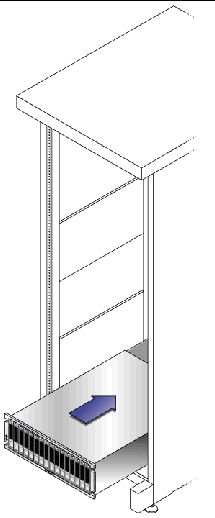

Install the controller unit in the first empty 3RU slot at the bottom of the cabinet. If you are installing expansion units, continue installing the units from the bottom up.
1. Using two people, one at each side of the unit, carefully lift and rest the unit on the bottom ledge of the left and right rails (FIGURE 2-7).
Caution - Use care to avoid injury. A unit can weigh up to 95 pounds (45 kg). |
2. Carefully slide the unit into the cabinet until the front flanges of the unit touch the vertical face of the cabinet (FIGURE 2-8).
3. Use the No. 3 Phillips screwdriver to install and tighten four M6 screws (two per side) to secure the tray to the front of the cabinet (FIGURE 2-9).
4. Install and tighten two 6-32 screws (one per side) at the back of the tray, to secure the back of the tray to the cabinet (FIGURE 2-10).
Note - The two upper holes on the back of the tray are not used. |

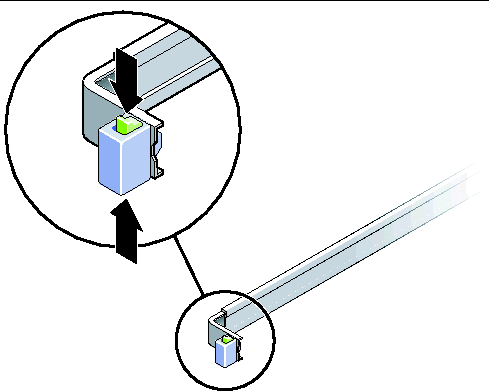

1. Pull both mounting brackets completely out of their respective slide rails:
a. Simultaneously press and hold the upper and lower lock buttons of the slide rail lock (FIGURE 2-11).
b. Pull the mounting bracket out until it locks in the extended position.
c. Slide the mounting bracket release button in the direction shown in FIGURE 2-12, and then slide the mounting bracket out of the slide rail.

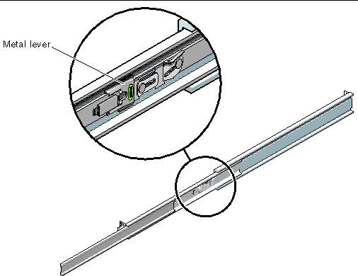

d. Press the metal lever (labeled Push) on the middle section (FIGURE 2-13) of the sliding rail, and then push the middle section back into the rack.

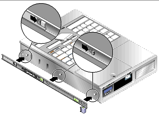

a. Position the mounting bracket against the server chassis (FIGURE 2-14) so that the slide rail lock is at the front and the three keyed openings on the mounting bracket are aligned with the three locating pins on the side of the chassis.
b. With the heads of the three locating pins protruding though the three keyed openings in the mounting bracket, pull the mounting bracket toward the front of the chassis until the bracket locks into place with an audible click.
c. Verify that all three locating pins are trapped in the keyed openings and that the back locating pin has engaged the mounting bracket lock, as shown in the right side of FIGURE 2-14.

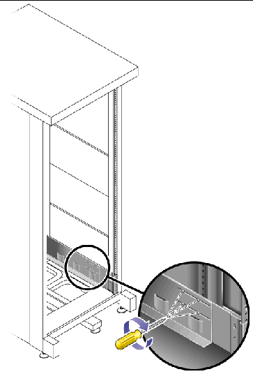

a. Loosely attach the front of a slide rail to the right front rack post (FIGURE 2-15) using two screws.
b. Adjust the length of the slide rail by sliding the back mounting flange to reach the outside edge of the back rack post.
c. Loosely attach the back of the slide rail to the back rack post with two screws.

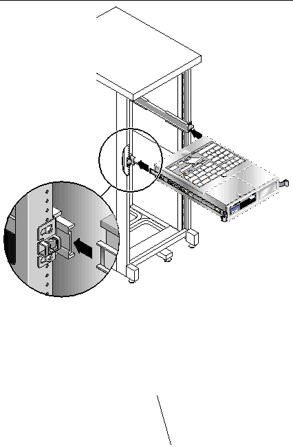

10. Insert the ends of the mounting brackets into the sliding rails (FIGURE 2-17).
Caution - The server weighs approximately 52 pounds (24 kg). Two people are required to lift and mount the system into a rack enclosure when using the procedures in this chapter. |
11. Simultaneously release the rail locks on each side of the sliding rails, and guide the chassis into the rack.
Caution - Verify that the server is securely mounted in the rack, and that the slide rails are locked to the mounting brackets, before continuing. |

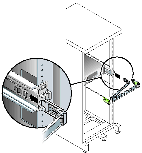

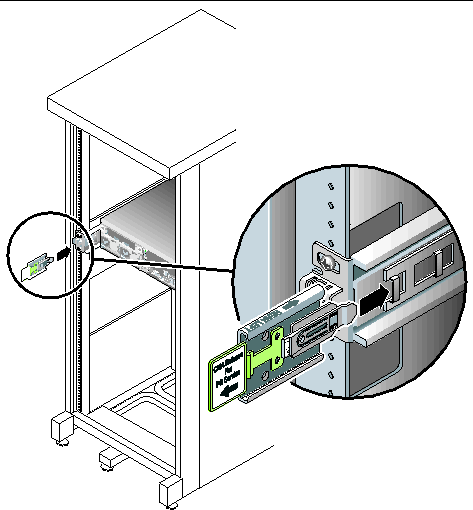

The cable management assembly (CMA) clips into the ends of the left and right sliding rail assemblies. No screws are necessary for mounting the CMA.
Caution - Support the CMA during this installation. Do not allow the assembly to hang by its own weight until it is secured by all three attachment points. |
1. At the back of the rack, plug the CMA rail extension into the end of the left sliding rail assembly (FIGURE 2-18).
The tab at the front of the rail extension clicks into place.
The right sides of the two CMA arms have hinged extensions. On the manufacturer's instruction sheet, the smaller extension is called the CMA Connector for Inner Member. It attaches to the right mounting bracket. The larger extension is called the CMA Connector for Outer Member, and attaches to the right sliding rail.
2. Insert the smaller extension into the clip located at the end of the mounting bracket (FIGURE 2-19).
3. Insert the larger extension into the end of the right sliding rail (FIGURE 2-20).
4. Insert the hinged plastic connector at the left side of the CMA fully into the CMA rail extension (FIGURE 2-21).
The plastic tab on the CMA rail extension locks the hinged plastic connector in place.

2. Unlock the slide lock buttons (FIGURE 2-22) at the right and left sides of the server chassis, and slowly pull the server out of the rack until the slide rails reach their stops.

5. When the server is fully extended out, release the slide rail lever stops (FIGURE 2-23).
Push both levers simultaneously and slide the server back into the rack.
