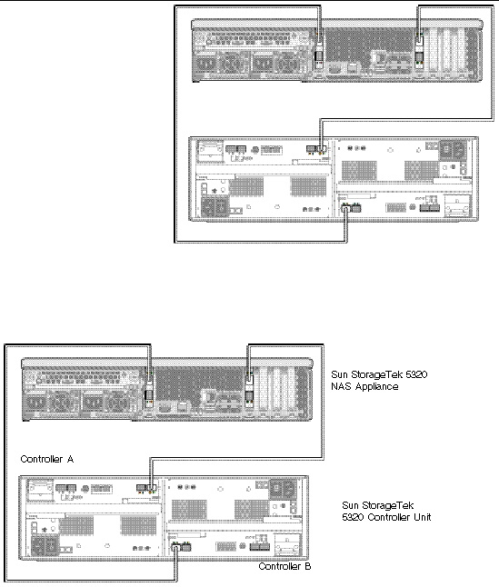

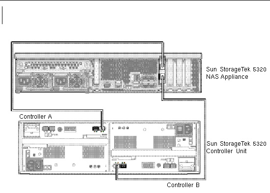

Use the instructions in this section if you are connecting one controller unit to the Sun StorageTek 5320 NAS Appliance.
For a Sun StorageTek 5320 NAS Appliance with one dual port FC HBA card in PCI slot 1 (FIGURE 3-2):
1. Connect the HBA port 1 (top port) on the Sun StorageTek 5320 NAS Appliance to the Controller A Ch 1 port.
2. Connect the HBA port 2 (bottom port) on the Sun StorageTek 5320 NAS Appliance to the Controller B Ch 1 port.
| Note - The Ch 2 ports on controller A and controller B remain empty. |
FIGURE 3-2 Connecting the Sun StorageTek 5320 NAS Appliance to the Controller Unit
| Note - The preceding figure is for illustrative purposes only. The units have more space between them when they are installed in a cabinet. |
Use the instructions in this section if you are connecting a Sun StorageTek 5320 NAS Appliance with two dual port FC HBA cards in PCI slots 1 and 0.
1. Connect the HBA port 1 (top port) of the first HBA card (PCI1) to the Controller A Ch 1 port.
2. Connect the HBA port 1 (top port) of the second HBA card (PCI0) to the Controller B Ch 1 port.
FIGURE 3-3 Connecting Two HBA Cards to the Controller Unit

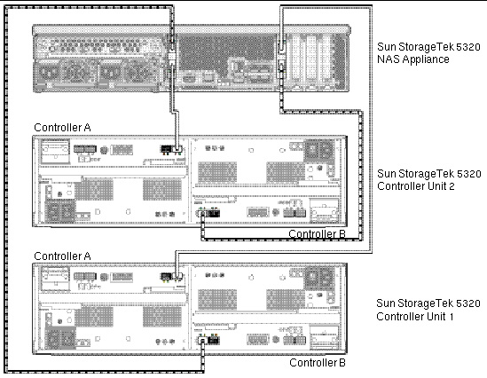

Use the instructions in this section if you are connecting two controller units to the Sun StorageTek 5320 NAS Appliance.
| Note - The Sun StorageTek 5320 NAS Appliance must have two HBA cards (one in PCI slot 1 and one in PCI slot 0) to connect to two controller units. |
1. Connect the HBA port 1 (top port) of the first HBA card (PCI1) to the Controller A Ch 1 port on the first (bottom) controller unit (Unit 1).
2. Connect the HBA port 1 of the second HBA card (PCI0) to the Controller B Ch 1 port on Unit 1.
3. Connect the HBA port 2 of the first HBA card to the Controller B Ch 1 port on the second (top) controller unit (Unit 2).
4. Connect the HBA port 2 of the second HBA card to the Controller A Ch 1 port on Unit 2.
FIGURE 3-4 Connecting the Sun StorageTek 5320 NAS Appliance to Two Controller Units

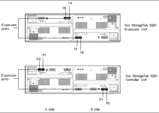

A controller unit uses Controller A and Controller B expansion ports (P1 and P2) to connect to FC-AL ports (1A and 1B) at the back of an expansion unit. Refer to FIGURE 3-5 for port locations.
FIGURE 3-5 Controller Unit and Expansion Unit Ports

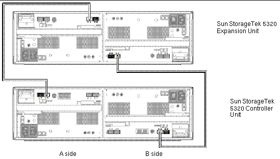

To connect a controller unit and one expansion unit, two 2-meter fiber cables are required. Refer to FIGURE 3-6.
1. Connect one cable between the A side expansion port P1 of the controller unit and the A side port 1B of the expansion unit.
2. Connect one fiber cable between the B side expansion port P1 of the controller unit and the B side port 1B of the expansion unit.
| Note - The other drive ports in the units remain empty. |
FIGURE 3-6 Controller Unit and One Expansion Unit Cable Interconnection

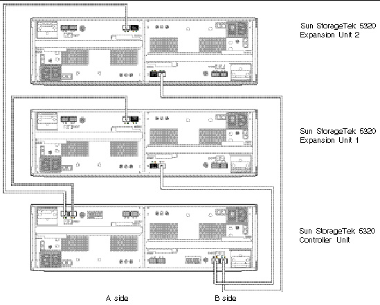

To connect a controller unit and two expansion units, four 2-meter fiber cables are required. Refer to FIGURE 3-7.
1. Connect one fiber cable between the A side expansion port P1 of the controller unit and the A side port 1B of expansion unit 1.
2. Connect one fiber cable between the A side expansion port P2 of the controller unit and the A side port 1B of expansion unit 2.
3. Connect one fiber cable between the B side expansion port P1 of the controller unit and the B side port 1B of expansion unit 1.
4. Connect one fiber cable between the B side expansion port P2 of the controller unit and the B side port 1B of expansion unit 2.
FIGURE 3-7 Controller Unit and Two Expansion Units Cable Interconnection

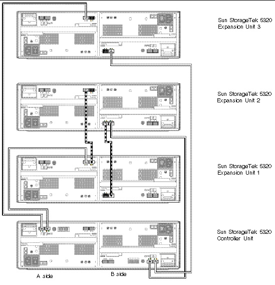

To connect a controller unit and three expansion units, six 2-meter fiber cables are required. Refer to FIGURE 3-8.
2. Connect one fiber cable between the A side expansion port P2 of the controller unit and the A side port 1B of expansion unit 3.
3. Connect one fiber cable between the A side port 1A of expansion unit 1 and the A side port 1B of expansion unit 2.
4. Connect one fiber cable between the B side expansion port P1 of the controller unit and the B side port 1B of expansion unit 2.
5. Connect one fiber cable between the B side expansion port P2 of the controller unit and the B side port 1B of expansion unit 3.
6. Connect one fiber cable between the B side port 1B of expansion unit 1 and the B side port 1A of expansion unit 2.
FIGURE 3-8 Controller Unit and Three Expansion Units Cable Interconnection

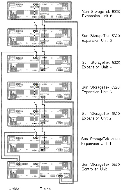

To connect a controller unit and six expansion units, twelve 2-meter fiber cables are required. Refer to FIGURE 3-9.
2. Connect one fiber cable between the A side expansion port P2 of the controller unit and the A side port 1B of expansion unit 4.
4. Connect one fiber cable between the A side port 1A of expansion unit 2 and the A side port 1B of expansion unit 3.
5. Connect one fiber cable between the A side port 1A of expansion unit 4 and the A side port 1B of expansion unit 5.
6. Connect one fiber cable between the A side port 1A of expansion unit 5 and the A side port 1B of expansion unit 6.
7. Connect one fiber cable between the B side expansion port P1 of the controller unit and the B side port 1B of expansion unit 3.
8. Connect one fiber cable between the B side expansion port P2 of the controller unit and the B side port 1B of expansion unit 6.
9. Connect one fiber cable between the B side port 1B of expansion unit 1 and the B side port 1A of expansion unit 2.
10. Connect one fiber cable between the B side port 1B of expansion unit 2 and the B side port 1A of expansion unit 3.
11. Connect one fiber cable between the B side port 1B of expansion unit 4 and the B side port 1A of expansion unit 5.
12. Connect one fiber cable between the B side port 1B of expansion unit 5 and the B side port 1A of expansion unit 6.
FIGURE 3-9 Controller Unit and Six Expansion Units Cable Interconnection

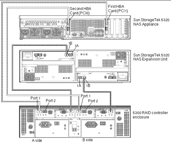

Use the following procedure to cable a new single expansion unit to a 5300 RAID EU controller enclosure. Refer to FIGURE 3-10 for port locations.
1. Connect one fiber cable between the A side expansion port 1 of the controller enclosure and the A side port 1B of the expansion unit.
2. Connect one fiber cable between the B side expansion port 1 of the controller enclosure and the B side port 1B of the expansion unit.
FIGURE 3-10 Controller Enclosure with FC Drives with One Expansion Unit Cable Interconnection

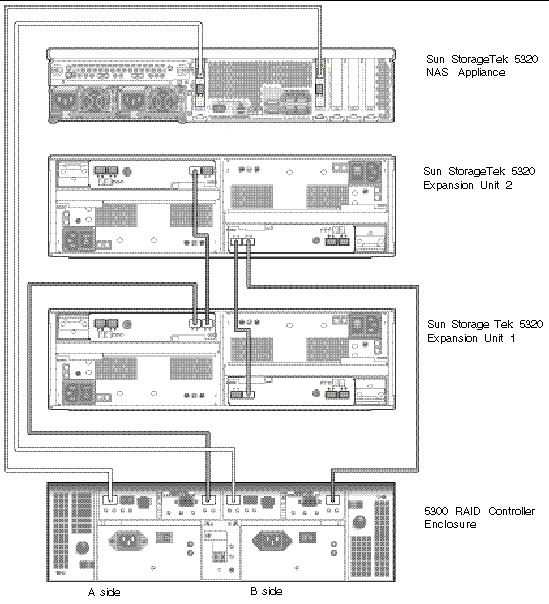

Cabling two new expansion units to a 5300 RAID EU controller enclosure differs from cabling a new expansion unit to a new 5320 controller units in that 5300 controller enclosures have only one SFP port on each side of the controller instead of two.
To connect a controller unit and two expansion units, four 2-meter fiber cables are required. Refer to FIGURE 3-11.
1. Connect one fiber cable between the A side expansion port of the controller enclosure and the A side port 1B of expansion unit 1.
2. Connect one fiber cable between the A side port 1A of expansion unit 1 and the A side port 1B of expansion unit 2.
3. Connect one fiber cable between the B side expansion port of the controller enclosure and the B side port 1B of expansion unit 2.
4. Connect one fiber cable between the B side port 1A of expansion unit 2 and the B side port 1B of expansion unit 1.
FIGURE 3-11 Controller Enclosure with FC Drives with Two Expansion Units

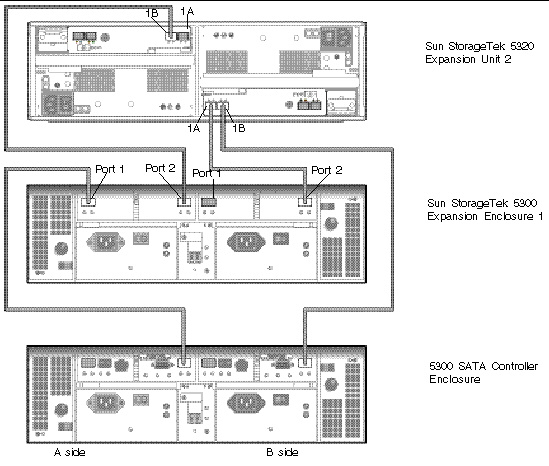

If you have a 5300 controller enclosure with SATA drives, use the following procedure to connect a new 5320 expansion unit to the system. Refer to FIGURE 3-12 for port locations.
1. Connect one fiber cable between the A side expansion port of the controller enclosure and the A side port 1 of expansion enclosure 1.
2. Connect one fiber cable between the A side port 2 of expansion enclosure 1 and the A side port 1B of expansion unit 2.
4. Connect one fiber cable between the B side port 1A of expansion unit 2 and the B side port 2 of expansion enclosure 1.
FIGURE 3-12 Controller Enclosure with One Expansion Unit Cable Interconnection with SATA Drives

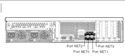

Use the following procedures to connect the Sun StorageTek 5320 NAS Appliance to the network. The available network connectors depend on your system configuration: Fast Ethernet or optical Gigabit Ethernet. Each configuration is described in the following sections.
Refer to FIGURE 3-13 for NIC port locations.
1. To connect the Sun StorageTek 5320 NAS Appliance to a 100BASE-T Fast Ethernet network or to a 1000BASE-T Gigabit Ethernet network, connect an RJ-45 unshielded twisted-pair cable from your local area network (LAN) to port NET0 on the back of the Sun StorageTek 5320 NAS Appliance.
2. For additional LAN connections, continue to connect in order: NET1, NET2, and NET3.
FIGURE 3-13 Connecting to a Fast Ethernet or Gigabit Ethernet Network

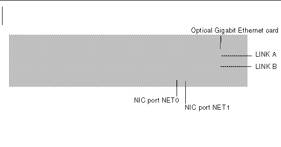

Refer to FIGURE 3-14 for NIC and optical Gigabit Ethernet port locations.
To connect the Sun StorageTek 5320 NAS Appliance to an optical Gigabit Ethernet network, you must have the optional add-in optical Gigabit Ethernet connections.
 Connect a fiber optic cable from the network to the top (LINK A) and connect another fiber optic cable from the network to the bottom (LINK B) optical Gigabit Ethernet connector on the back of the Sun StorageTek 5320 NAS Appliance.
FIGURE 3-14 Connecting to an Optical Gigabit Network

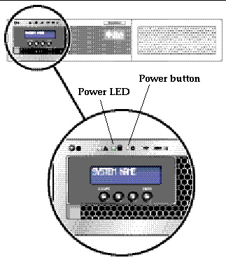

5. Using a pen tip or similar implement, press the recessed Power button (FIGURE 3-15).
FIGURE 3-15 Power Button and Front Panel Detail

7. Using a pen tip or similar implement, press the recessed Power button.
Refer to FIGURE 3-15 for a detailed view of the front panel.

If a DHCP server is not available, you must configure the IP address using the LCD panel.
1. Turn on the Sun StorageTek 5320 NAS Appliance and wait for the boot sequence to complete. The LCD panel displays the following:
A: Set Static IP B: Retry DHCP
2. Press the ENTER button once, and then select A. Network Config.
3. Select A to set Gateway, if needed.
4. Select B to set the port-emc1 that corresponds to NIC port NET0.
5. Enter the following values in the order listed:
To enter data, use the up and down arrow buttons to change digits and press the ENTER button to confirm each digit. The cursor moves to the next digit. Once the last digit is set, press the ENTER button again to proceed to the next network setting. After the broadcast address is set, press the ENTER button to return to the Network Config menu.
