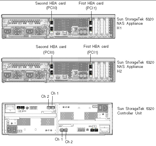

FIGURE 4-1 shows the ports of a cluster appliance and controller units.
FIGURE 4-1 Sun StorageTek 5320 NAS Cluster Appliance HBA Cards and Controller Unit Ports
| Note - HBA cards for storage connections are inserted only in PCI slot 1 (PCI1) and PCI slot 0 (PCI0) of each server in the Sun StorageTek 5320 NAS Cluster Appliance. |
This section contains details on the following:

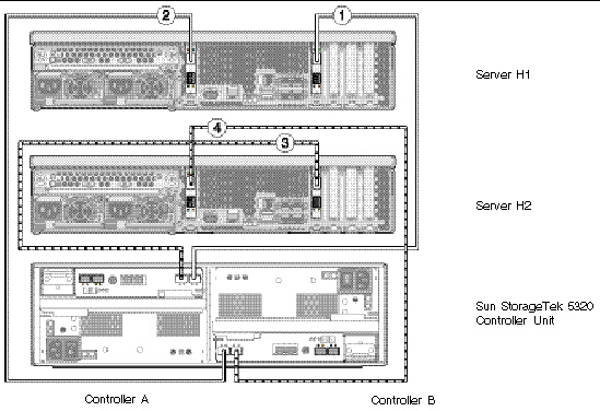

Use the instructions in this section if you are connecting one controller unit to the Sun StorageTek 5320 NAS Cluster Appliance.
1. Connect the HBA port 1 (top port) of the first HBA card (PCI1) on the Sun StorageTek 5320 NAS Cluster Appliance H1 to the Controller A Ch 1 port.
The H1 and H2 cluster pairs are identifed by the software serial number located on a printed label at the front of the server. (See Sun StorageTek 5320 NAS Appliance Server.)
2. Connect the HBA port 1 of the second HBA card (PCI0) on the cluster appliance H1 to the Controller B Ch 1 port.
3. Connect the HBA port 1 of the first HBA card on the cluster appliance H2 to the Controller A Ch 2 port.
4. Connect the HBA port 1 of the second HBA card on the cluster appliance H2 to the Controller B Ch 2 port.
FIGURE 4-2 Connecting Pairs of HBA Cards to One Controller Unit
| Note - The preceding figure is for illustrative purposes only. The units have more space between them when they are installed in a cabinet. |

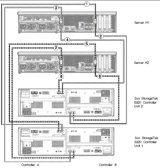

Use the instructions in this section and refer to FIGURE 4-3 if you are connecting two controller units to the Sun StorageTek 5320 NAS Cluster Appliance.
1. Connect the HBA port 1 (top port) of the first HBA card (PCI1) on the Sun StorageTek 5320 NAS Cluster Appliance server H1 to the Controller A Ch 1 port on the first (bottom) controller unit (Unit 1).
2. Connect the HBA port 2 of the first HBA card on the cluster appliance H1 to the Controller B Ch 1 port on the second (top) controller unit (Unit 2).
3. Connect the HBA port 1 of the second HBA card (PCI0) on the cluster appliance H1 to the Controller B Ch 1 port on Unit 1.
4. Connect the HBA port 2 of the second HBA card on the cluster appliance H1 to the Controller A Ch 1 port on Unit 2.
5. Connect HBA port 1 of the first HBA card (PCI1) on the cluster appliance H2 to the Controller A Ch 2 port on Unit 1.
6. Connect HBA port 2 of the first HBA card on the cluster appliance H2 to the Controller B Ch 2 port on Unit 2.
7. Connect HBA port 1 of the second HBA card (PCI0) on the cluster appliance H2 to the Controller B Ch 2 port on Unit 1.
8. Connect HBA port 2 of the second HBA card on the cluster appliance H2 to the Controller A Ch 2 port on Unit 2.
FIGURE 4-3 Connecting the Sun StorageTek 5320 NAS Cluster Appliance to Two Controller Units

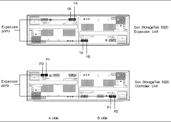

Each controller unit uses Controller A and Controller B expansion ports to connect to FC-AL ports at the back of an expansion unit (FIGURE 4-4).
FIGURE 4-4 Controller Unit and Expansion Unit Ports
The cabling differs depending on the number of expansion units you are connecting:

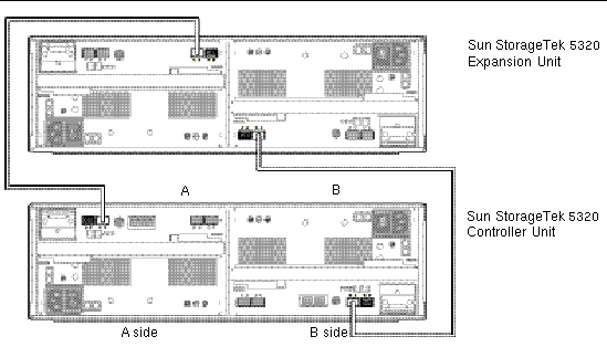

To connect a controller unit and one expansion unit, two 2-meter fiber cables are required. Refer to FIGURE 4-5.
1. Connect one fiber cable between the A side expansion port P1 of the controller unit and the A side port 1B of the expansion unit.
2. Connect one fiber cable between the B side expansion port P1 of the controller unit and the B side port 1B of the expansion unit.
| Note - The other drive ports in the units remain empty. |
FIGURE 4-5 Controller Unit and One Expansion Unit Cable Interconnection

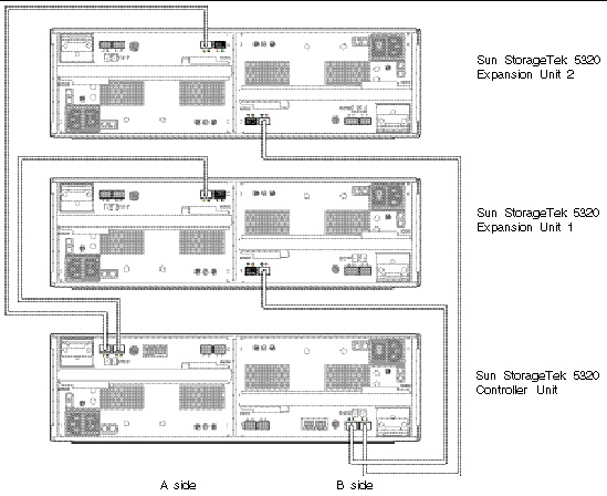

To connect a controller unit and two expansion units, four 2-meter fiber cables are required. Refer to FIGURE 4-6.
1. Connect one fiber cable between the A side expansion port P2 of the controller unit and the A side port 1B of expansion unit 2.
2. Connect one fiber cable between the A side expansion port P1 of the controller unit and the A side port 1B of expansion unit 1.
3. Connect one fiber cable between the B side expansion port P1 of the controller unit and the B side port 1B of expansion unit 1.
4. Connect one fiber cable between the B side expansion port P2 of the controller unit and the B side port 1B of expansion unit 2.
FIGURE 4-6 Controller Unit and Two Expansion Units Cable Interconnection

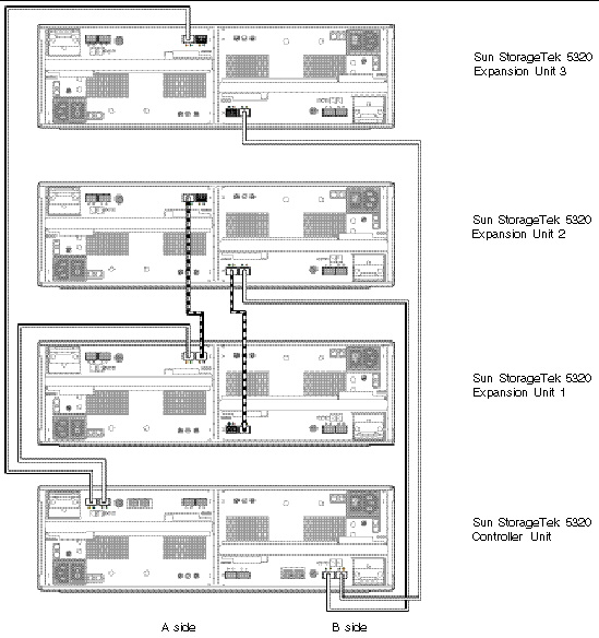

To connect a controller unit and three expansion units, six 2-meter fiber cables are required. Refer to FIGURE 4-7.
1. Connect one fiber cable between the A side expansion port P2 of the controller unit and the A side port 1B of expansion unit 3.
3. Connect one fiber cable between the A side port 1A of expansion unit 1 and the A side port 1B of expansion unit 2.
4. Connect one fiber cable between the B side expansion port P1 of the controller unit and the B side port 1B of expansion unit 2.
5. Connect one fiber cable between the B side expansion port P2 of the controller unit and the B side port 1B of expansion unit 3.
6. Connect one fiber cable between the B side port 1B of expansion unit 1 and the B side port 1A of expansion unit 2.
FIGURE 4-7 Controller Unit and Three Expansion Units Cable Interconnection

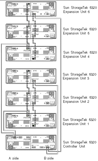

To connect a controller unit and six expansion units, twelve 2-meter fiber cables are required. Refer to FIGURE 4-8.
| Note - In a configuration with two controller units, a maximum of four expansion units can be attached to each controller unit. |
1. Connect one fiber cable between the A side expansion port P2 of the controller unit and the A side port 1B of expansion unit 4.
4. Connect one fiber cable between the A side port 1A of expansion unit 2 and the A side port 1B of expansion unit 3.
5. Connect one fiber cable between the A side port 1A of expansion unit 4 and the A side port 1B of expansion unit 5.
6. Connect one fiber cable between the A side port 1A of expansion unit 5 and the A side port 1B of expansion unit 6.
7. Connect one fiber cable between the B side expansion port P1 of the controller unit and the B side port 1B of expansion unit 3.
8. Connect one fiber cable between the B side expansion port P2 of the controller unit and the B side port 1B of expansion unit 6.
9. Connect one fiber cable between the B side port 1B of expansion unit 1 and the B side port 1A of expansion unit 2.
10. Connect one fiber cable between the B side port 1B of expansion unit 2 and the B side port 1A of expansion unit 3.
11. Connect one fiber cable between the B side port 1B of expansion unit 4 and the B side port 1A of expansion unit 5.
12. Connect one fiber cable between the B side port 1B of expansion unit 5 and the B side port 1A of expansion unit 6.
FIGURE 4-8 Controller Unit and Six Expansion Units Cable Interconnection

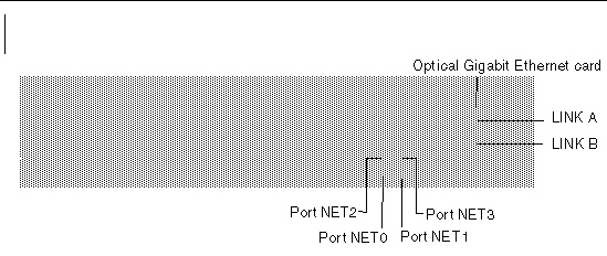

Each server in a Sun StorageTek 5320 NAS Cluster Appliance uses a dedicated Ethernet connection to communicate with its partner and perform periodic “health checks.” The port used for the health check connection is referred to as the heartbeat port. The NET0 Gigabit Ethernet port is used for the heartbeat.
The Sun StorageTek 5320 NAS Cluster Appliance is commonly configured with two Gigabit Ethernet cards. FIGURE 4-9 shows a single card configuration.
FIGURE 4-9 Connecting to an Optical Gigabit Ethernet Network
 Use a Cat5 Ethernet cable to connect the two servers’ NET0 heartbeat ports.
The appliance must be configured with a second optical Gigabit Ethernet card.
 Connect a fiber optic cable from the network to the top (LINK A) and connect another fiber optic cable from the network to the bottom (LINK B) optical Gigabit Ethernet connector on the back of each of the Sun StorageTek 5320 NAS Cluster Appliances.

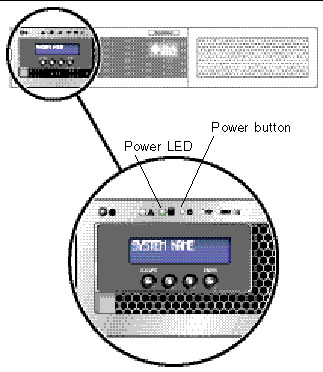

6. Power on server H1 (software serial number ending in “-H1”) by using a pen tip or similar implement to press the recessed Power button (FIGURE 4-10).
FIGURE 4-10 Power Button and Front Panel Detail
|   | Caution - Do not power up server H2 until directed in the instructions that follow. |

8. Power on server H1 (software serial number ending in “-H1”) by using a pen tip or similar implement to press the recessed Power button. Refer to FIGURE 4-10 for a detailed illustration of the front panel.
9. Verify that server H1 has finished booting up, as indicated by the LCD display “QUIET.”
10. To complete the power-on sequence, continue with the next section, Initial Sun StorageTek 5320 NAS Cluster Appliance Configuration.
