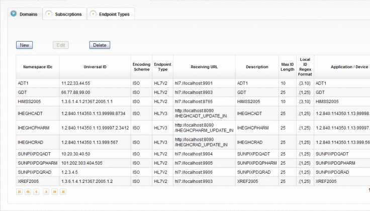

  1. On the PIX Console, click the Domain Manager tab.
    The Domain Manager page appears with a list of the currently defined domains.
    Figure shows the Domain Manager page of the PIX
Console

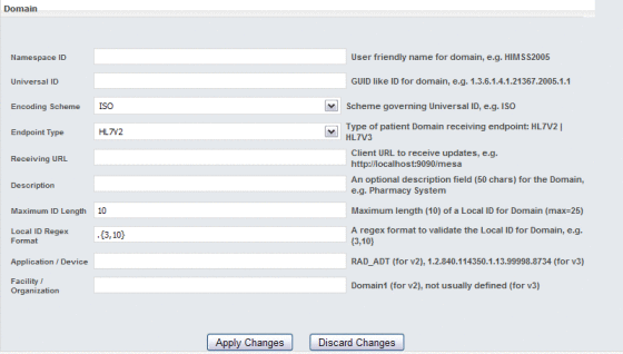

  2. To add a new domain, do the following:
    1. On the Domains tab, click New.
      A new page appears with fields you can edit.
      Figure shows the New Domain page.
    2. Enter information about the new domain.
      For more information about the fields on this page, see Domain Fields.
    3. When you have entered all information, click Apply Changes.
    4. On the Confirmation dialog box that appears, click OK.
      A new row appears in the domains list.

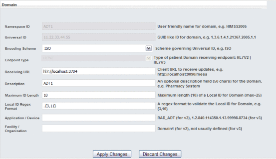

  3. To modify domain information, do the following:
    1. In the domains list on the Domains tab, select the domain to modify and then click Edit.
      The domain information appears on a new page appears with fields you can edit.
      Figure shows the Domain Manager in edit mode.
    2. Modify the value of any open field.
      You cannot modify the namespace ID, Universal ID, or endpoint type. For more information about the fields on this page, see Domain Fields.
    3. When you are done with your changes, click Apply Changes.
    4. On the confirmation dialog box that appears, click OK.
