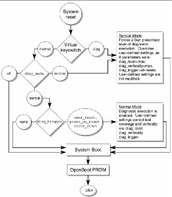

TABLE D-2 lists the ALOM CMT variables used to configure POST.
setkeyswitch[1] |
The system can power on and run POST (based on the other parameter settings). This parameter overrides all other commands. |
The system can power on and run POST, but no flash updates can be made. |
Runs POST with preset values for diag_level and diag_verbosity. |
If diag_mode = normal, runs all the minimum tests plus extensive CPU and memory tests. |
POST output displays functional tests with a banner and pinwheel. |
POST displays all test, informational, and some debugging messages. |
FIGURE D-1 Flowchart of ALOM CMT Variables for POST Configuration
