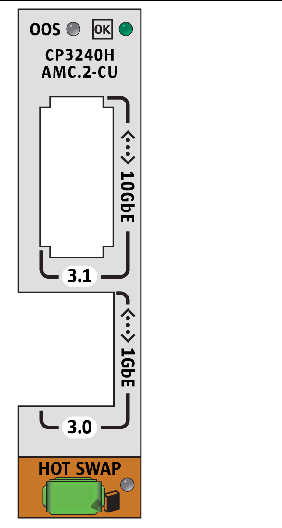

The following shows the faceplate of the Netra CP3240 AMC 10G-CU, which is a copper AMC (XCP3240H-AMC10G-CU-Z).
This connector provides outside-the-chassis access to the 10/100/1000BASE-T Ethernet AdvancedTCA Base Interface.
This connector provides outside-the-chassis access to the 10GBASE-CX4 Ethernet AdvancedTCA Fabric Interface. The CX4 port is only active on the middle AMC site.

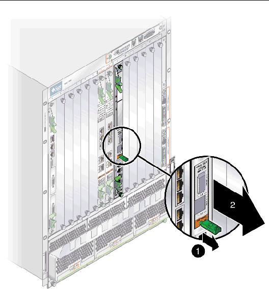

2. At the front of the Netra CP3240 switch, locate the AMC you want to remove.

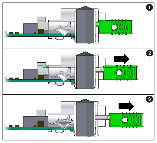

3. Initiate the hot-swap deactivation sequence by pulling the injector/ejector latch out half way (FIGURE 1-2).
The Hot-Swap LED starts blinking. Wait until the LED is solid blue.
4. When the hot-swap LED is solid blue, pull the injector/ejector latch out completely (FIGURE 1-2).
FIGURE 1-2 Deactivating the AMC
5. Remove the AMC as shown in the following figure.
6. Replace the AMC with another AMC (FIGURE 1-7) or install a filler panel.

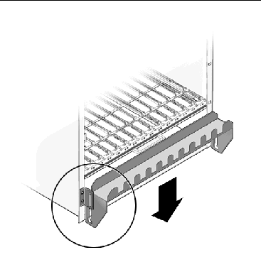

1. Move the front cable management bracket to the lower position (FIGURE 1-4).
FIGURE 1-4 Front Cable Management Bracket in Lower Position

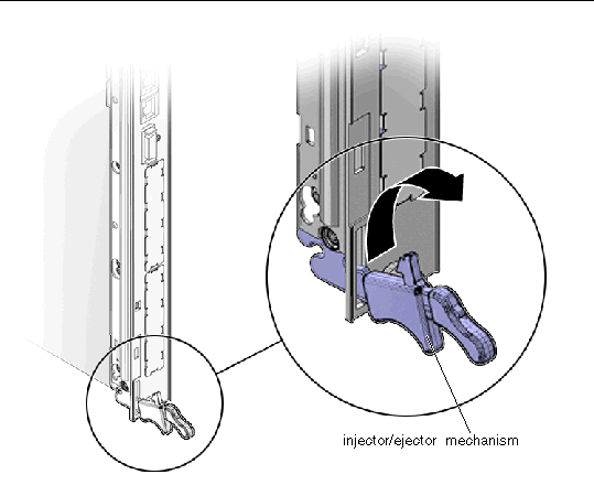

2. Disengage the injector/ejector mechanisms at the top and bottom of the switch to notify software that the board is about to be removed. Wait for the Hot-Swap LED to light.
FIGURE 1-5 Injector/Ejector on the Switch (Open Position)

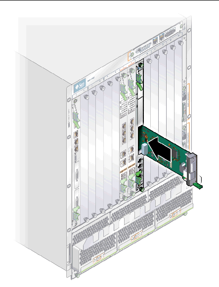

Following are the instructions for installing an AMC. For instructions on installing switch and RTM sets, refer to the Sun Netra CP3240 Switch Installation Guide (820-3251).
1. At the front of the Netra CP3240 switch, locate the AMC site where you want to install the AMC.
2. Remove the filler panel, if necessary.
3. Obtain the AMC card from the ship kit.
Note - Be sure to follow unpacking and handling instructions. See Section 1.2, Unpacking and Section 1.3, Handling AMCs. |
4. Perform any card-specific hardware procedures, if necessary.
5. Prepare the AMC by opening its injector/ejector latches.
FIGURE 1-6 Opening the Injector/Ejector Latches
6. Carefully align the edges of the board with the guides in the appropriate site.
It might be helpful to look into the enclosure to verify correct alignment of the rails in the guides.
Caution - Do not force the AMC into the site. If it does not fit properly, check to ensure that you have the correct matching AMC for the switch. |
7. Keeping the board aligned in the guides, slide the board in by pressing on the AMC faceplate until the AMC faceplate is flush with the Netra CP3240 switch faceplate.
8. Push the ejector latch in fully.
If system power is on and AMC is installed properly, the AMC board Hot-Swap LED lights up. The Hot-Swap LED blinks for several seconds, then goes off.
If the Hot-Swap LED does not go off after several seconds, push firmly on the injector/ejector handles to ensure that they are pushed in all the way.
