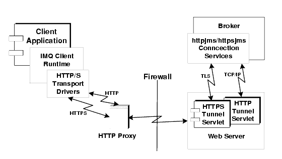

MQ messaging can be run on top of HTTP/HTTPS connections. Because HTTP/HTTPS connections are normally allowed through firewalls, this allows client applications to be separated from a broker by a firewall.
Figure B-1 shows the main components involved in providing HTTP/HTTPS support.
  • On the client side, an HTTP transport driver encapsulates the MQ message into an HTTP request and makes sure that these requests are sent to the Web server in the correct sequence.
  • The client application can use an HTTP proxy server to communicate with the broker if necessary. The proxy's address is specified using command line options when starting the client application. See "Using a HTTP Proxy" for more information.
  • An HTTP or HTTPS tunnel servlet (both bundled with MQ) is loaded in the web server and used to pull JMS messages out of client HTTP requests before forwarding them to the broker. The HTTP/HTTPS tunnel servlet also sends broker messages back to the client in response to HTTP requests made by the client. A single HTTP/HTTPS tunnel servlet can be used to access multiple brokers.
Figure B-1    HTTP/HTTPS Support Architecture
Diagram showing how an http proxy and http tunnel servlet enable messages to go through firewalls. Figure explained in text.
  • On the broker side, the httpjms or httpsjms connection service unwraps and demultiplexes incoming messages from the corresponding tunnel servlet.
As you can see from Figure B-1, the architecture for HTTP and HTTPS support are very similar. The main difference is that, in the case of HTTPS (httpsjms connection service), the tunnel servlet has a secure connection to both the client application and broker.
The secure connection to the broker is provided through an SSL-enabled tunnel servlet—MQ's HTTPS tunnel servlet—which passes a self-signed certificate to any broker requesting a connection. The certificate is used by the broker to set up an encrypted connection to the HTTPS tunnel servlet. Once this connection is established, a secure connection between a client application and the tunnel servlet can be negotiated by the client application and the web server.
