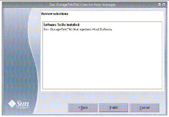

1. Log in to the management host Linux OS as root.
2. Insert the host software installation CD into a drive on the management host.
If the compressed installation files do not appear in a directory window:
a. Change to the /media/cdrom directory:
b. Display the contents of the CD:
3. Review the README.txt file for the latest information on the product and the installation process.
4. To begin unpacking the contents of the compressed installation file, enter the following command or click the RunMe icon if using a file manager:
The files are unpacked in the default directory - /var/opt/CommonArrayManager.
The Host_Software_5.1.0.xx directory is unpacked into the default directory. The contents of this directory includes:
If the wizard screen is not redisplayed or you receive an error message, recheck that the host requirements in Checking Installation Requirements are met.
Summary information about the installation is displayed.
6. Click Next to display the license agreement screen.
7. Click the radio button to accept the license agreement, and then click Next to continue the host installation.
8. When prompted to select the installation type, do one of the following:
If you select Custom, you will be prompted to choose either the management software or the remote CLI client to install.
9. When prompted to review your selection, check it and click the Install button.
When the host installation is complete, the host software installer Installation Summary screen is displayed.
11. Eject the CD and remove it from the drive.

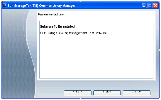

1. Insert the host software installation CD into a local drive.
If the compressed installation file does not appear in a directory window, click on the cd drive (example: D:).
2. To begin unpacking the contents of the compressed installation file, double click on the following icon:
The files are unpacked in the default directory path <system drive>:\Sun\CommonArrayManager\Host_Software_5.1.0.xx\bin. When the unpacking is complete, the host software installer begins automatically.
If the wizard screen is not redisplayed or you receive an error message, check that the host requirements in Checking Installation Requirements are met.
3. Click Next to begin the installation of the software.
The license agreement screen is displayed.
4. Click the radio button to accept the license agreement, and click Next to continue the host installation.

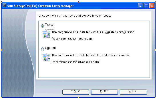

5. When prompted to select the installation type, do one of the following:
6. When prompted to review your selection, check it and click the Install button.
When the installation is complete, the View Results screen reports the installation status.
8. Eject the CD and remove it from the drive.
When the installation is complete, the host software installer Installation Summary screen is displayed.

The Review Selections window is displayed.
5. Select the software to be uninstalled, and click the Uninstall button.
