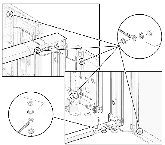

Caution - The ground cables must be properly attached at three points on the Sun rack, the cabinet extension, and the door. |
Both ends of the cabinet extension cable are screwed into the extension for shipping (FIGURE 3-2).
If the door is hung on the left hinges, use the top ground cables. If the door is hung on the right hinges, connect the bottom ground cable. Racks with silver alloy doors only allow the front door to be hung on the left side.
1. Using a 10 mm wrench, disconnect the front portion of the ground cable. This part will attach to the door (FIGURE 3-2).
2. Connect the original rack cabinet ground cable to the cabinet extension (FIGURE 3-2).
3. Connect the cabinet extension ground cable to the door at the top or the bottom of the door.
