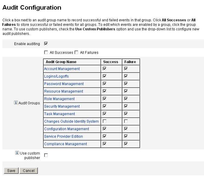

Audit ConfigurationThe audit configuration is composed of one or more publishers and several pre-defined groups.
An audit group defines a subset of all audit events based on the object types, actions and action results. Each publisher is assigned one or more audit groups. By default, the repository publisher is assigned to all audit groups.
An audit publisher delivers audit events to a particular audit destination. The default repository publisher writes audit records into the repository. Each audit publisher may have implementation specific options. Audit publishers may have a text formatter assigned: text formatters provide textual representation of audit events.
The Audit Configuration (#ID#Configuration:AuditConfiguration) object is defined in the sample/auditconfig.xml file. This configuration object has an extension that is a generic object. At the top level, it has the following attributes:
filterConfiguration
The filterConfiguration attribute lists event groups, which are used to enable one or more events to pass through the event filter. Each group listed in the filterConfiguration attribute contains the attributes listed in Table 12-2.

Identity Manager provides the following default event groups:
You can configure each group from the Audit Events page of the Identity Manager administrative interface (configure/auditeventconfig.jsp). The page allows you to configure successful or failed events for each group. The interface does not support adding or modifying enabledEvents for groups, but you can do this by using the Identity Manager debug pages.
The default event groups and the events they enable are described in the following sections.

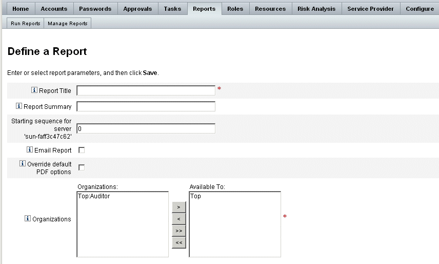

To configure tamper-resistant logging, use the following steps:
- Create a tampering report by selecting Reports > New > Audit Log Tampering Report.
- When the Define a Tampering Report page displays (see Figure 12-1), enter a title for the report and then Save it.
Figure 12-1 Configuring an Audit Log Tampering Report
You can also specify the following optional parameters:
- Report Summary – Enter a descriptive summary of the report.
- Starting sequence for server '<server_name>' – Enter the starting sequence number for the server.
- This option enables you to delete old log entries without having them flagged as tampering and limits the report’s scope for performance reasons.
- Email Report – Enable to email report results to a specified email address.
- When you select this option, the page refreshes and prompts you for email addresses. However, keep in mind that email is not safe for text content — sensitive information (such as account IDs or account history) may be exposed.
- Override default PDF options – Select to override the default PDF options for this report.
- Organizations – Select organizations that should have access to this report.
- Next, select Configure > Audit to open the Audit Configuration page (shown in Figure 12-2).
Figure 12-2 Tamper-Resistant Audit Logging Configuration
- Select Use Custom Publisher, and then click on the Repository publisher link.
- Select Enable tamper-resistant audit logs, and then click OK.
- Click Save to save the settings.
