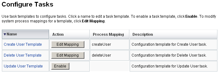

- From the Identity Manager Administrator interface, select Tasks, and then select Configure Tasks. Figure 8-1 illustrates the Configure Tasks page.
Figure 8-1 Configure Tasks
The Configure Tasks page contains a table with the following columns:

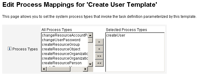

- Click Enable to open the Edit Process Mappings page for a template.
For example, the following page (Figure 8-2) displays for the Create User Template:
Figure 8-2 Edit Process Mappings Page
Note

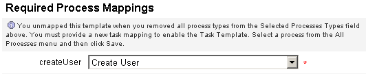

The default process type (in this case, createUser) automatically displays in the Selected Process Types list. If necessary, you can select a different process type from the menu.
- Generally, you do not map more than one process type for each template.
- If you remove the process type from the Selected Process Types list and do not select a replacement, a Required Process Mappings section displays instructing you to select a new task mapping.
Figure 8-3 Required Process Mappings Section
- Click Save to map the selected process type and return to the Configure Tasks page.

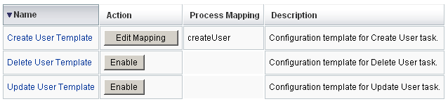

Note
When the Configure Tasks page redisplays, an Edit Mapping button replaces the Enable button and the process name is listed in the Process Mapping column.
Figure 8-4 Updated Configure Tasks Table
- Repeat the mapping process for each of the remaining templates.

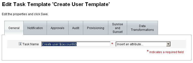

For the Create User or Update User Templates
When you open the Edit Task Template Create User Template or the Edit Task Template Update User Template, the General tab page displays by default. This page consists of a Task Name text field and menu, as shown in the following figure.
Figure 8-5 General Tab: Create User Template
Task names can contain literal text and/or attribute references that are resolved during task execution.
To change the default task name, use the following steps:
- Type a name into the Task Name field.
You can edit or completely replace the default task name.
- The Task Name menu provides a list of attributes that are currently defined for the view associated with the task configured by this template. Select a attribute from the menu (optional).
Identity Manager appends the attribute name to the entry in the Task Name field. For example:
Create user $(accountId) $(user.global.email)
- When you are finished, you can

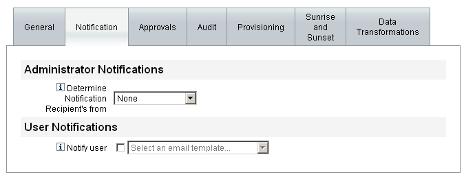

Configuring the Notification Tab
All of the Task Templates support sending email notifications to administrators and users when Identity Manager invokes a process — usually after the process has completed. You can use the Notification tab to configure these notifications.
The following figure shows the Notification page for the Create User Template.
Figure 8-6 Notification Tab: Create User Template
To specify how Identity Manager will determine notification recipients, use the following process:
Configuring Administrator Notifications
Select an option from the Determine Notification Recipients from menu to determine the method for notifying administrator recipients.
- None (default) — No administrators will be notified.
- Attribute — Select to derive notification recipients’ account IDs from a specified attribute in the user view. Continue to Specifying Recipients by Attribute.

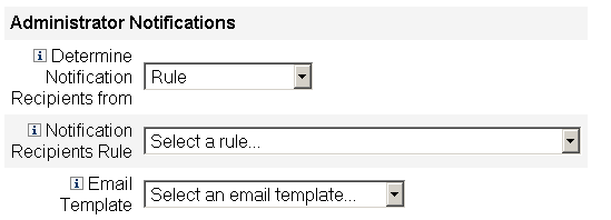

- Rule — Select to derive notification recipients’ account IDs by evaluating a specified rule. Continue to Specifying Recipients by Rule.
- Query — Select to derive notification recipients’ account IDs by formulating a query to a particular resource. Continue to Specifying Recipients by Query.

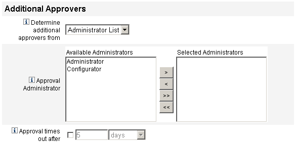

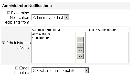

- Administrator List — Select to choose notification recipients’ explicitly from a list. Continue to Specifying Recipients from the Administrators List.

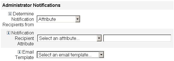

To derive notification recipients’ account IDs from a specified attribute, use the following steps:
Note
The attribute must resolve to a string that represents a single account ID or to a list in which the elements are account IDs.
- Select Attribute from the Determine Notification Recipients from menu and the following new options are displayed:
Figure 8-7 Administrator Notifications: Attribute
- Select an attribute from the Notification Recipient Attribute menu.
The attribute name displays in the text field adjacent to the menu.
- Select a template from the Email Template menu to specify a format for the administrators’ notification email.
To derive notification recipients’ account IDs from a specified rule, use the following steps:
Note
When evaluated, the rule must return a string that represents a single account ID or to a list in which the elements are account IDs.
- Select Rule from the Determine Notification Recipients from menu and the following new options display in the Notification form:
Figure 8-8 Administrator Notifications: Rule
- Select a rule from the Notification Recipient Rule menu.

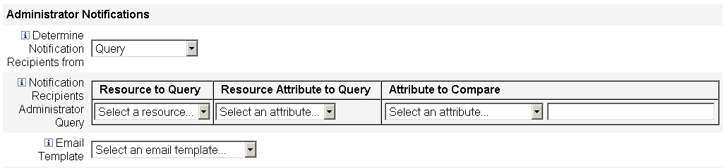

To derive notification recipients’ account IDs by querying a specified resource, use the following steps:
- Select Query from the Determine Notification Recipients from menu and the following new options display in the Notification form, as illustrated in Figure 8-9:
Figure 8-9 Administrator Notifications: Query
- Notification Recipient Administrator Query — Provides a table consisting of the following menus, which you can use to construct a query:
- Resource to Query — Provides a list of resources currently defined for your system.
- Resource Attribute to Query — Provides a list of resource attributes currently defined for your system.
- Attribute to Compare — Provides a list of attributes currently defined for your system.
- Email Template — Provides a list of email templates.
- Select a resource, resource attribute, and an attribute to compare from these menus to construct the query.
Select Administrators List from the Determine Notification Recipients from menu and the following new options display in the Notification form:
Figure 8-10 Administrator Notifications: Administrators List

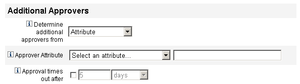

From Attributes
To determine additional approvers from an attribute,
- Select Attribute from the Determine additional approvers from menu.
Note
The following new options display:
Figure 8-13 Additional Approvers: Attribute
- Approver Attribute — Provides a list of attributes (currently defined for the view associated with the task configured by this template) used to determine approvers’ account IDs.

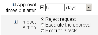

- Approval times out after — Provides a method for specifying when the approval will time out.
- Use the Approver Attribute menu to select an attribute.
The selected attribute displays in the adjacent text field.
- Decide whether you want the approval request to timeout after a specified period of time.
- If you want to specify a timeout period, continue to Configuring Approval Timeouts for instructions.
- If you do not want to specify a timeout period, you can continue to Configuring the Approval Form or save your changes and go on to configure a different tab.

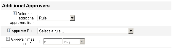

From Rules
To derive the approvers’ account IDs from a specified rule, use the following steps:
- Select Rule from the Determine additional approvers from menu.
Note
The following new options display.
Figure 8-14 Additional Approvers: Rule
- Select a rule from the Approver Rule menu.

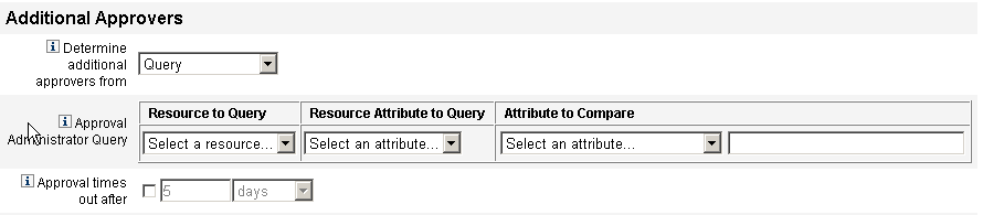

From a Query
To derive approvers account IDs by querying a specified resource, use these steps:
- Select Query from the Determine additional approvers from menu and the following new options display:
Figure 8-15 Additional Approvers: Query
- Approval Administrator Query — Provides a table consisting of the following menus, which you can use to construct a query:
- Construct a query as follows:
From the Administrators List
To explicitly choose additional approvers from the Administrators List,
- Select Administrators List from the Determine additional approvers from menu and the following new options display:
Figure 8-16 Additional Approvers: Administrators List
- Administrators to Notify — Provides a selection tool with a list of available administrators.
- Approval Form — Provides a list of user forms additional approvers can use to approve or reject an approval request.
- Select one or more administrators in the Available Administrators list and use the
button or
button to move the selected name(s) to the Selected Administrators list.

To configure an approval timeouts,
- Enable the checkbox.
The adjacent text field and menu become active, and the Timeout Action buttons display, as shown in the following figure.
Figure 8-17 Approval Timeout Options
- Use the Approval times out after text field and menu to specify a timeout period as follows:

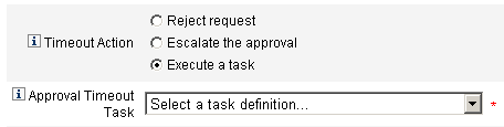

- Enable one of the following Timeout Action buttons to specify what happens when the approval request times out:
When you enable this button, new options display because you must specify how Identity Manager will determine approvers for an escalated approval. Continue to Escalating Approvals for instructions.
Enable this button and the Approval Timeout Task menu displays so you can specify a task to execute if the approval request times out. Continue to Executing a Task for instructions.

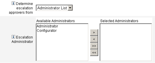

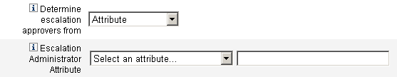

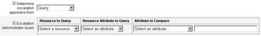

When you enable the Timeout Action Escalate the approval button, the Determine escalation approvers from menu displays as follows:
Figure 8-18 Determine Escalation Approvers From Menu
Select one of the following options from this menu to specify how approvers are determined for an escalated approval.
Executing a Task
When you enable the Timeout Action Execute a task button, the Approval Timeout Task menu displays as follows:
Figure 8-23 Approval Timeout Task Menu
Specify a task to execute if the approval request times out. For example, you might allow the requester to submit a help desk request or send a report to the Administrator.

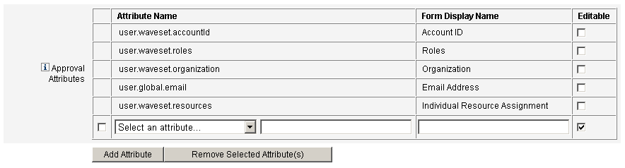

Note
The Delete User Template does not contain an Approval Form Configuration section. You can configure this section for Create User and Update User Templates only.
You can use features in the Approval Form Configuration section to select an approval form, and add attributes to (or remove attributes from) the approval form.
Figure 8-24 Approval Form Configuration

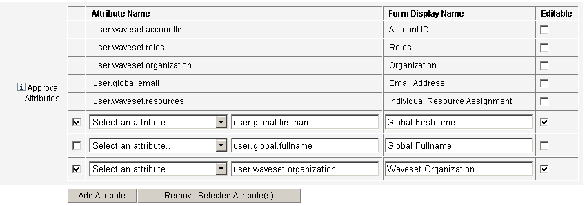

By default, the Approval Attributes table contains the following standard attributes:
To configure an Approval form for additional approvers:
- Select a form from the Approval Form menu.
Approvers will use this form to approve or reject an approval request.
- Enable checkboxes in the Editable column of the Approval Attributes table to allow approvers to edit the attribute value.
For example, if you enable the user.waveset.accountId checkbox the approver can change the user’s account ID.
- Click the Add Attribute or Remove Selected Attribute(s) buttons to specify attributes from the new user’s account data to display in the approval form.
- To add attributes to the form, see Adding Attributes.
- To remove attributes from the form, see Removing Attributes.
Adding Attributes
To add attributes to the approval form
- Click the Add Attribute button located under the Approval Attributes table.
The Attribute name menu becomes active in the Approval Attributes table, as shown in the following figure:
Figure 8-25 Adding Approval Attributes
- Select an attribute from the menu.
The selected attribute name displays in the adjacent text field and the attribute’s default display name displays in the Form Display Name column.
For example, if you select the user.waveset.organization attribute, the table will contain the following information:
- Repeat these steps to specify additional attributes.
Removing Attributes
To remove attributes from the approval form, use the following steps:
- Enable one or more checkboxes in the leftmost column of the Approval Attributes table.
- Click the Remove Selected Attribute(s) button to immediately remove the selected attributes from the Approval Attributes table.
For example, user.global.firstname and user.waveset.organization would be removed from the following table when you clicked the Remove Selected Attribute(s) button.
Figure 8-26 Removing Approval Attributes

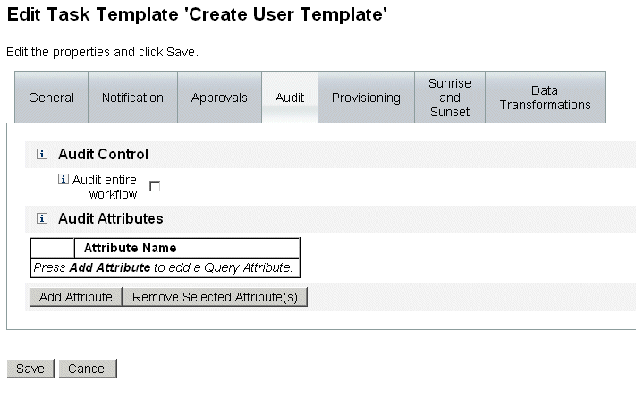

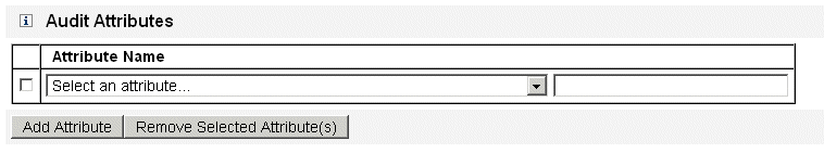

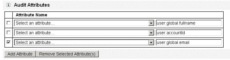

Configuring the Audit Tab
All of the configurable Task Templates support configuring workflows to audit certain tasks. Specifically, you can configure the Audit tab to control whether workflow events will be audited and specify which attributes will be stored for reporting purposes.
Figure 8-27 Audit Create User Template
To configure auditing from the User Template’s Audit tab:
- Enable the Audit entire workflow checkbox to activate the workflow auditing feature.
- Click the Add Attribute button (located in the Audit Attributes section) to select attributes you want to record for reporting purposes.
- When the Select an attribute menu displays in the Audit Attributes table, select an attribute from the list.
The attribute name will display in the adjacent text field.
Figure 8-28 Adding an Attribute
To remove attributes from the Audit Attributes table, use the following steps:
When you are finished configuring this tab, you can

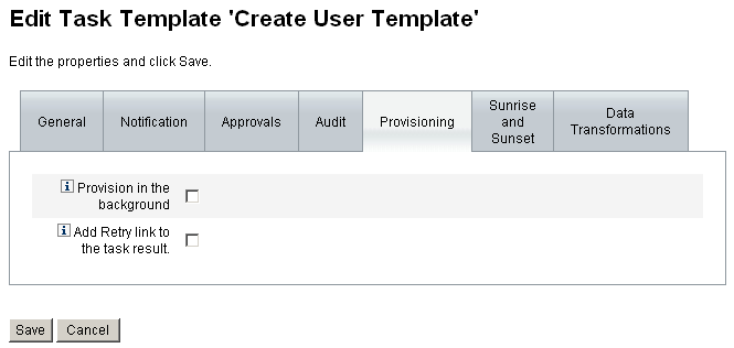

Configuring the Provisioning Tab
You can use the Provisioning tab to configure the following options, which are related to provisioning:
Figure 8-30 Provisioning Tab: Create User Template
When you are finished configuring the Provisioning tab, you can

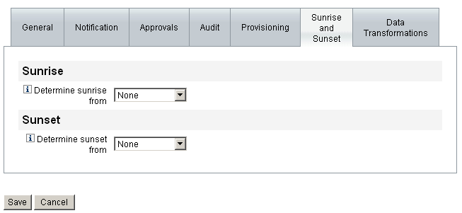

Configuring the Sunrise and Sunset Tab
You use the Sunrise and Sunset tab to select a method for determining the time and date when the following actions will occur.
For example, you can specify a sunset date for a temporary worker whose contract expires after six months.
Figure 8-31 illustrates the settings on the Sunrise and Sunset tab.
Figure 8-31 Sunrise and Sunset Tab: Create User Template
The topics that follow provide instructions for configuring the Sunrise and Sunset tab.

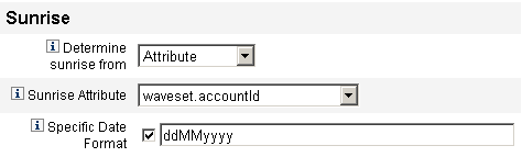

Specifying an Attribute
To determine the provisioning date and time based on the value of an attribute in the users account data, use the following steps:
- Select Attribute from the Determine sunrise from menu and the following options become active:
- Select an attribute from the Sunrise Attribute menu.
- If necessary, enable the Specific Date Format checkbox and when the Specific Date Format field becomes active, enter a date format string.
For example, to provision a new user based on their waveset.accountId attribute value using a day, month, and year format specify the following:
Figure 8-34 Provisioning a New User by Attribute

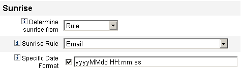

Specifying a Rule
To determine the provisioning date and time by evaluating a specified rule, use the following steps:
For example, to provision a new user based on the Email rule using a year, month, day, hours, minutes, and seconds format specify the following:
Figure 8-35 Provisioning a New User by Rule

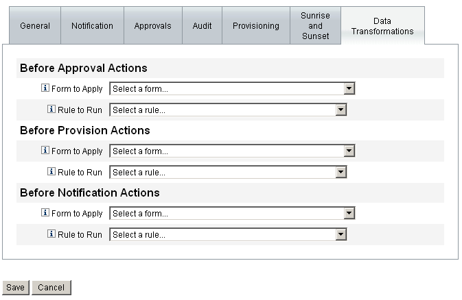

Configuring the Data Transformations Tab
If you want to alter user account data as the workflow executes, you can use the Data Transformations tab to specify how Identity Manager will transform the data during provisioning.
For example, if you want forms or rules to generate email addresses that conform to company policy, or if you want to generate sunrise or sunset dates.
When you select the Data Transformations tab, the following page displays:
Figure 8-36 Data Transformations Tab: Create User Template
This page consists of the following sections:
- Before Approval Actions – Configure the options in this section if you want to transform user account data before sending approval requests to specified approvers.
- Before Provision Actions – Configure the options in this section if you want to transform user account data before a provisioning action.
- Before Notification Actions – Configure the options in this section if you want to transform user account data before notifications are sent to specified recipients.
You can configure the following options in each section:
- Form to Apply menus – Provide a list of the forms currently configured for your system. Use these menus to specify forms that will be used to transform data from the users accounts.
- Rule to Run menus – Provide a list of the rules currently configured for your system. Use these menus to specify rules that will be used to transform data from the users accounts.
