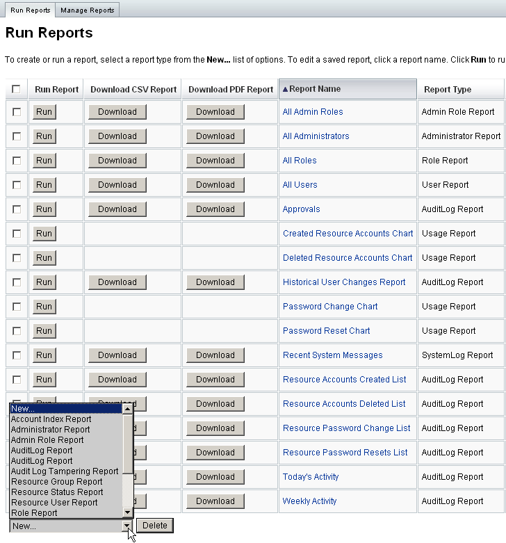

Working with ReportsIn Identity Manager, reports are considered a special category of task. As a result, you work with reports in two areas of the Identity Manager Administrator interface:
Reports
You perform most report-related activities from the Run Reports page, which allows you to accomplish the following report activities:
To view this page, select Reports from the menu bar. The Run Reports page appears, showing a list of available reports.
By default, the following reports are run on the set of organizations controlled by the logged-in administrator, unless overridden by selecting one or more organizations against which the report will be run.
Figure 7-1 shows an example of the Run Reports page.
Figure 7-1 Run Reports Selection
Begin defining reports by using one of these methods:
Creating Reports
To create a report, use the following steps:
Identity Manager displays the Define a Report page, where you select and save options to create the report.
Cloning Reports
To clone a report, select a report from the list. Enter the new report name and optionally adjust report parameters, and then click Save to save it with the new name.
Emailing Reports
When creating or editing a report, you can select an option to email the report results to one or more email recipients. When you select this option, the page refreshes and prompts for email recipients. Enter one or more recipients, separating addresses with a comma.
You also can choose the format of the report to be attached to the email:
Running Reports
After entering and selecting report criteria, you can:
- Run the report without saving — Click Run to run the report. Identity Manager does not save the report (if you defined a new report) or the changed report criteria (if you edited an existing report).
- Save the report — Click Save to save the report. Once saved, you can run the report from the Run Reports page (the list of reports).
Scheduling Reports
Depending on whether you want to immediately run a report or schedule it to run at regular intervals, you make different selections:
- Reports > Run Reports — Allows you to run saved reports immediately. From the list of reports, click Run. Identity Manager runs the report and then displays the results in summary and detailed formats.
- Tasks > Schedule Tasks — Schedules report tasks to be run. After selecting a report task, you can set report frequency and options. You also can adjust specific report details (as in the Define a Report page in the Reports area).
Downloading Report Data
From the Run Reports page, click Download in one of these columns:

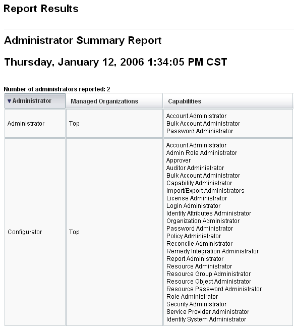

- Administrator – View Identity Manager administrators, the organizations they manage, and assigned capabilities. When defining an administrator report, you can select administrators to include by organization.

As shown in the following illustration, the administrator report lists Identity Manager administrators, the organizations they manage, and their assigned capabilities and admin roles.
Figure 7-3 Administrator Summary Report

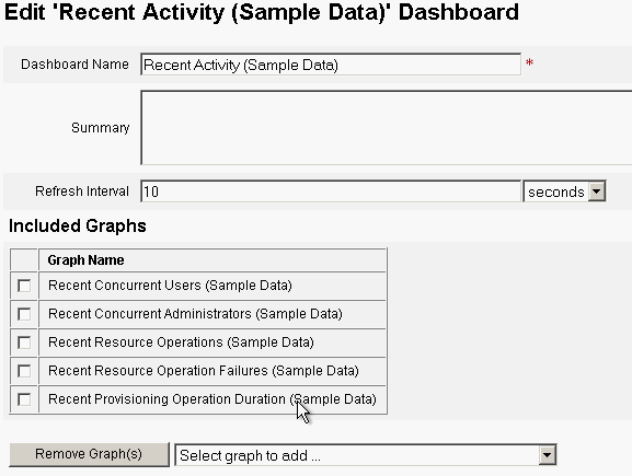

Working with GraphsYou can perform the following activities related to graphs:
View Defined Graphs
Identity Manager provides some sample graphs. Some use sample data and some do not. You are encouraged to create additional graphs that are applicable to your deployment.
You should remove the sample graphs and sample dashboards before moving a deployment into production. Some of the sample graphs that do not use sample data might appear blank if no applicable data has been collected.
- Click Reports from the menu bar.
- Click Dashboard Graphs.
All defined graphs are listed.
- Click on the desired graph name.
- If desired, click Pause refresh to pause the dashboard refresh. Click Resume to renew the view.
Note
For dashboards containing many graphs, it is sometimes helpful to pause the refresh until all of the graphs are initially loaded.
- If desired, click Refresh now to force an immediate refresh.
- Click Done to return to the Dashboard Graphs listing page.

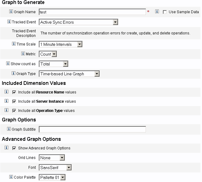

Create Graphs
Use the following procedure to create a new Dashboard graph:
- Click Repots from the menu bar.
- Click New. Figure 7-5 illustrates the Edit Graph page.
Figure 7-5
Edit GraphsGraph to Generate
- Enter a Graph Name. Choose a unique, meaningful name since graphs are added to dashboards by name.
- Select Use Sample Data, if desired.
Enable this option to preview the graph with sample data. The sample data option is only provided for you to familiarize yourself with the system. As sample data is not available for all tracked events, this option is most useful for demos and when experimenting with the various graph options. Delete sample data prior to going to a production environment.
Note
The set of tracked events that use sample data differs from the events that are actually tracked.
- Select the desired type of Tracked Event from the list.
An event is a system characteristic, such as memory usage, or an aggregation of events, such as resource operations, whose historical values are tracked and displayed visually as graphs or charts.
- Select a Time Scale from the list.
This controls how often data is aggregated (for example, one hour) and how often it is retained (for example, one month). The system stores tracked event data for progressively larger time scales to allow both a detailed, current view of the system as well as an understanding of historical trends.
- Select a Metric from the list. A default one is selected, either count or average depending on the selected tracked event.
Each graph displays a single metric. The available metrics depend on the selected tracked event. Possible metrics are:
- Count - the total number of times the event occurred in the time interval
- Average - the arithmetic mean of the event values for the time interval
- Maximum - the maximum event value for the time interval
- Minimum - the minimum event value for the time interval
- Histogram - separate counts for discrete ranges of event values for the time interval
- Select Show count as from the list.
The graph count is shown either as a raw total or scaled by various time scales.
- Select a Graph Type from the list.
This controls how the tracked event data is displayed. The available graph types depend on the selected tracked event and can include line graphs, bar charts, and pie charts.
Base Dimension
- If desired, select the following from the list:
- Resource Name. If selected, all values for the dimension are included in the graph. Deselect this option to choose individual values of the dimension to include in the graph.
- Server Instance. If selected, all values for the dimension are included in the graph. Deselect this option to choose individual values of the dimension to include in the graph.
- Operation Type. If selected, all values for the dimension are included in the graph. Deselect this option to choose individual values of the dimension to include in the graph.
After you select the dimension, the page refreshes to display a graph.
Graph Options
Advanced Graph Options
Edit Graphs
Edit graphs by selecting the Reports tab and then selecting the graph name from the Dashboard Graphs listing.
The graph attributes you can edit vary depending on the graph selected. One or more of the following charactistics are available for editing:
- Graph Name - Graphs are added to a dashboard by name.
- Registry — Specifies the tracked event description defined in the registry. The current selection includes: SAMPLE, SPE (service providers), and IDM.
- Tracked Event - A system characteristic, such as memory usage, or an aggregation of events, such as resource operations, whose historical values are tracked and displayed visually as graphs or charts.
- Time Scale - Controls how often data is aggregated and how often it is retained.
- Metric - Each graph displays a single metric. The available metrics depend on the selected tracked event. Other options may be available for the metric selected.
- Graph type - Controls how the tracked event data is displayed (for example, line graph or bar graph).
- Included Dimension Values - If selected, all values for the dimension(s) are included in the graph.
- Graph Subtitle - If desired, enter a subtitle under the main title of the graph.
- Advanced Graph Options - select this if you wish to set the following:
- Click Save.

Edit Dashboards
Use the procedure described in creating a dashboard to edit a dashboard, except instead of selecting New, select the dashboard you want to modify and edit the following attributes:
Figure 7-6 illustrates a sample dashboard edit page.
Figure 7-6 Edit Dashboards

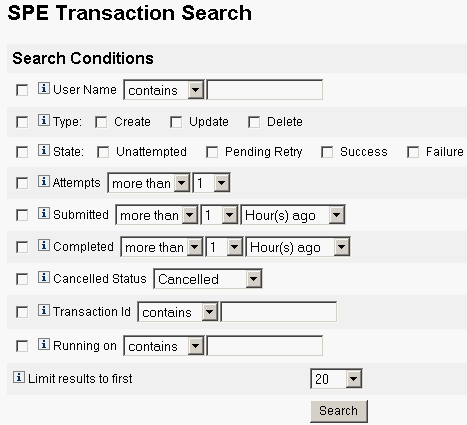

Searching Transactions
A transaction encapsulates a single provisioning operation, for example creating a new user or assigning new resources. To ensure that these transactions complete when resources are unavailable, they are written to the Transaction Persistent Store.
The Search Transactions page allows you to search for transactions in the Transaction Persistent Store. This includes transactions that are still being retried, as well as transactions that have already completed. Transactions that have not completed can be cancelled preventing any further attempts.
To search transactions:
- Log in to Identity Manager.
- Click Service Provider from the menu bar.
- Click Search Transations.
The Search Conditions page appears.
Note
The search returns only transactions that match all of the conditions selected below. This is similar to the Accounts->Find Users page in Identity Manager.
- If desired, select User Name.
This allows you to search for transactions that apply only to users with the accountId that you enter.
- If desired, select search for Type.
This allows you to search for transactions of the selected type or types.
- If desired, select search for State.
This allows you to search for transactions in the following selected state or states:
- Unattempted transactions have not yet been attempted.
- Pending retry transactions have been attempted one or more times, have had one or more errors, and are scheduled to be retried up to the retry limits configured for the individual resources.
- Success transactions have completed successfully.
- Failure transactions have completed with one or more failures.
- If desired, select to search for Attempts.
This allows you to search for transactions based on how many times they have been attempted. Failed transactions are retried up to the retry limits configured for the individual resources.
- If desired, select to search for Submitted.
This allows you to search for transactions based on when they were initially submitted in increments of hours, minutes, or days.
- If desired, select to search for Completed.
This allows you to search for transactions based on when they were completed in increments of hours, minutes, or days.
- If desired, select to search for Cancelled Status.
This allows you to search for transactions based on whether or not they have already been cancelled.
- If desired, select to search for Transaction ID.
This allows you to search for transactions based on their unique id. Use this option to find a transaction based on the id value you enter, which appears in all audit log records.
- If desired, select to search for Running On (which Server.)
This allows you to search for transactions based on the Service Provider Edition server where they are running. The server's identifier is based on its machine name unless it has been overridden in the Waveset.properties file.
- Limit the search to results to first number of entries selected from the list.
Only results up to the specified limit are returned. No indication is made if additional results are available.
Figure 7-7
Search Transactions- Click Search.
The search results are displayed.
- If desired, click Download All Matched Transactions at the bottom of the results page. This saves the results to an XML formatted file.
