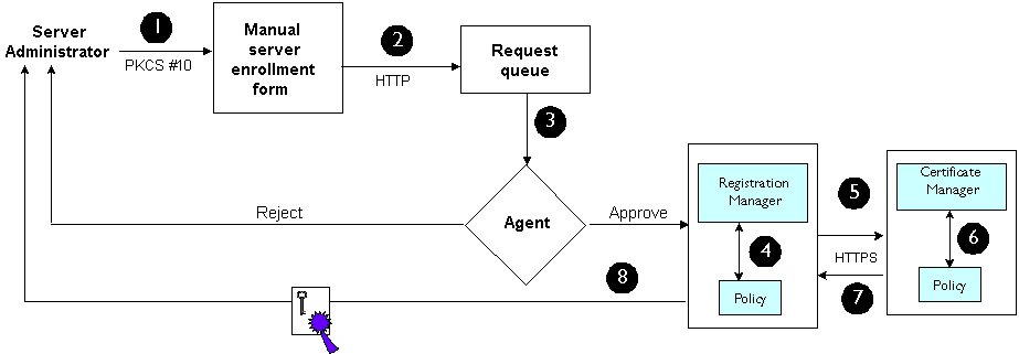

How the Manual Server Enrollment Process Works
Figure 24-1 illustrates how Certificate Management System issues a server certificate in a deployment scenario involving a Registration Manager acting as an enrollment authority to a Certificate Manager. The server certificate is requested via a manual enrollment form hosted by the Registration Manager.
Figure 24-1    Server (or site) certificate issuance ![]()
These are the steps shown in Figure 24-1:
The server administrator goes to the manual enrollment form hosted by the Registration Manager, pastes in the certificate signing request in PKCS #10 format, completes the other information in the enrollment form, and submits the form.
(If the enrollment port is HTTPS, the administrator should visit the link that delivers the CA's certificate chain and download the chain into the browser that he or she will use for server enrollment.)
The Registration Manager verifies the authenticity of the request. Because the request requires manual authentication, the Registration Manager stores the request in the queue for agent approval.
An agent processes the request and either rejects or approves it.
The Registration Manager picks up the approved request and subjects it to policy checks.
If the request passes the Registration Manager's policy checking, the Registration Manager submits the request to the Certificate Manager for signing. The Certificate Manager verifies the authenticity of the Registration Manager by verifying the certificate presented by it. If it is a trusted Registration Manager, the Certificate Manager accepts the request.
The Certificate Manager subjects the request to its own policy checks.
If the request passes Certificate Manager's policy, it signs the request immediately and returns the certificate to the Registration Manager. The Registration Manager then delivers the certificate to the administrator. Optionally, the Certificate Manager may publish the certificate to the corporate directory.
If the Certificate Manager's policy requires additional information, the administrator will be directed to return later to pick up the certificate. The administrator may need to query the Registration Manager using the certificate request number to see whether the certificate has been issued. Alternatively, the Registration Manager can be configured to email the user when the certificate is ready for pick up. See Notifications of Certificate Issuance to End Entities.
The Registration Manager delivers the server SSL certificate to the email address specified in the enrollment form. Optionally, the Registration Manager may publish the certificate to the corporate directory.
