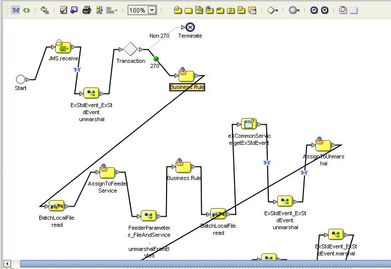

You must make sure the Berlin system is using the data file path listed under Editing the Sample Data .xml Files by checking the bp271 BP in 271_FromInt_270. To do this action, open eXchange ⇒ Samples ⇒ HIPAA ⇒ 271_FromInt_270 ⇒ BPs ⇒ bp271 in Project Explorer.
The BP structure appears in Business Process Editor, in Enterprise Designer’s right pane. See Figure 6–9.
Figure 6–9 Business Process Editor: bp271
Make sure that the path given in the indicated component, in the previous figure, reflects your Berlin data path, for example:
C:\temp\eXchange\Sample\HIPAA\Data\Berlin
This is also the path location of the HIPAA_dlg_270_In_Atlanta_270_In.xml and HIPAA_4010A1_271_template.st files.
