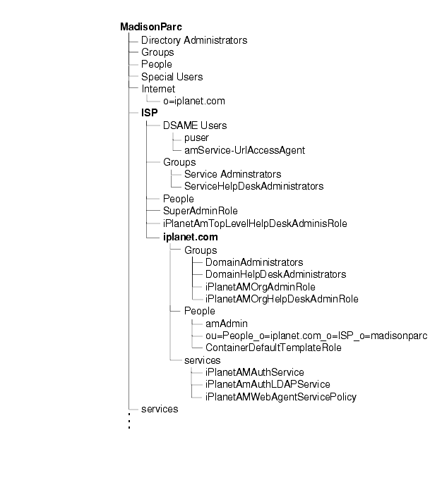

During installation, you must indicate whether you want to use an iPlanet-compliant DIT (also referred to as a compliant DIT), or the default DIT. A compliant DIT means that your directory information treewhether it's a new one or an existing onecomplies with the iPlanet DIT specification. The default DIT is simply one that does not comply with the iPlanet DIT specification.
The iPlanet-compliant DIT
The iPlanet-compliant DIT uses specialized directory objects, and its tree structure is optimized for use by hosting companies. It is useful when you want to maintain distinct branches or organizations in your directory tree so that one branch cannot access user information in another branch. Many DSAME customers want their users to share information across directory branches, and so will opt to use the default DIT.When you choose the iPlanet- DIT (also referred to as the compliant DIT), your root suffix is assumed to contain groups and userids for top-level administrators. The default root suffix name is isp (lowercase); this name is configurable. In Figure 2-1, the root suffix is named MadisonParc. The DSAME based suffix, named ISP (uppercase), is created under the root. This is designed to contain the groups and userids for the companies you will host. This base suffix is not optional, and its name is not configurable.
In the Figure 2-1 example, the users are located under the company entry o=iplanet.com,o=ISP,o=rootsuffix. There are special top level administrator groups at the root suffix, but no users. Users are grouped in the company people containers.
Figure 2-1    The iPlanet-compliant Directory Information Tree (DIT).
Figure 2-2    A Default Directory Information Tree (DIT).
Default DITs
