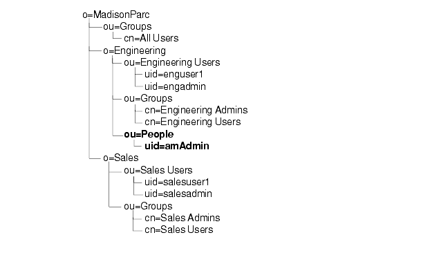

Basic DIT Structure
The examples used in this chapter are based on a simple DIT for a fictitious company. Figure 5-1 shows two organizations, Engineering and Sales, under the root. All groups in this example are static groups. This means that entries for these groups use the groupOfUniqueNames object class, which contains values naming the members of the group.
Figure 5-1    Directory Information Tree (DIT) used in examples in this chapter.
The following summarizes the use of groups in this sample DIT:
There is one group containing the administrators for Engineering, and one group with the administrators for Sales.
Very simple ACIs are set for the groups Engineering and Sales to allow members of these groups to manage their respective organizations.
In each organization, there is a group that contains non-administrator users.
There is another group at the root level, or top level. It contains the all users in the directory.

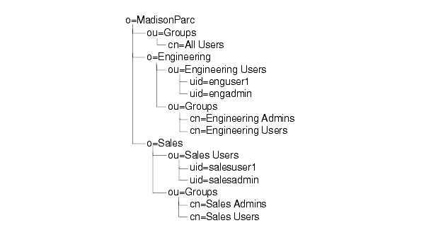

In this step, you will modify the ums.xml file.In Figure 5-3, the sample DIT has new object classes for both users and organizations. To expose the new object classes in the UI, you would modify the Creation Templates for both users and organizations in the ums.xml file. The Creation Templates configure DSAME to add or allow specific object classes and attributes when these entries are created.

The DSAME administration user amAdmin will be created under the ou=People,o=Engineering,o=madisonparc people container. This is the top level administrator for DSAME. This administrator has read and write access to the entire subtree for o=madisonparc. You can add one of your users to this top level administrator role after the DSAME console is started.At the command line, enter the following:
- ldapmodify -v -c -D "cn=Directory manager" -w password -a -f installExisting.ldif
Note You must specify the -c option. Be sure you install only installExisting.ldif, and none of the other files in the same directory.
- If you encounter error messages regarding "already existing" entries or values for the default organization, see "Step 7: (Optional) Add DSAME ACIs to Your Default Organization".
Figure 5-2    Directory Information Tree (DIT) Used in Examples in This Chapter.

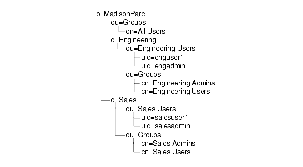

The examples used in this chapter are based on the MadisonParc DIT. Figure 5-3 shows two organizations, Engineering and Sales, under the root. All groups in this example are static groups.
Figure 5-3    The MadisonParc DIT.
