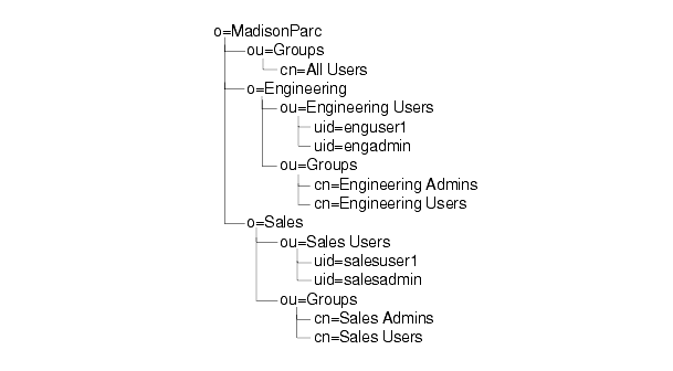

Basic DIT Structure
The examples used in this chapter are based on a simple DIT for a fictitious company. Figure 10-3 shows two organizations, Engineering and Sales, under the root. All groups in this example are static groups. This means that entries for these groups use the groupOfUniqueNames object class, which contains values naming the members of the group.
Figure 10-1    Directory Information Tree (DIT) Used in Examples in this Chapter.
The following summarizes the use of groups in this sample DIT:
There is one group containing the administrators for Engineering, and one group with the administrators for Sales.
Very simple ACIs are set for the groups Engineering and Sales to allow members of these groups to manage their respective organizations.
In each organization, there is a group that contains non-administrator users.
There is another group at the root level, or top level. It contains the all users in the directory.

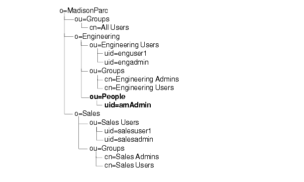

The DSAME administration user amAdmin will be created under the ou=People,o=Engineering,o=madisonparc people container. This is the top level administrator for DSAME. This administrator has read and write access to the entire subtree for o=madisonparc. You can add one of your users to this top level administrator role after the DSAME console is started.Run the following command:
- ldapmodify -v -c -D "cn=Directory manager" -w password -a -f installExisting.ldif
Note You must specify the -c option. Be sure you install only installExisting.ldif, and none of the other LDIF files in the same directory.
- If you encounter error messages regarding "already existing" entries or values for the default organization, see "Step 7: (Optional) Add DSAME ACIs to Your Default Organization".
Figure 10-2    Directory Information Tree (DIT) Used in Examples in This Chapter.

The examples used in this chapter are based on the MadisonParc DIT. Figure 10-3 shows two organizations, Engineering and Sales, under the root. All groups in this example are static groups.
Figure 10-3    The MadisonParc DIT.
