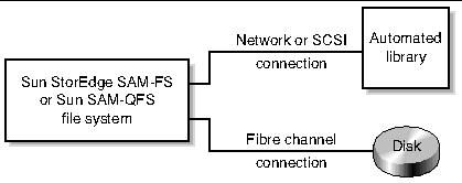

The Sun StorEdge SAM-FS environment includes a general-purpose file system along with the storage and archive manager, SAM. The Sun StorEdge SAM-FS environment's file system allows data to be archived to automated libraries at device-rated speeds. In addition, data can also be archived to files in another file system through a process known as disk archiving. The file system in the Sun StorEdge SAM-FS environment is a complete file system. The user is presented with a standard file system interface and can read and write files as though they were all on primary disk storage.
[ D ]
You can use TABLE 1-2 as a checklist when configuring a Sun StorEdge SAM-FS file system.

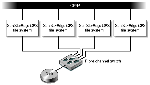

A Sun StorEdge QFS or Sun SAM-QFS shared file system is a distributed, multihost file system that you can mount on multiple Solaris operating system (OS) hosts. One Solaris OS host acts as the metadata server, and the others are clients. If you want the ability to change the metadata server, you must designate one or more clients as potential metadata servers.
[ D ]
You can use TABLE 1-4 as a checklist when configuring a Sun StorEdge QFS shared file system on Solaris OS hosts. If you are configuring a Sun StorEdge QFS shared file system on Sun Cluster hosts, see Sun StorEdge QFS File Systems in a Sun Cluster Environment for a checklist.

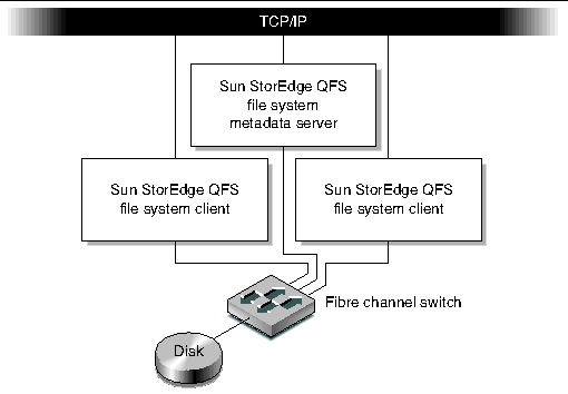

A Sun StorEdge QFS shared file system is a scalable, multihost file system on Sun Cluster nodes. If you configure a Sun StorEdge QFS shared file system on Sun Cluster nodes, the Sun Cluster software moves this file system's metadata server operations to another node if the Sun Cluster node that is the metadata server fails. This file system uses the SUNW.qfs(5) resource type.
Unlike a Sun StorEdge QFS shared file system on Solaris OS hosts, all Sun Cluster nodes configured in the Sun StorEdge QFS shared file system are potential metadata servers.
If the metadata server for the Sun StorEdge QFS shared file system is a node in a Sun Cluster, all hosts of the file system must also be cluster nodes. No hosts can reside outside the cluster.
