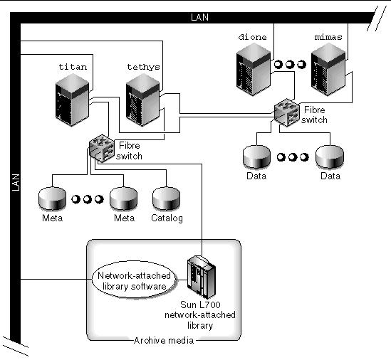

FIGURE 2-1 illustrates a Sun StorEdge QFS shared file system configuration in a Sun SAM-QFS environment.
[ D ]
FIGURE 2-1 shows four network-attached hosts: titan, tethys, dione, and mimas. The tethys, dione, and mimas hosts are the clients, and titan is the current metadata server. The titan and tethys hosts are potential metadata servers.
The archive media consists of a network-attached library and tape drives that are fibre-attached to titan and tethys. In addition, the archive media catalog resides in a file system that is mounted on the current metadata server, titan.
Metadata travels to and from the clients to the metadata server over the network. The metadata server makes all modifications to the name space, and this keeps the metadata consistent. The metadata server also provides the locking capability, the block allocation, and the block deallocation.
Several metadata disks are connected to titan and tethys, and these disks can be accessed only by the potential metadata servers. If titan were unavailable, you could change the metadata server to tethys, and the library, tape drives, and catalog could be accessed by tethys as part of the Sun StorEdge QFS shared file system. The data disks are connected to all four hosts by a Fibre Channel connection.

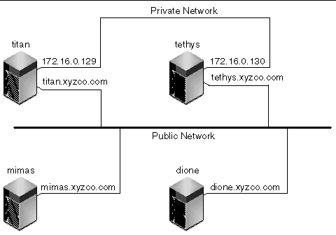

This example expands on FIGURE 2-1. CODE EXAMPLE 2-31 shows the hosts file for this configuration. FIGURE 2-2 shows the interfaces to these systems.
[ D ]
Systems titan and tethys share a private network connection with interfaces 172.16.0.129 and 172.16.0.130. To guarantee that titan and tethys always communicate over their private network connection, the system administrator has created identical copies of /etc/opt/SUNWsamfs/hosts.sharefs1.local on each system. CODE EXAMPLE 2-33 shows the information in these files.
Systems mimas and dione are not on the private network. To guarantee that they connect to titan and tethys through titan's and tethys' public interfaces, and never attempt to connect to titan's or tethys' unreachable private interfaces, the system administrator has created identical copies of /etc/opt/SUNWsamfs/hosts.sharefs1.local on mimas and dione. CODE EXAMPLE 2-34 shows the information in these files.
