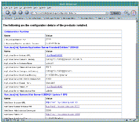

3. In your web browser, open the Configuration_Data.html file.
This file is created by the installer and stored in the default install directory. The report looks similar to FIGURE 14-1:
FIGURE 14-1 Configuration_Data.html Report
Configuration_Data.html report open in browser window showing data for two installed servers.
4. Find the entry labeled Application Server Admin URL and click on the link.
You are prompted for your username and password for Application Server.
5. Type the Application Server Admin User Id and Password and click OK.
The Application Server Admin Console displays in your browser.

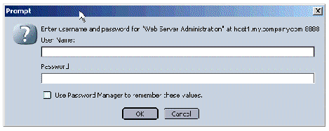

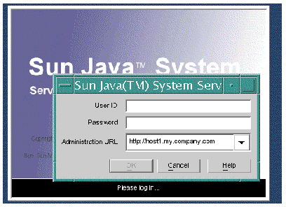

You are prompted for the username and password for Web Server Administration.
Web Server Admin login prompt with no values for User Name and Password.
4. Type the admin user ID and password selected during installation and click OK.
The Web Server Administration Console is displayed in your browser.

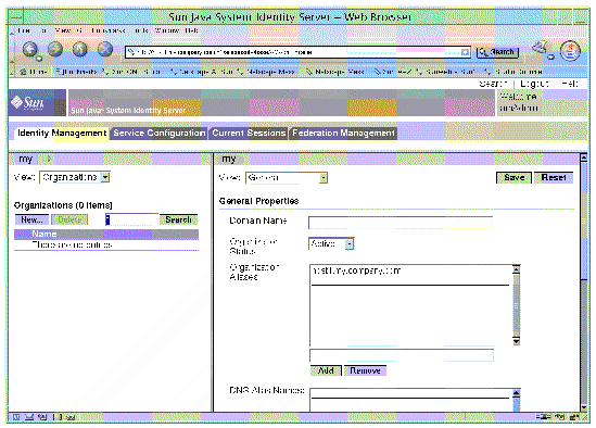

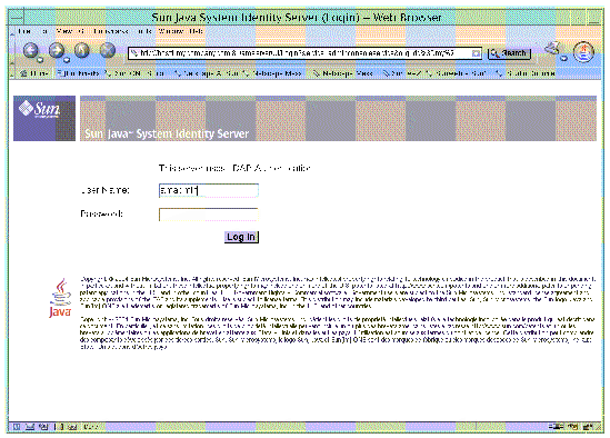

You see the Sun Java System Identity Server Login page.
Access Manager (formerly Identity Server) login prompt with value amadmin for User Name, no value for Password. Button is Log In.
3. Type your User Name (amadmin) and Password and click Log In.
The Access Manager admin console displays in your browser window.

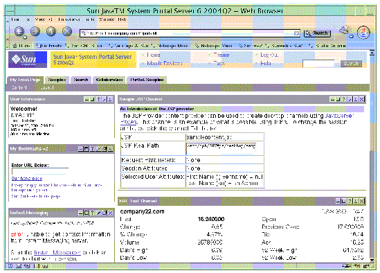

4. Open the Configuration_Data.html file and find the section for Sun Java System Portal Server 2004Q2.
In the name column find the row labeled Portal Server Console URL.
5. Click the link.
The Sun Java System Portal Server 2004Q2 sample desktop displays in your browser.
Sun Java System Portal Server desktop.[ D ]
Congratulations, your servers were installed and configured correctly. You are ready to begin development.

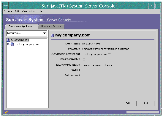

6. Start the Sun Java System Server Console.
# ./startconsole
The Java System Console login dialog appears.
Server Console login prompt with no value for User ID and Password. Buttons are OK, Cancel and Help.
7. Type your User ID and Password and click OK.
Your login to Sun Java System Server Console confirms successful installation.
Server Console showing Directory Server instance node.

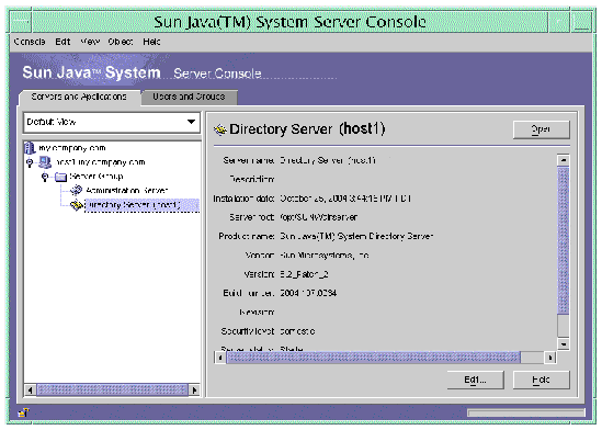

8. (Optional) On the Servers and Applications tab, expand your server host node, then expand the Server Group node.
You see an entry for the Administration Server and an entry for your server of form Directory Server (machinename).
Directory Server Console with Server Group Expanded. Tabs are Servers and Applications and Users and Groups.
9. Double-click on the Directory Server (host-name) node.
The Sun Java System Directory Server console for your server instance appears. From this console, you can start, stop, and restart your server instance.
Directory Server console for server instance.
